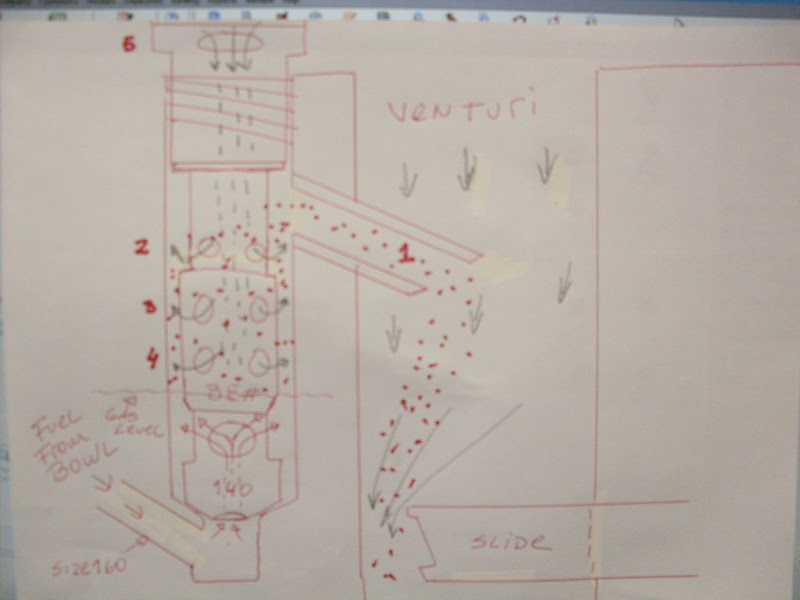

I highly recommend signing up over at Stella Speed forum - those guys go into great technical detail on jetting a/f mix etc.
As for the a/f (rear) screw - the Spaco have a different thread pitch to the Dellorto, so for a delly, 1.5 turns is the starting point, but the higher pitched spaco is 3 turns
There's a great write up on Stella Speed about air correctors - http://forums.stellaspeed.com/viewtopic.php?f=15&t=12769&p=134160&hilit=be3+be4+be5#p134160

For the non-technically minded - this is how your carb works and how various parts interact
