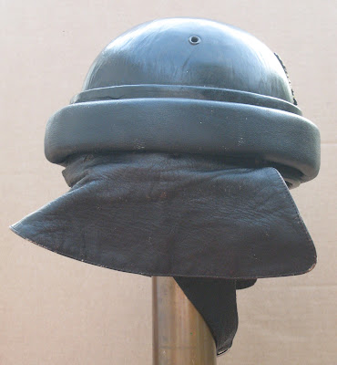

Re: Modern Helmet Design
TrafficJammer wrote:
It seems to me that helmet design has advanced very little since the turn of the 19th century. Where are the technical advances, the material improvements and design wizardry we have seen in other, every day items?
Really?
Helmet from turn of the 19th Century:
Early 20th Century helmet:
Mid 20th Century:
70s:
Turn of the 21st Century:
