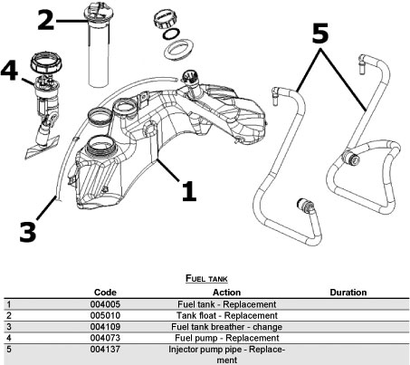

fuel pump multiplug
OK great. Saw two black hoses(?) coming out of top of tank. I didnt find any plug though. There is a connector on chassis on that side but I dont think thats what your talking about. Do I need to take out gas tank first to get to multiplug?
Sorry I am thick headed. Be patient with me and keep supporting the cause!
@harvey avatar
2016 Honda NC750XD, 2007 GTS (sold),
Posts: 3517
Location: Canada
@harvey avatar
Posts: 3517
Location: Canada
Here's the diagram for the fuel tank.
You can find the complete workshop manual on kindly hosted on Jimc's site:
http://manuals.wotmeworry.org.uk/Vespa/GTS250/

Re: fuel pump multiplug
Yes, the connector - that's it. It's not in a very accessible spot; it'll be tricky to get undone.
