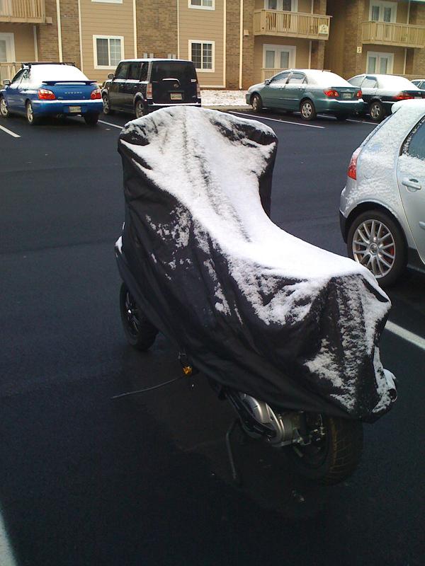

So I get out into the cold this morning to head off to school(the last day of course) and its reading 33 degrees on the scooter. I wipe off the seat, get on, and go to start it. It won't turn over. The lights/meters/blinkers/killswitch/tilt lock ALL WORK. I double, double check the kill switch, flipping it back and forth. The red light indicator works fine, and all the other gauges are running perfect. But when I go to press the start button...nada.
My guess is it iced over...but what I need to know is the following:
-What EXACTLY might cause this? What's 'freezing' up?
-Since I have no way of garaging it, would a regular motorcycle cover make enough difference?
-What can I do to keep it running after spending the night in the cold? I've heard rumors of fuel mixtures, but that seems a bit extreme. I DON'T have access to an external plug in, but are there any gadgets that might solve the issue?
Hope I can figure a way around this...I really don't want to have to go out in the middle of the night and start the scooter every few hours or try and figure out a way to walk it into the apt at night...
P.S. the pic is with its cover on, but its gone many cold nights without incident unwrapped...don't know why this time it didn't start...
This is what I NORMALLY wrap it in...but then again, its never had issues even unwrapped.

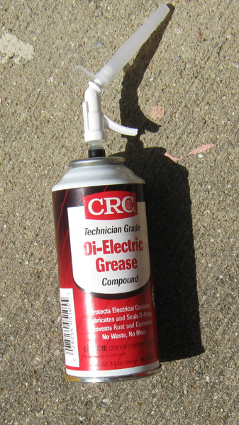

dielectric grease....where to purchase?
jimc wrote:
- then add dielectric grease!
Where do you purchase dielectric grease? Would a hardware store have it?

Re: dielectric grease....where to purchase?
proweddingphotos wrote:
Often just called 'silicone grease' - but be sure it makes clear on the description that it is a dielectric grease, there are different 'silicone greases' around, which is why I'm careful to use the 'dielectric' term.
Dow-Corning used to make one called MS4 - that is the sort of thing to find.
Vaseline (petroleum jelly) will do if nothing else is to hand, but is hugely temperature sensitive, so no use in very hot or very cold climes, and is to some extent water soluble.
Any auto parts store, look for Permatex Dielectric Tune-Up Grease Item# 22058.
If you have a Harbor Freight, they carry it.

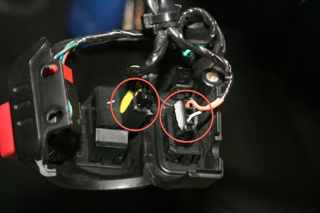

Where to get grease?
A while back, when we were getting soaked with rain and my turn signals started acting funny, I got some grease to do up a lot of my connectors to switches. I went to an auto parts store, asked them to point me at the dielectric grease, and he handed me just a couple of little squeeze packages. I used less than one of those packages. I thought about taking pics but was running out of daylight when I was doing this.
For my 400 handlebars and switches, I had to remove the handlebar cover; 2 screws per side from underneath, brake reservoir cover, and the silver cover in the middle. I think that was it. Carefully pry apart the two halves. Then take out the switches after undoing the wire connections. Grease them up, I used a tiny screwdriver to push the grease in and make sure the connectors were completely covered. Clean up any smears on the outside of the switches and put it all back together. Then I did the hidden fuse next to the battery.
I am sure that there are other connectors that need doing that I haven't done yet. Speed sensor on the front wheels maybe.
As far as the battery itself, check out the well written wiki What you need to know about batteries.
Cold does effect batteries, questionable batteries will always die on you on the coldest winter days. Quick fixes could be to warm up the battery in any variety of ways; take it off and put it inside for a bit, hit it with the hairdryer/electric blanket. I have one of those stainless steel Klean Kanteen's that I would fill with hot water/coffee and place that next to the battery to warm it up. Just some tips that might get you cranked up when you gotta go. Nerd emoticon
Hope it helps, and correct me if I am wrong on any of that.

Thx Glow Guy...my turn signals too act up during the rain sometimes. Since you added the grease, has that issue gone away or have any new ones come up?
I had to replace my turn signal switch. The new one still acts weird occasionally, but not due to rain just sometimes when I signal right hand turns. I think there might be some quality control issues with Piaggio switches. I also had one of my brake switches act up. The mechanic at the shop fixed that for me while I was getting some new front tires installed. But neither of these issues were due to corrosion of the connectors. Obviously the hidden fuse that leads to the starter is more of concern due to the higher amps going through it as the Great Curmudgeonly One has pointed out.
Greasing the connections is an easy job that almost everyone should be able to do. I imagine it is easier than trying to remove plastic panels, which I haven't done yet.

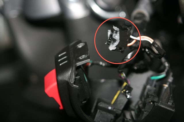

Pictures? You want Pictures?
luthorhuss wrote:
Hey sctsct,
As soon as I can, I'm gonna get some dielectric grease and fumble my way through redoing them all. Several have done it, but of course, they always tell us after the fact and with no pictures at all. I'll try and get plenty up.
So you want pictures do you? Here are a couple I took when I put dielectric grease around connectors inside the handle bar covers. The grease is easily obtained at any auto parts stores. I only got a few small packets, and barely used one on the handle bar switches.
Open connector with dielectric grease around the outside.
Some pictures of closed connectors with the grease oozing out.

Thanks, Kevin!!

Re: Pictures? You want Pictures?
There should be some grease squidged around the wires and into the back of the connectors as well - that is where any corrosion will start on any wire that has a few volts on it for any length of time.
good point!
