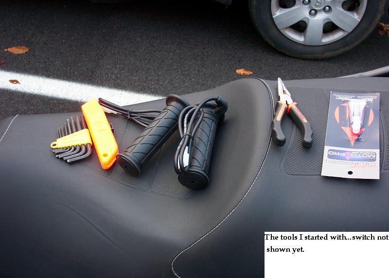

So, while there, they had a good set of Heated Grips with a rotary dial heat setting for off, low-high with variations in between. They were on sell for $40 so I picked them up, having read the good reviews on effectiveness of heated grips lately. Considering these are 1/3-1/4 the price of heated gloves, don't need to be taken on and off every time I stop, I figured I'd give them a try.
So far, I've installed the grips. I'm planning on running them from the headlight relay so that they don't accidentally get left on. I got the 7/8 size types, but unlike some other brands..(these are TRACKSIDE), I found that the throttle side was a bit too tight. The left side went on without a snag, but the throttle side drove me furious before I finally shaved off the 'lip' of the throttle plastic to allow for it to go on. It wouldn't go all the way, so I had to shave off the guard with the knife and simply cutting gently around the handlebar, following the groove in the design. But my frustration may be your treasure, because what started off as an issue, actually came out, in my opinion, as a better looking heated grip. It appears more sleek to me, and I don't have the guard making it look like an ATV.
I plan on running the wires and setting up the switch along with some more pics tomorrow. Feel free to ask any questions. Here are the basic steps I took thus far:

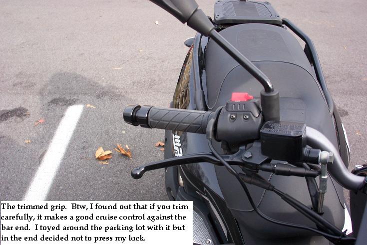

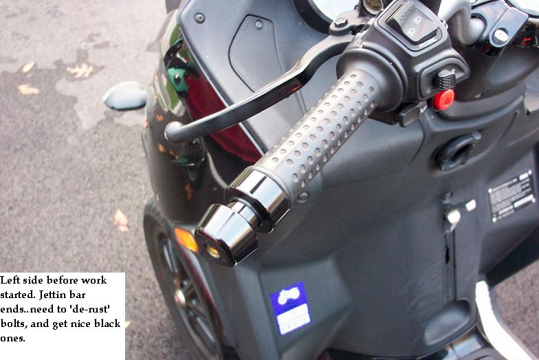

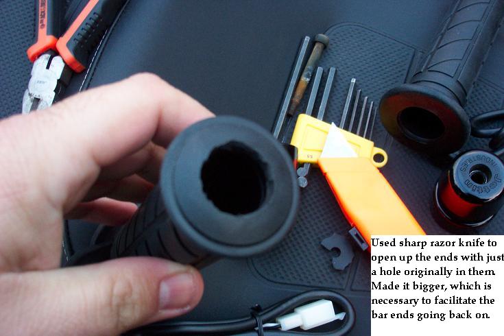

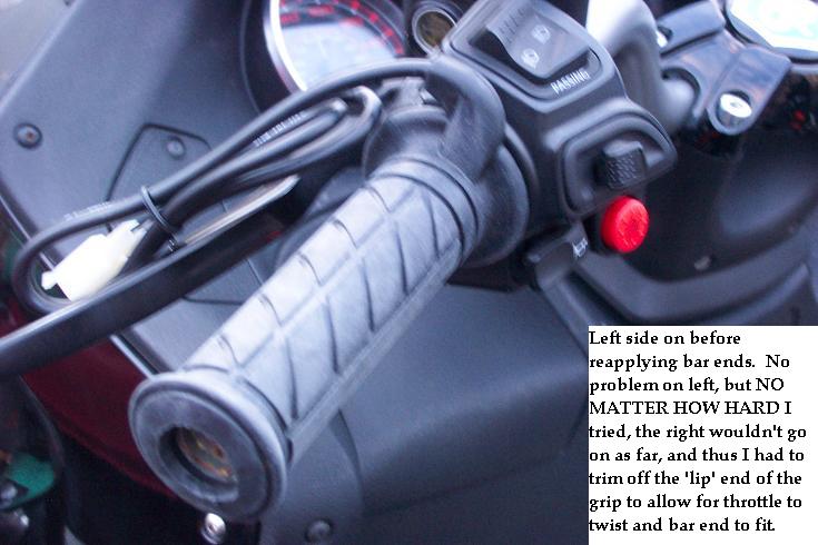

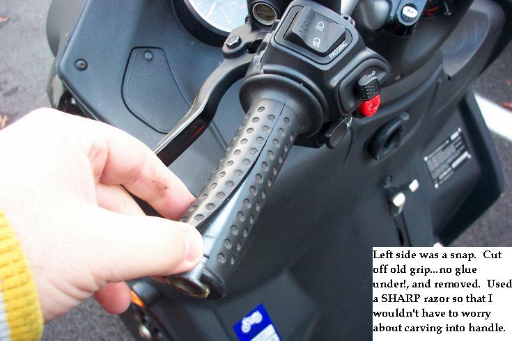

1. Removed bar end weights. Carefully cut off old grips. Be careful to not cut into plastic on throttle side. Cut out hole in end of grips.

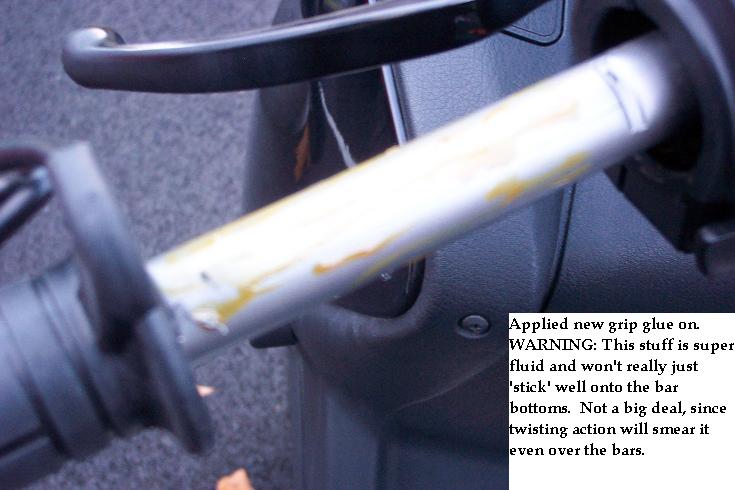

2. Applied grip glue to top of grip, spread evenly by twisting on new grips as far in as you can and aligning wiring so that it doesn't interfere with brakes. MAKE SURE BIG GRIP GOES ON THROTTLE SIDE.

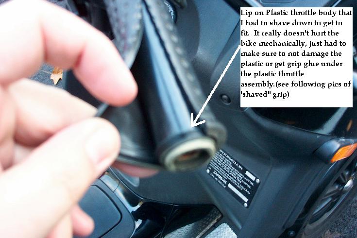

3. Make sure that when you put on throttle side, that you don't get any glue between plastic and handlebars.

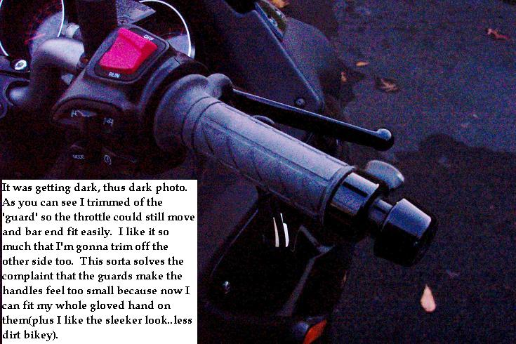

4. Used razor knife and carefully trimmed off 'end' guards.
5. Refitted bar end weights.

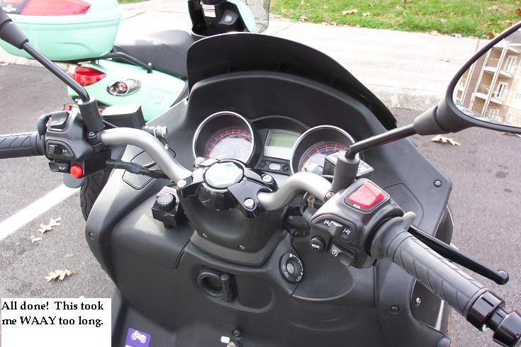

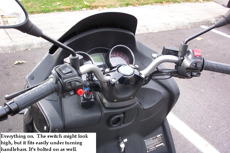

Finished!
Hey Bravo...the Balaclava is the trick. At red lights, I don't get hardly any fogging, and it keeps the nose/mouth area really dry and warm. Honestly, it may be the best 35$ I've spent on the bike. I guess if there's any issue it's horrible helmet hair . I can solve that today with a nice haircut.
So anyways...I finished putting on the grip heaters. I'll give my honest review on everything:
Installation:
Well, in some ways this was easier, in some ways much much harder.

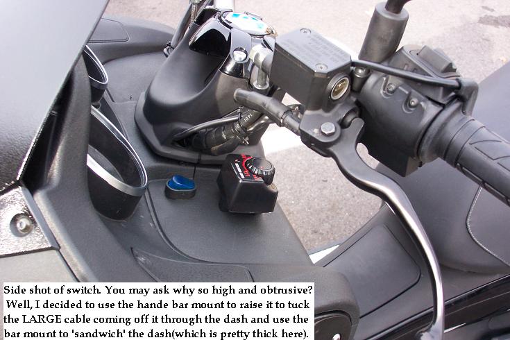

While the kit came with a nice switch and handlebar mounts, the mount was too small to mount on the beefy bars of the mp3. So this left me with a switch that was gonna be adhesive stripped to the dash. I decided that wouldn't work too well, constantly twisting and adjusting it, so I had to mod it to bolt to the dash, using the bar mount as a "sandwich". This allowed me to create a large size hole to poke all the wiring through. It sits a tad high, but still has enough clearance. At least you can't see the humongo wire that came out of it. It's not my best work, but it'll get me through winter and then I can lop the whole dash off and start over.

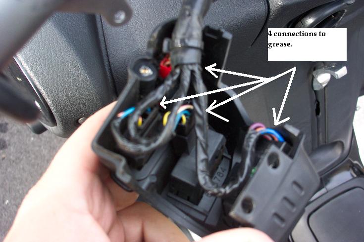

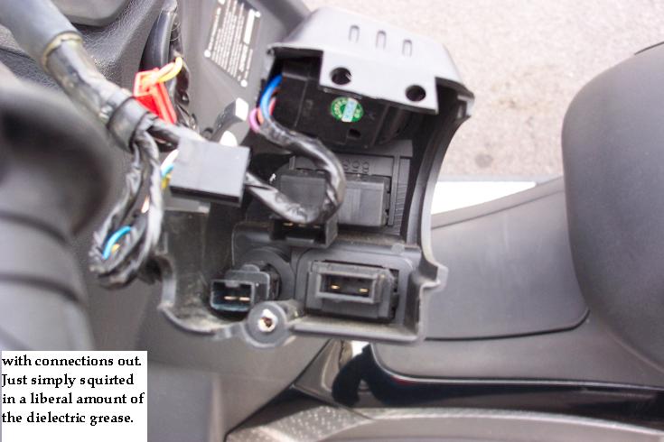

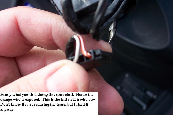

While there, moving cables, decided to grease all the connections too. Interestingly enough, found a splayed wire a bit, and also a dead spider. Maybe that explains the killswitch problems.

The cable coming from the throttle grip looks like the brake lever might interfere with it. I have mine rotated back a bit further in the throttle off position.
Another great turorial as you continue to set a high standard for us.
Yeah, the last pics are kinda confusing. There's the one pic with it the cable hanging down by the throttle. This is before the wiring was done. If you look at the pic of the left side and also the very last pic, you can see how I tucked them up by the brake reservoir. I was always watching for the throttle movement, thus the snipping, and tucking. It moves like there's no cable there, so it came out well.

The 'glans' at the end of the throttle grip always has to be cut off with a sharp craft knife.
