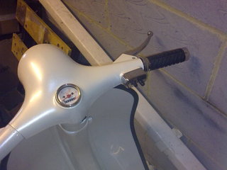

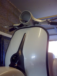

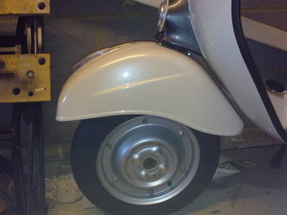

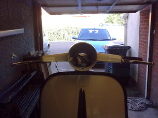

[img][/img]
v90
Posts: 9
Location: northampton U.K
v90
Posts: 9
almost there

v90-dream wrote:
thanks guys youv been a great help unfortunatly i think the falc option is a bit out of my price range unless i cancel christmas and i dont think the wife and kids would be to pleased about that Crying or Very sad emoticon Crying or Very sad emoticon
I was totally kidding about the falc kit. It is very pricey and when it comes down to it less reliable than the regular kits. Also they are most likely too intense for the street. Malossi or Polini will do just fine.
Nice work so far. Looks clean.
