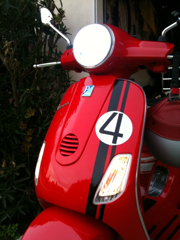

finally got my LED turn signals that go from white to amber when flashing... funny thing is that like the others that had to ground their lights for it to work right i have not had that problem

ok here is everything that i have "light" wise on my bike ....
first i upgraded the headlight to an HID Hi/Lo from v-leds.com .... then i got the euro turn signal mod, (tried so hard to find running lights the color of my HID but could not to low of wattage no matter what color i got ).... then i got the LED's white/amber , plug and play nothing else.. just straight up popped the bulbs in and have 6500K running lights to match my head light and now a better way of people knowing that i am turning by amber colored turn signals

here are some better pix

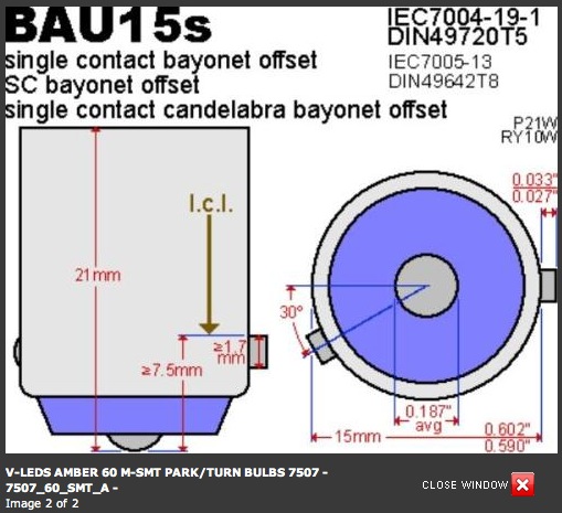

Does your bulbs have the pins at the base off set a little instead of opposite of each other.
Mine are like that, so finding LED bulbs are a beeyotch.

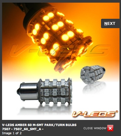

snapshot05 wrote:
Vic, the scoots looking good my brotha.
These should work fine :
http://www.v-leds.com/Exterior-LED/Turn-Signal-LED/Amber-LED/V-LEDS-AMBER-60-M-SMT-p5746473.html
@snapshot05 avatar
WHOoligan
Posts: 6695
WHOoligan
@snapshot05 avatar
Posts: 6695
Thanks my brotha, those are them.
