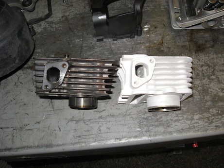

It's done!
Yesterday we got the new kit installed. The results are incredible. Side by side with my kitted LX, the S50 has twice the power off the line. Of course, that is to be expected since it has 4 valves. Also remember you don't need to purchase the power cam like you do the LX.
Before I continue, I would like to mention that Vespa of Orlando AND Motorsport Scooters have been outstanding. This has not been the "ordeal" it could have been by any means. This has been a good experience.
At the beginning of this thread I mentioned I didn't want to be the first one to kit an S50, but to my knowledge and the responses on this forum it's possible we are, at least in Central Florida anyway.
I was very impressed by Max's (Motorsport Scooters) public response on this thread that there may have been confusion about how the first kit I purchased was listed on his website. He offered to take back the part I purchased that didn't work in exchange for the correct part with no recourse. Also, Vespa of Orlando (Dave and Adam) after putting in a full afternoon with my wife's bike and not being able to complete the job because of the non-fitting part didn't charge me for the labor that day.
I mention this because I know neither of them had to go the extra mile for me. But this reassures in me that there are people out there that still know how to take care of their customers. Usually, there's a big fight first. I hate that. They didn't hesitate to take care of us. Thanks very much!
Now, we have to find out how to adjust or disable the rev limiter on the S50. That will be for another post

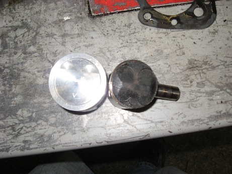

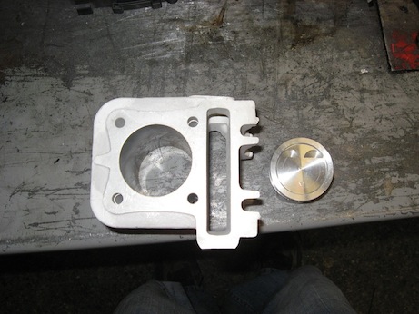

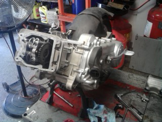

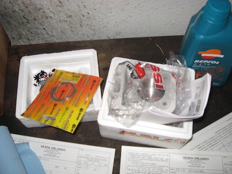

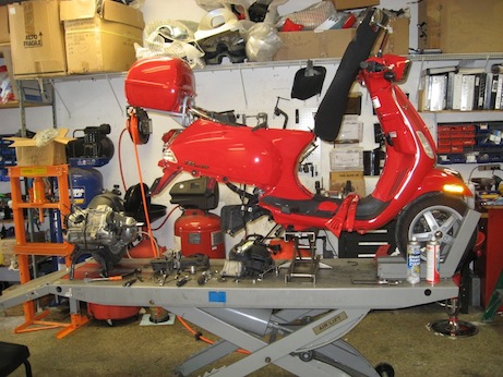

Below are some pics: (Thanks Dave for taking them!)
Malossi kit for the 4 valve S50 go to Motorsport Scooters to find it: http://www.scooterwest.com/items/?_pageCCS=t#page=/item_details/Malossi-Cylinder-Kit-78-8cc-4-Stroke-(w--Four-Valves)/3609
Notice the grooves cut out for the valves
Side by side the new 78cc piston and the 49cc
Side by side cylinders
On the lift during surgery

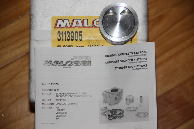

That is outstanding! What is the malossi part number for the kit?
@munsongeek avatar
2010 Red GTS 300 Super, 2012 Titanium GTS 300 Super
Posts: 16
Location: Orlando
@munsongeek avatar
Posts: 16
Location: Orlando
Part number
Part number is M3113905
Here's the link (great price too): http://www.scooterwest.com/items/?_pageCCS=t#page=/item_details/Malossi-Cylinder-Kit-78-8cc-4-Stroke-(w--Four-Valves)/3609
(copy and paste the whole link)

Just got the kit.
Mechanic is schedule to put it in tomorrow.
But if I look at the head, I only see 2 grooves... shouldn't it have 4 because of the 4 valves ?
The booklet also shows the wrong part number.
@lilscoot avatar
Vespa 2009 S50
Posts: 120
Location: canada
@lilscoot avatar
Vespa 2009 S50
Posts: 120
Location: canada
I think I got it, the 2 valve kit has no grooves for but the 4 valves kit has 2 grooves for the valves.

Yep. The 4-valve setup has two of the valves horizontal with the piston and two at an angle. There isn't much room on that head to cram everything in.
I am glad these are available now - I looked for these when I had my S50 and they weren't ready yet.

lilscoot wrote:
Just got the kit.
You got the right kit ! Only the booklet is not ok but the instruction to install are the same. You also get it @
http://www.malossistore.be/Prodotto.aspx?type=M&MM=MO/VES504T&C=3113905
Don't worry and read that mail you'll be happy and there a lots of infos that you need to upgrade completly your Vespa. Waiting for news about you.
best Regards.
here's the post that i just send to Max at scooter west. :
Hi Max,
2 weeks ago I bought from you guys the 80cc Malossi 3119035 for my vespa S50 4T-4V 2010.
I just want to let you my feedback about how I'm happy.
Now I'm riding my bike @ 80 Km/h (48MpH) With tork !
It's fast, powerfull and still economic.
But you have to tell to your customers 2 things if the're buying the kit. :
1 - Jet the carburator to 76-78 (original is @ 72 kheinin)
2 - Remove the spacer on the cluth and make a little hole (diammer of 5 in the small place of the CDI to void the RPM limiter.
FYI : The CDI is in front of the bike located just beside the horn under the piaggio sign)
You'll notice a huge gain of speed and appreiciate acceleration.
So that's it, I'm really happy, event if the operation cost almost 750 $ including labor cost !
See you later and thanks again Max.

OMG just got back from the shop.
Kit installed! What a difference.
No up jet/ no mods to cdi
Scoot can get up to about 75-80km/h, need to verify with GPS.
I now have power all the way up to 70 km/h.
Before I would have power until about 35-40 km/h and then it would just climb to 70 km/h.
Acceleration has improved by a factor of 2. I can easily out accelerate cars and pass them up at will up until 70km/h. (car that are driving at regular speed and accelerating normal )
Definitively worth upgrading unless you can get a 150cc without any major pain getting license,insurance....blah blah blah.
Two thing things :
1) the bike vibrates a lot more (more power)
2) when I turn on the gas at full I have slight hesitation that last a fraction of a second (carb?)
I'm extremely happy with this upgrade it's even more perfect for the city, the GTV300 project is now on the back burner
