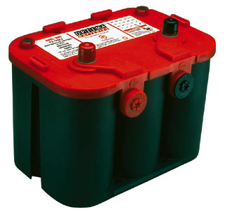

Good of you to post your review. I see alot of people with high hopes for these gloves. But Lithium ion batteries lose their capacity in colder temperatures, and as you discovered...don't really work well outside of the store. Ever notice your digital camera crap out in the cold too? Same thing. It doesn't hurt the battery...but it doesn't work when you need it too either.
The best performing battery technology for low temperture discharge is still the sealed lead acid battery. Unfortunately, you need a rather large & heavy one to get any longevity out of it, because deep discharge kills them quick.
