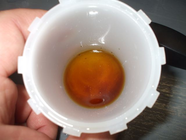

Squeal resolved!
I am delighted, nee 'giddy" to report that my brake squeal has been resolved.
My hunch regarding the different types of pads was not the solution, however I'm well versed at the brake-pad change technique now. Always a silver lining
I attempted the overnight brake-lever pressure technique which did not work, although the lever had a better, crisper "feel" to it afterwards, then before.

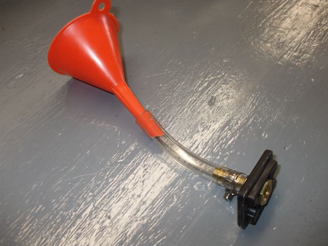

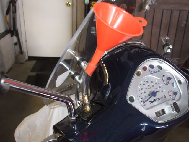

I purchased a Lisle Brake Bleeder model 19200 at Sears' tool department (Fantasyland as I like to call it...) for just $6.99, and fully bled the rear brake circuit with it. The old fluid was a greenish yellow, and thicker in consistency than the new, and we bled it until the fresh DOT 4 material appeared in the little bottle. As was mentioned, I did have to add to the reservoir numerous times during the process.
Did this all in a few minutes, with the rear wheel on, and the brake works and feels better than it has in thousands of miles, and is quiet, squeal free and effective even at low speeds and light lever pressure.
Just out of preventative principle alone, I will likely flush the fluid from all of my bikes brake systems from time to time, as I've seen the difference between old and new brake fluid now. I believe it's a scheduled maintenance item anyway.
Anyway, it's easier to do than I anticipated, the hardest part was protecting from any fluid spills or drips, and disposing of the spent fluid...if you are suffering with screachy brakes, this may be the cure for you.

Good work Matt, but why does the brake fluid cause the squealing? My rear brake only started to squeal since I had new pads put on it after the original set was soaked with oil. The bike only has 2900 kms on it at the moment so I cannot imagine that it is a problem with the brake fluid, but it seems to have solved your brake problem.
Posts: 45143
Posts: 45143
My Fuoco front brakes have started to 'squeal' a tiny bit over the cold weather - and it is noticable that the first front brake lever squeeze of the day goes in a bit further than normal (just the once though).
Brake fluid is 18 months old (last steering bearing change), though the pads have been changed since IIRC. Fluid level fine.
I absolutely bet new fluid *and a clean of the retaining pins* would cure - and a smear of new copper grease wouldn't hurt.

great job. isn't it amazing how that old fluid looked. You should only need to do this every other year. Now think about that 4 wheeler your driving around.....hmmm.
That's not to say your brakes don' t have air in the line...that's the primary reason to bleed them, and indeed I had air in my old fluid. The air bubbles make it difficult to apply full and proper pressure and that can contribute to squealing. I don't believe air is related to the age or mileage of the scooter. Just one of those thing that can happen.
OAD-It certainly was enlightening and I have a new outlook regarding brake fluid as a regular maintenance item

The Lisle Brake bleeder contains all the fluid at the caliper end of things clean as a whistle....the bigger concern for me was spilling some fluid up top on the painted plasticware.

After having my eyes opened to the benefits of routine brake fluid flush and replenishment, I attacked the front brake on my formerly troublesome GTS, and both front and rear brakes on Patty's GT200L.
We have 5 bikes in our collection that use this same reservoir, so I procured a cap from a wrecked scooter, and monkeyed this device up to help ease and speed fluid service in the future, and most importantly to minimize the chance of a brake fluid spill.
Feels good to know I have fresh, clean brake fluid in our Vespas....if the rain around here ever lets up I may even get out and take a ride!

This is the fluid out of Patty's GT200L. This bike JUST hit 10K, is garaged daily, and has only seen rain on one occasion. Fresh brake fluid is the same color as tap water.
Looks like something I saw in High School once but it's not... it's a VERY specialized tool!
Fluid containment device fulfilling it's mission statement
