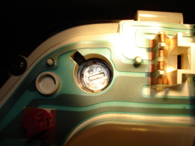

As promised in prior post...I circled back after an incompleted attempt to replace a dead clock battery in my GT200.
(While you're doing this you may want to consider replacing your head light bulb)
Below are the step-by-step instructions on how to get this done. If you're considering this as one of your "Winter Projects" this might help.
Your battery doesn't have to be "dead" to consider a replacement. If your clock is not keeping accurate time...perhaps it's a time to replace the battery. The effective life of the clock battery is 2 - 3 years.
Battery part number: Renata 386 / Duracell D386 / Energizer 386 / Maxcell SR43W or you can also order via Scooterwest (1.55 V). Check the battery that is being replaced (upon removal) as well as the replacement battery (prior to install).
Note: There is a good step-by-step narrative by quattrovalvole (October 5, 2008).
Clock battery. Anyone replaced it yet??highlight=clock+battery+part+number
However the entire process (narrative and pics) is captured below in three parts:

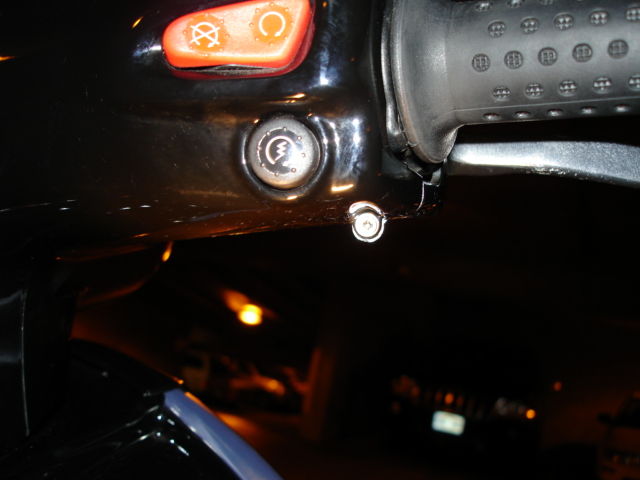

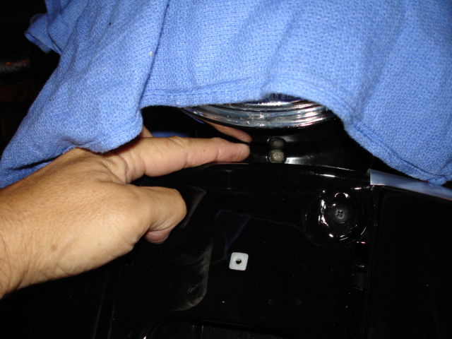

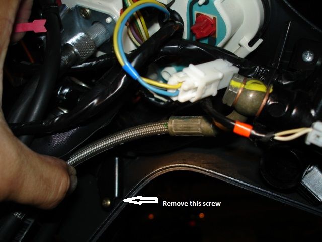

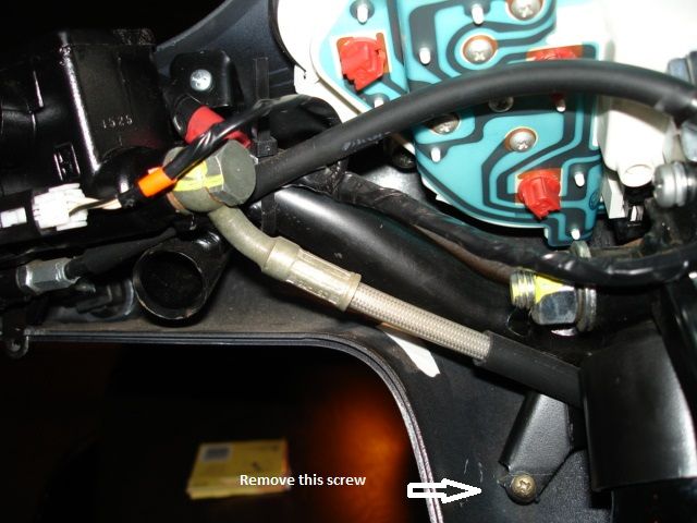

1. Headset removal:
Follow link below until you get to the last pic.
GT/GTS: Headset Cover Removal
You'll also see the same pic (last pic) below with arrows that indicate the four (4) screws that need to be removed. Be careful removing these screws...place a towel over any open cavity and you may want to use a magnetic screw driver or screwdriver with retaining clip. You're not done yet.
You will also need to: (1) unscrew the speedometer cable nut then (2) unscrew the bolt that holds the headset cover (with instrument panel) to the steering column and (3) cut to cable tie that holds the electric wire bundle to the steering column. Once this is done you can pop the headset cover off and then unplug the two electric connectors to the instrument panel as well as the connectors on the left and right side of headset cover. You should now have the headset cover (with instrument panel) removed and place in on a worktable to replace the battery. I recommend having it on a table...you want a stable platform to complete the battery replacement.

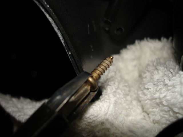

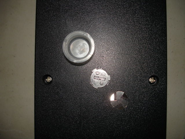

2. Battery replacement:
Place the headset cover on a stable surface (recommend you lay down a towel and brace the headset). You may want to secure some fine tools (forceps, picks and magnifier / loops).
An inverted cup / cap covering the battery compartment...remove. Next, using a slotted screwdriver remove the plastic lock washer (push down lightly and turn counterclockwise). Next, gentle pick up and remove the spring washer. There's the battery...which is friction fit in place by two tabs...carefully remove the battery...don't damage the tabs.
Once to battery is removed...check out the charge of the "bad" battery...if the charge is good the problem could be the clock itself. Replace battery (clean off contact surface before install) and washers and cap.
Turn it over and it should be working!
3. Setting the clock:
Follow the instructions in your Owner's Manual or refer to the link below:
2005 GT200 DASH CLOCK?highlight=clock+battery+life
Make sure you got the two dots ":" in between the hour and second digits blinking or you haven't set the clock and it won't "run".
Reassemble and you're done!

The clocks on the GTS and GTV models run off of the scooter battery and I suspect that the 300 does the same. The 200 was the odd duck that had a separate battery for the clock.

I'm positive that there is not a separate battery for the clock on the GTS and GTV. If you disconnect the battery on those models, the clock will not display. Same for the BV500. So, it looks like the LX150 (and maybe other 150cc models) and the GT200 have the separate battery. I've also had the speedometer assembly apart on a GTS to look at installing a daylight sensor for a headlight modulator (decided not to put it in that area) and there is definitely NOT a clock battery.
If your clock is not working on a GTS, then it's some other problem. You might take it apart and see if the multi-pin electrical connector has come loose. It may be as simple as that.

I will post this just one more time in this thread: The GTS, GTV and BV500 clocks run off of the scooter battery. I know this for a fact (not a guess) because I own all three models and have verified this by performing a simple test that tells me this is so. (battery disconnect test) I have also been inside the speedometer/clock area of all three of these models. I can't speak for any other models but others have verified that the LX150 and the GT200 have an independent, clock battery that requires you to perform the procedure that the OP posted with excellent instructions.
If you want to know about your particular scooter,(other than a GTS, GTV or BV500) all you have to do is disconnect the negative terminal of the scooter battery for a minute or so and see if your clock has to be reset to the correct time due to the battery being disconnected.

Pics reattached
Per request to reattach pics.
This is where the battery is!  Notice cup cap, this is removed first ...then you'll see the plastic locking washer.
Plastic locking washer.
The spring loaded washer.
There's the battery!
Everything removed.
Everything removed.
The cup, the plastic locking washer, spring loaded washer.
It works!
It works!

I believe these (see attached) are the pics. It is specific to the removal of the instrument panel from the headset housing to access the battery cup.
Note:
1. I would recommend that everyone take caution in removing the screw that holds the front of the headset (under the headlamp). Place a towel underneath and use a retaining type of screw driver. Having the screw fall into the open crevice would require removing the glove box panel.
2. The general removal of the headset is covered under Wiki article that was put together by MBergsma (?).
Remove front handle bar / headset cover screw
Retaining screw driver
Remove retaining screw beneath ignition button and likewise on the opposite end below horn button.
Left side screw removal
Right side screw removal
