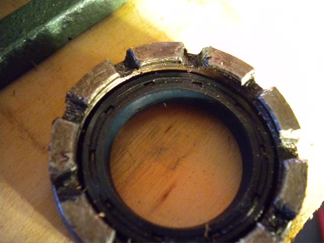

Got it! With no damage to either the engine casings or myself. Heat and more heat, and patience, did the trick. I also bolted the casing to a platform I built close to the floor, which allowed me to get a bit more leverage than when I was up on the workbench.
The seal looks okay, and the retaining ring less so, which I think is clear from the picture below.
Thanks for the suggestions and encouragement.
