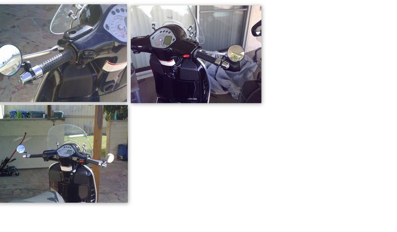

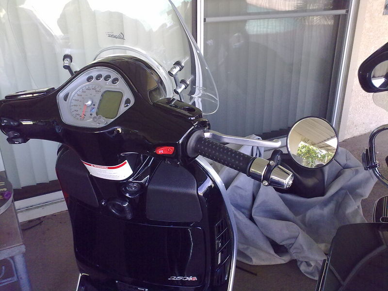

I got these rizomas from pj's parts. They required new bar ends since the stock ones are conical. They were pricey, but I have been very happy with them.

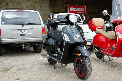

Yep, thats my LX150 above. They look fantastic but you can't see anything.

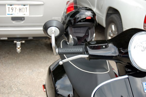

The mirrors on the white Vespa:
... were made by the owner. I asked him about them and he mentioned that he had turned them on a metal lathe from blocks of aluminum.
They are gorgeous! Too bad they are one offs. i suggested he could make some money selling them.

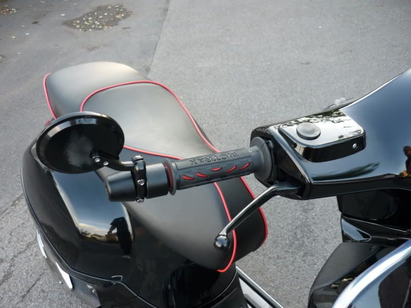

That's my GT with the stripes and Motrax mirrors. I used the dealer-installed chrome weights and used a longer stainless version of the bar-end weight mounting bolts - $0.70 at a local fastener shop. The mirrors are pinched between the weights and the handlebars.
Also, I originally wanted to go with the plastic plug in the brake reservoir covers. Ended up buying an extra set of GTS covers, filling, glassing and painting them to match.
