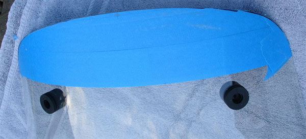

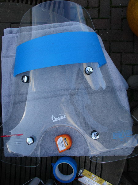

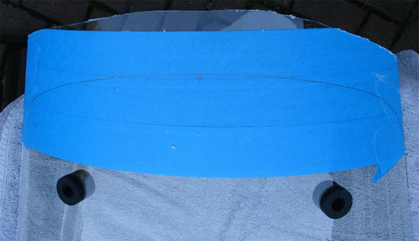

2. Placed blue painters tape in a swatch about 12" wide over the place where I estimated the cut would be made. (The tape will prevent the foot of the jigsaw from scratching the lexan, and will also produce a cleaner cut).
3. I made a paper template by tracing the top contour of the windshield onto construction paper. Then marking a spot on the tape about 4.5" from the top, traced the contour onto the blue tape so as to have a line to follow while making the cut.
4. I carefully cut the new contour using a fine-tooth blade on my jigsaw (24 teeth per inch), being very careful not to hurry and to let the saw be the one who did the work.

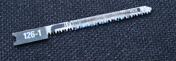

** Here I made a few adjustments to the above points. Firstly, in relation to point 3, rather than tracing the outline I came up with the idea of making a test cut about an inch above my intended cut. This would allow me to test the blade I was using, see the quality of the cut, get used to cutting the Perspex and give me a real template to use to mark the real edge for my cut. I had bought a special Perspex blade for my jig saw and it cut OK on the test cut but half way through the dust from the cut was falling into the cut line and fusing against the heat on the blade causing the Perspex to stick itself back together (*you could spray the blade with water as you cut to solve this). The cut was thus a bit of a sticky mess. I then changed to a general but very sharp blade (as photographed). This cut almost like it was through butter and gave a really smooth finish (see the two pictures below). With the test strip I could draw a cut line with a bit of moving the strip as the screen is wider here than it is at the top. I then tried drawing a line with my small sports screen and this had a better profile to it for the cut anyway.**

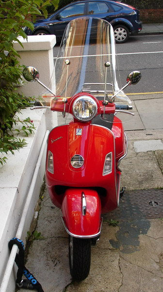

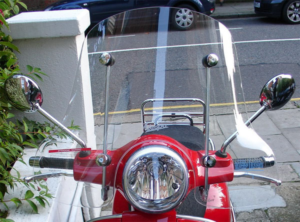

Part 1: The ugly full size screen (minus the edging)
Part 2: Taped and ready to cut
Part 3: After the test cut (rough edge, wrong blade)

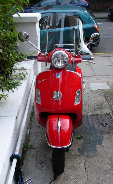

Part 7: Finished, looks much more in proportion now!
