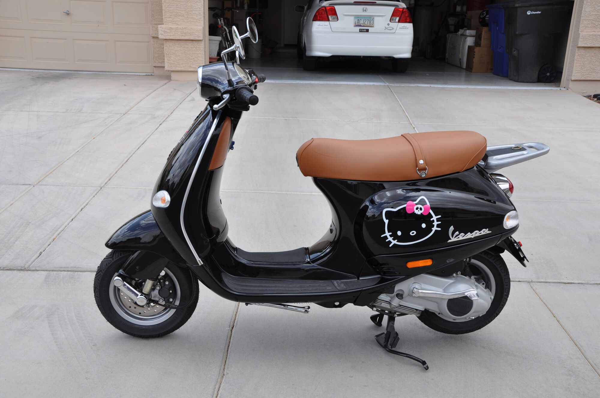

I bought this ET4 for my wife back last fall. It was abused a bit by the previous owner but since it is my wife's first scooter I figured we'd let her add some more dings to it before dressing it up. So it's been about 6 months now (we can ride year round here) and no new dents. Figured it's time to get started on the make-over.
Since this is the first Vespa I've torn down, I'll be shooting hundreds (literally) of photos so I can refer back to them when reassembly time comes.
Supposed to be sunny and warm tomorrow. I'll go riding in the morning and take this up again late in the day.

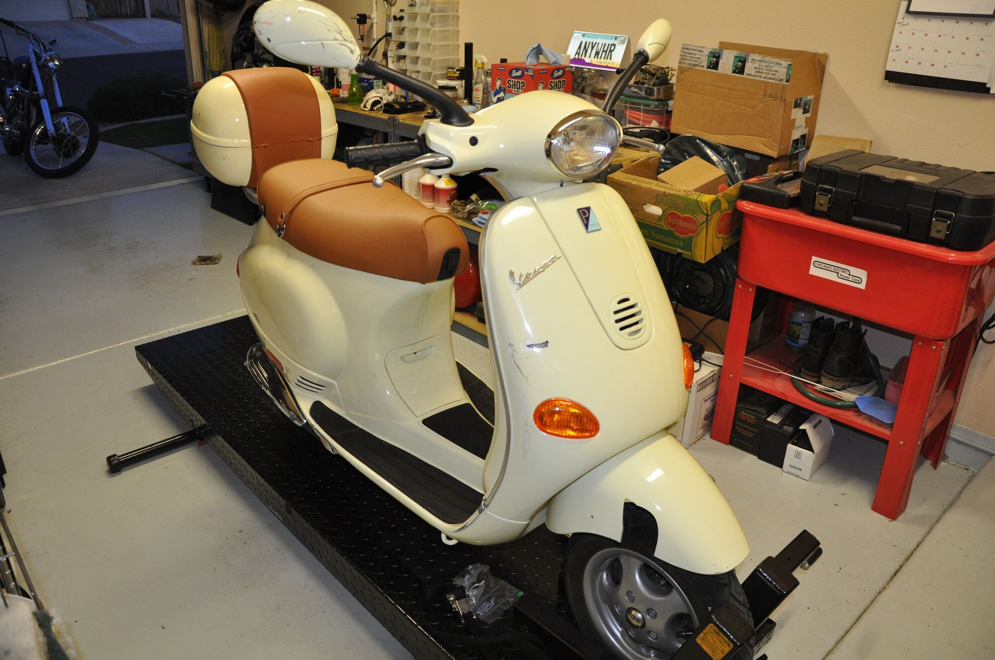

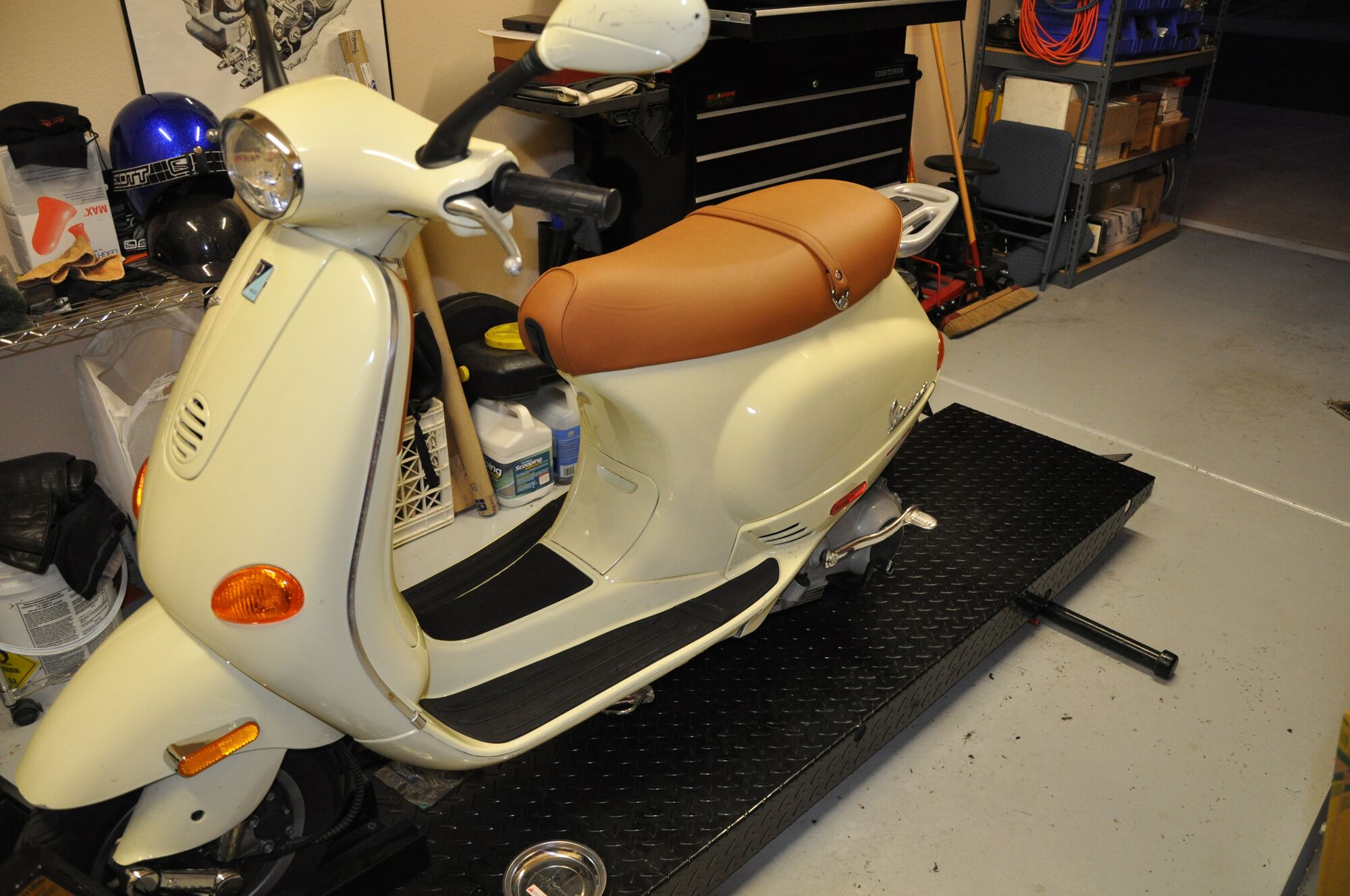

Starting with a stock ET4 w/ top case...
Just barely getting started.  Top case removed.  I think it looks more sporty this way but my wife loves the extra storage.

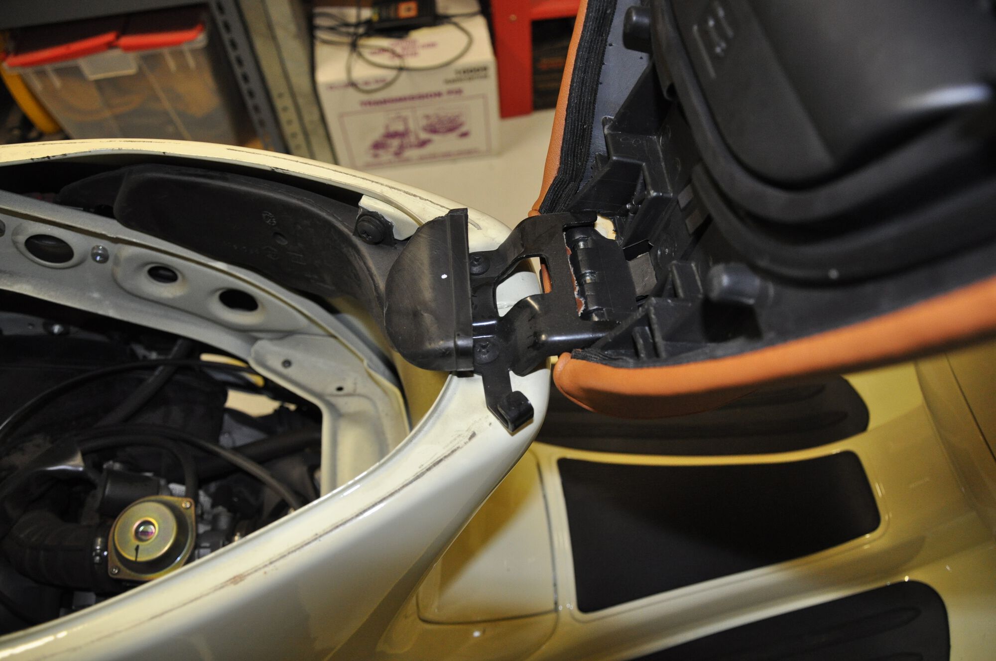

Simple enough to remove the seat, just two screws...

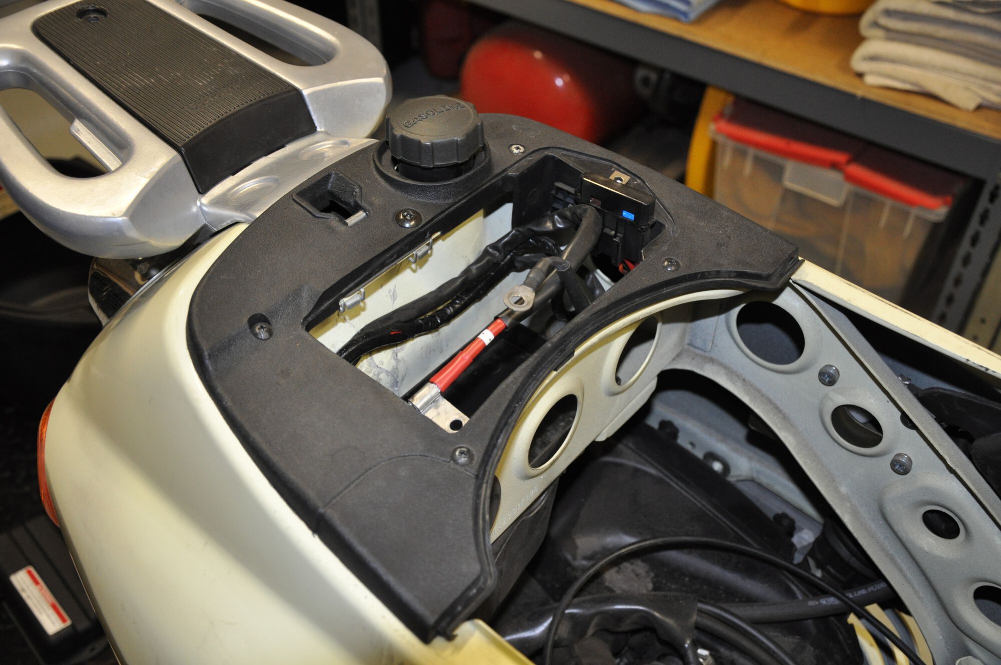

Took the battery out and returned it to the tender to keep if fresh.  I learned a long time ago not to work on a vehicle with the battery hooked up.  Especially a vehicle you are not familiar with.

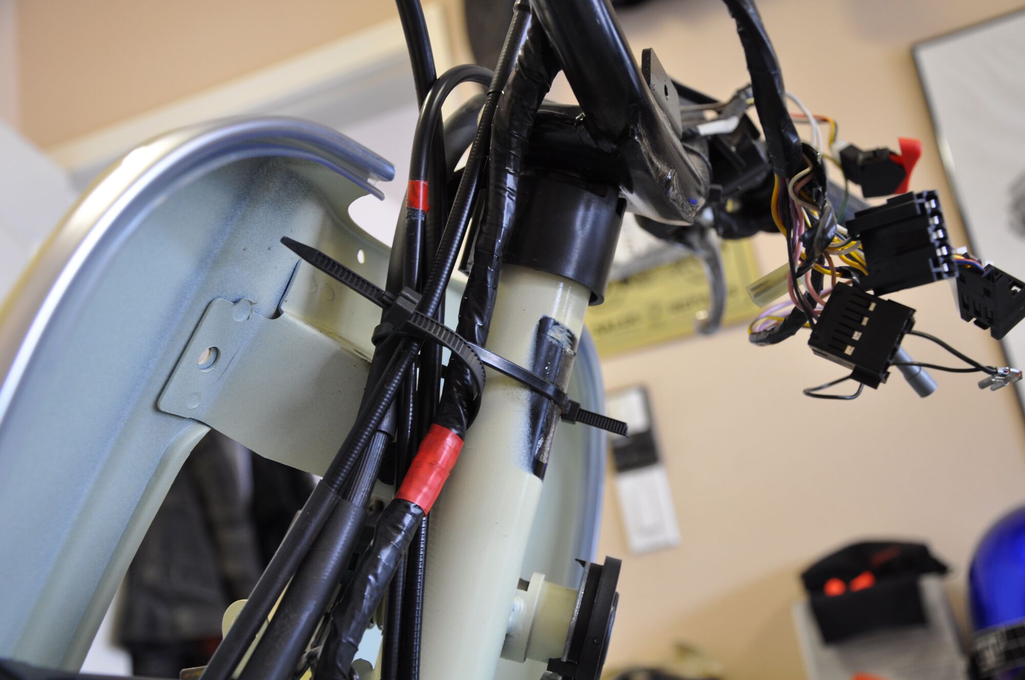

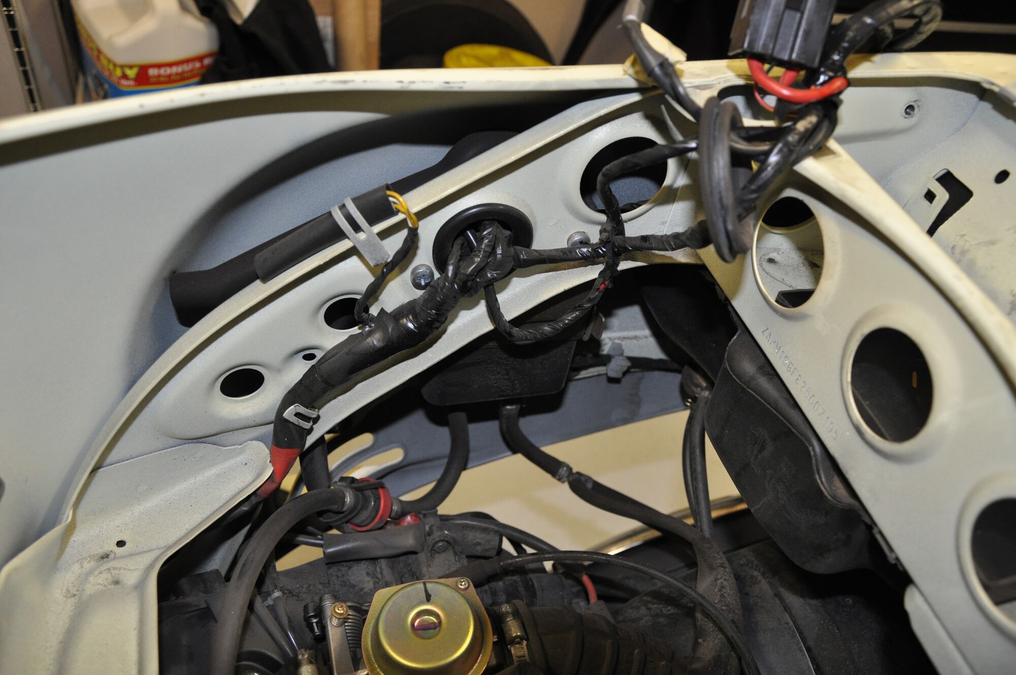

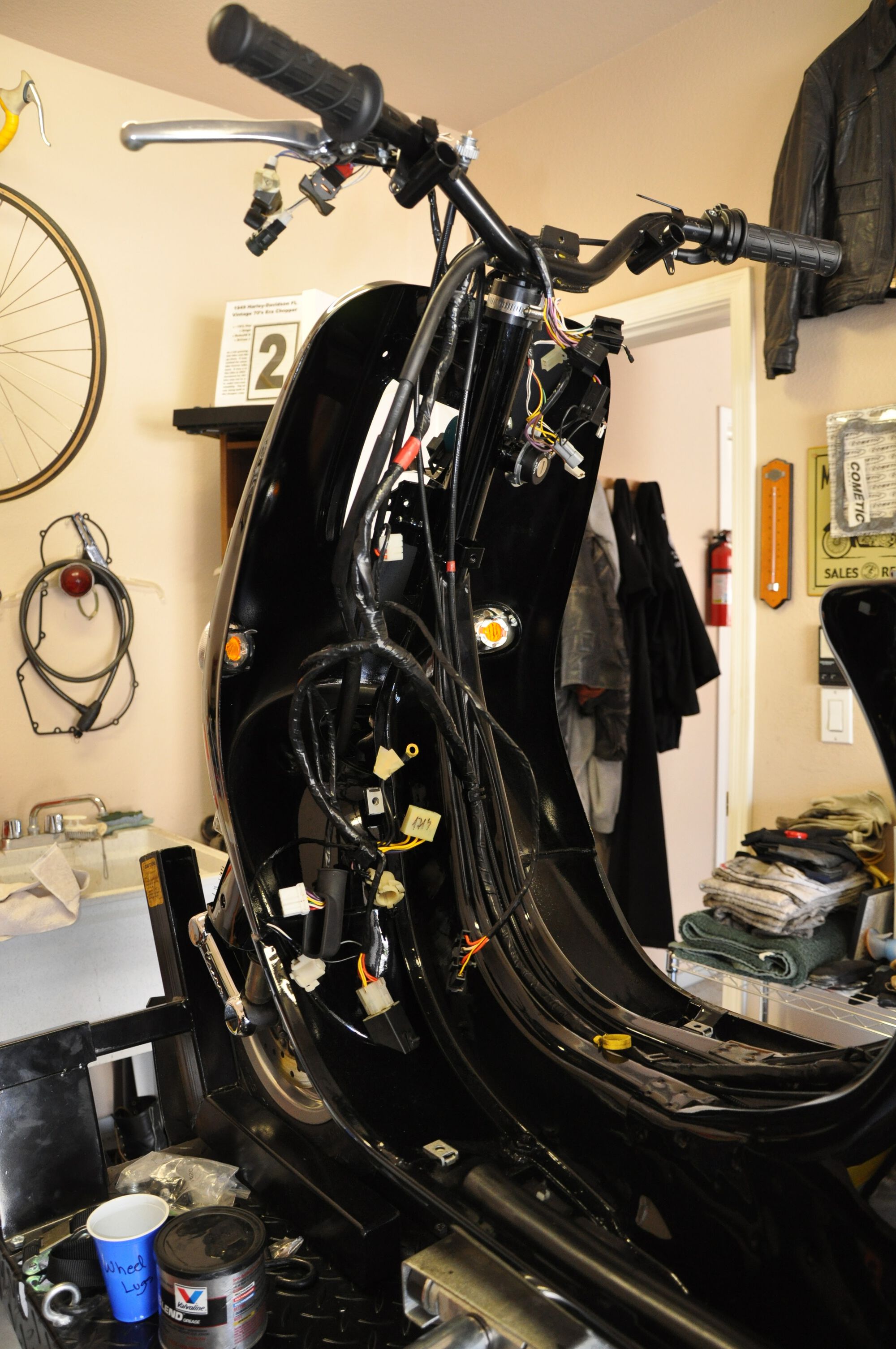

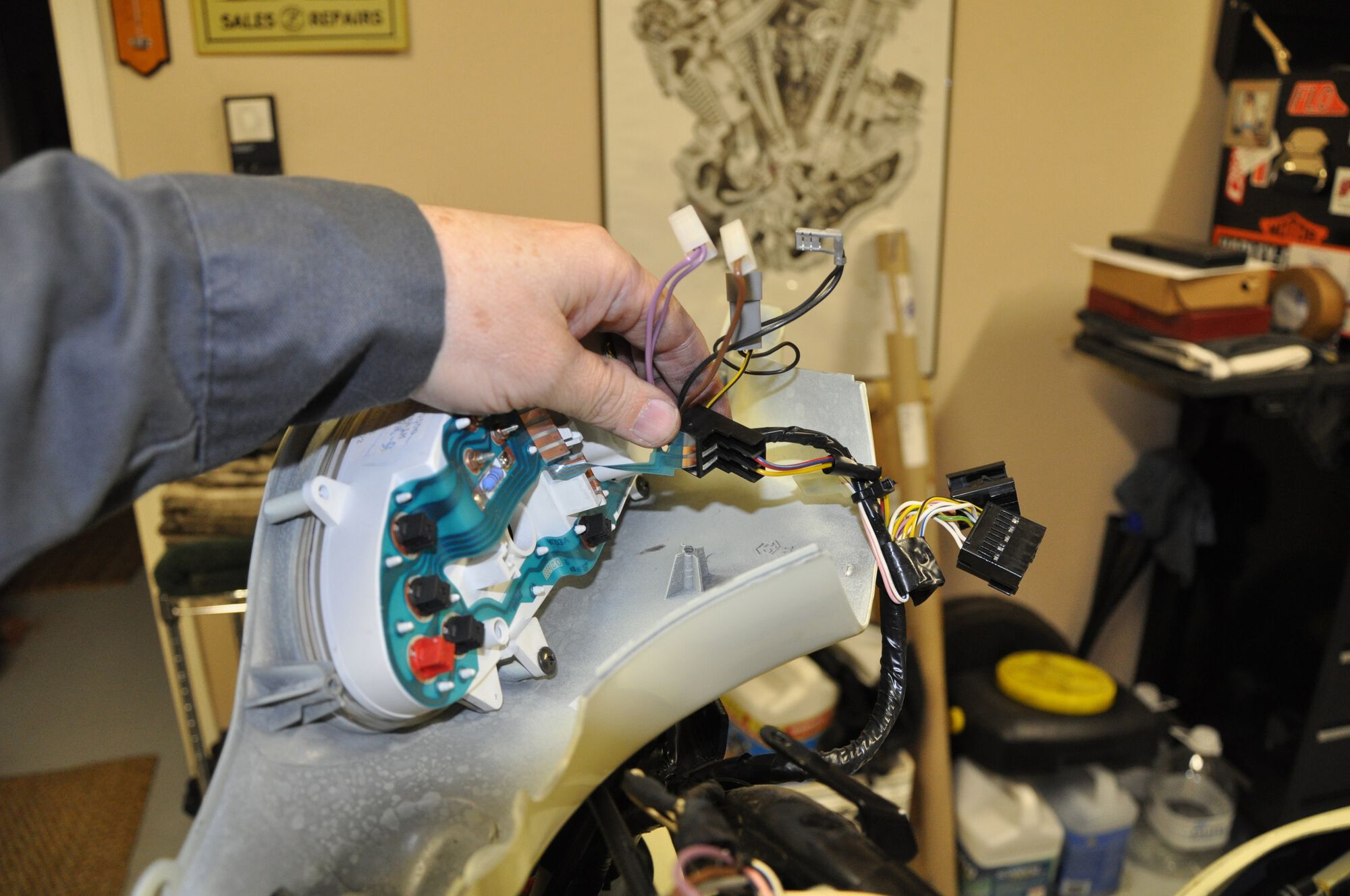

I like to take lots of pictures of the wiring harness.  Helps me remember where everything was routed so I can get it all back nice and neat.

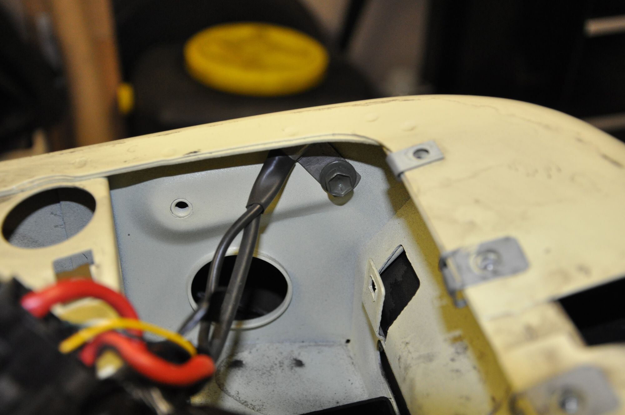

Important to remember where the ground was located...

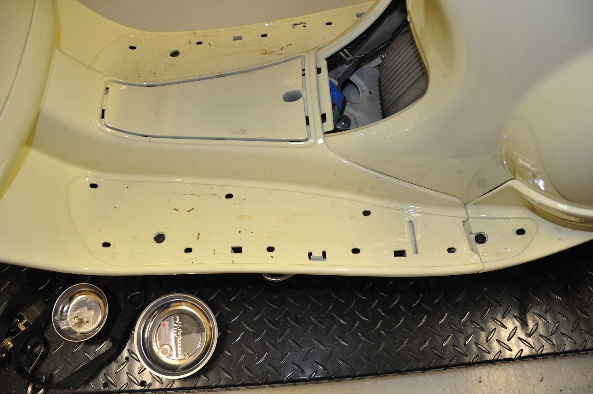

Rubber removed from the floorboards...

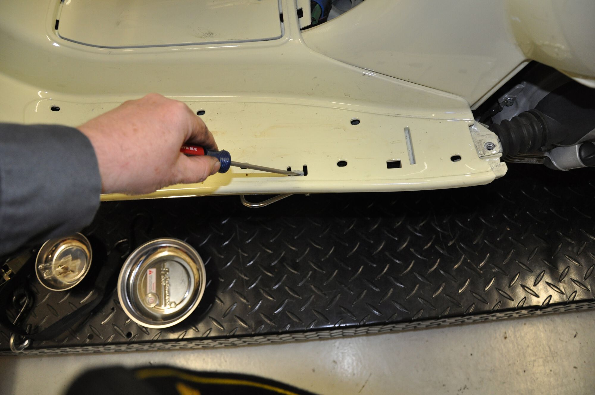

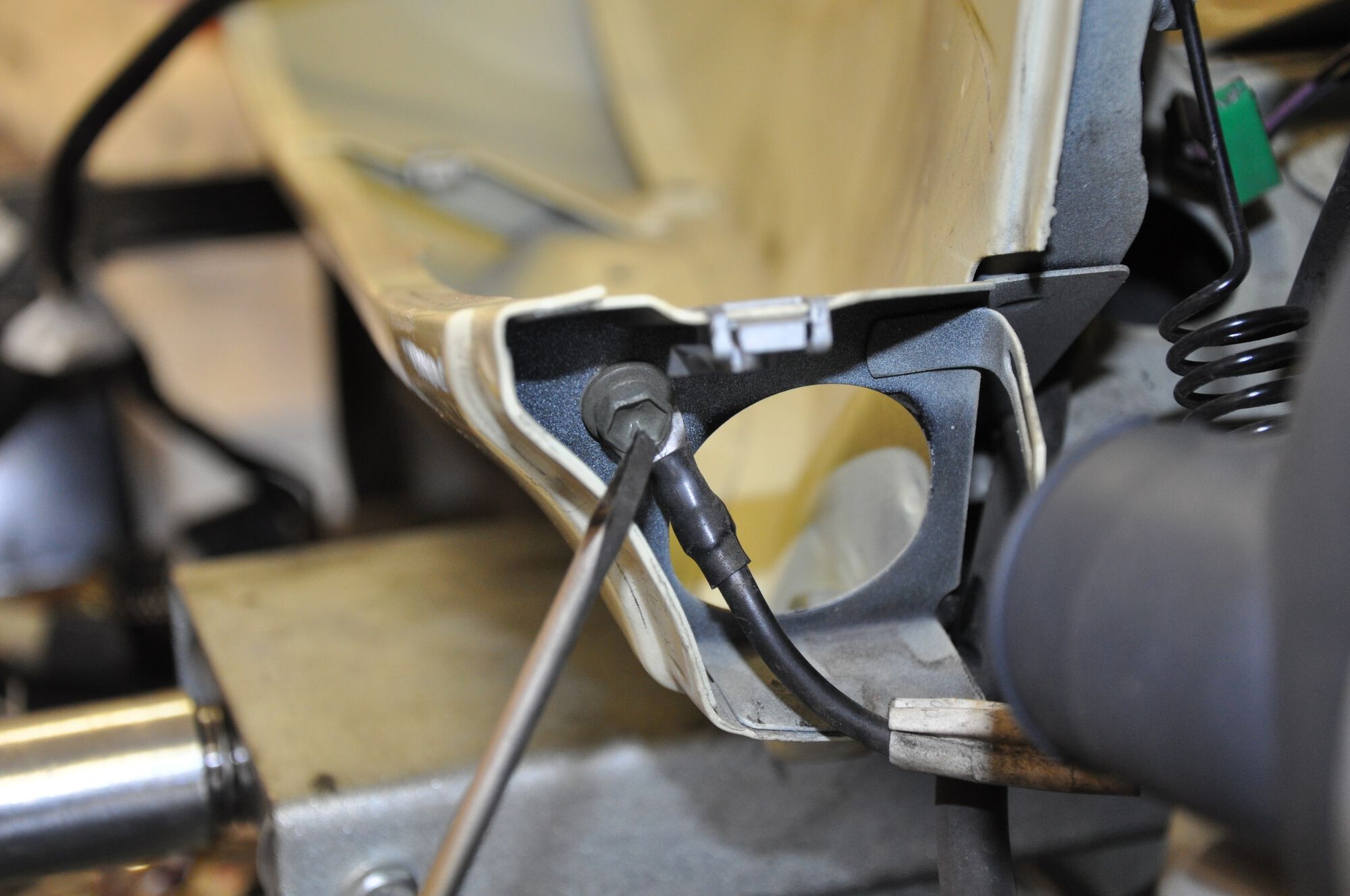

Apply a little leverage with a screwdriver to release the locking tab here...

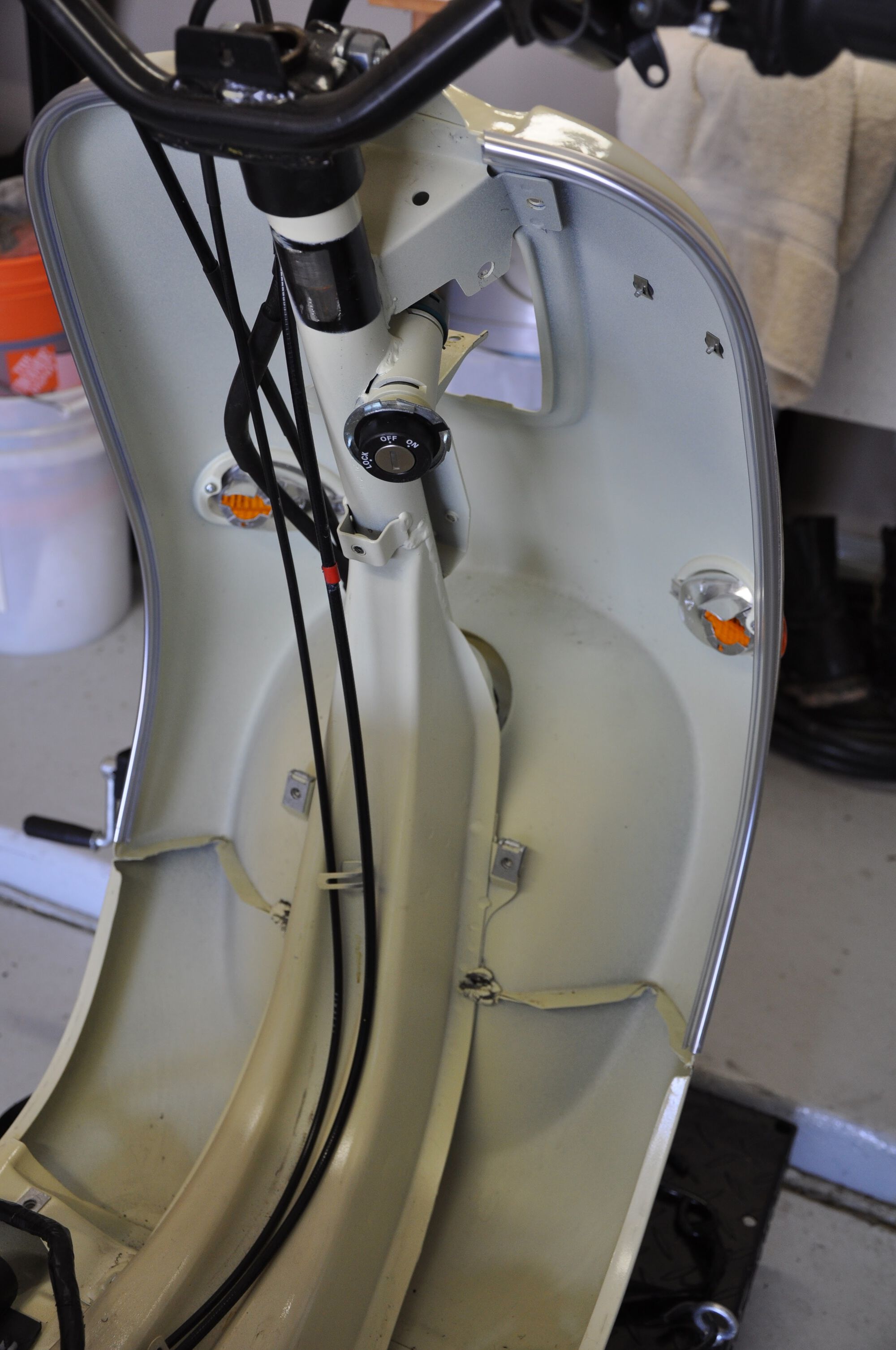

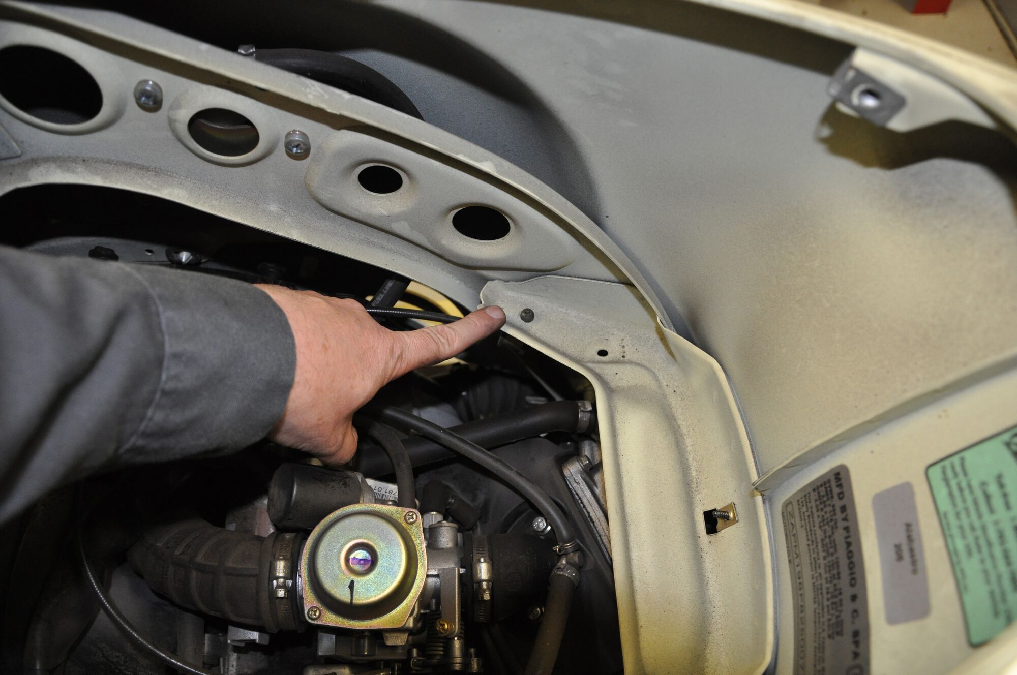

Remembering what the routing of the wiring harness and throttle cables looked like...

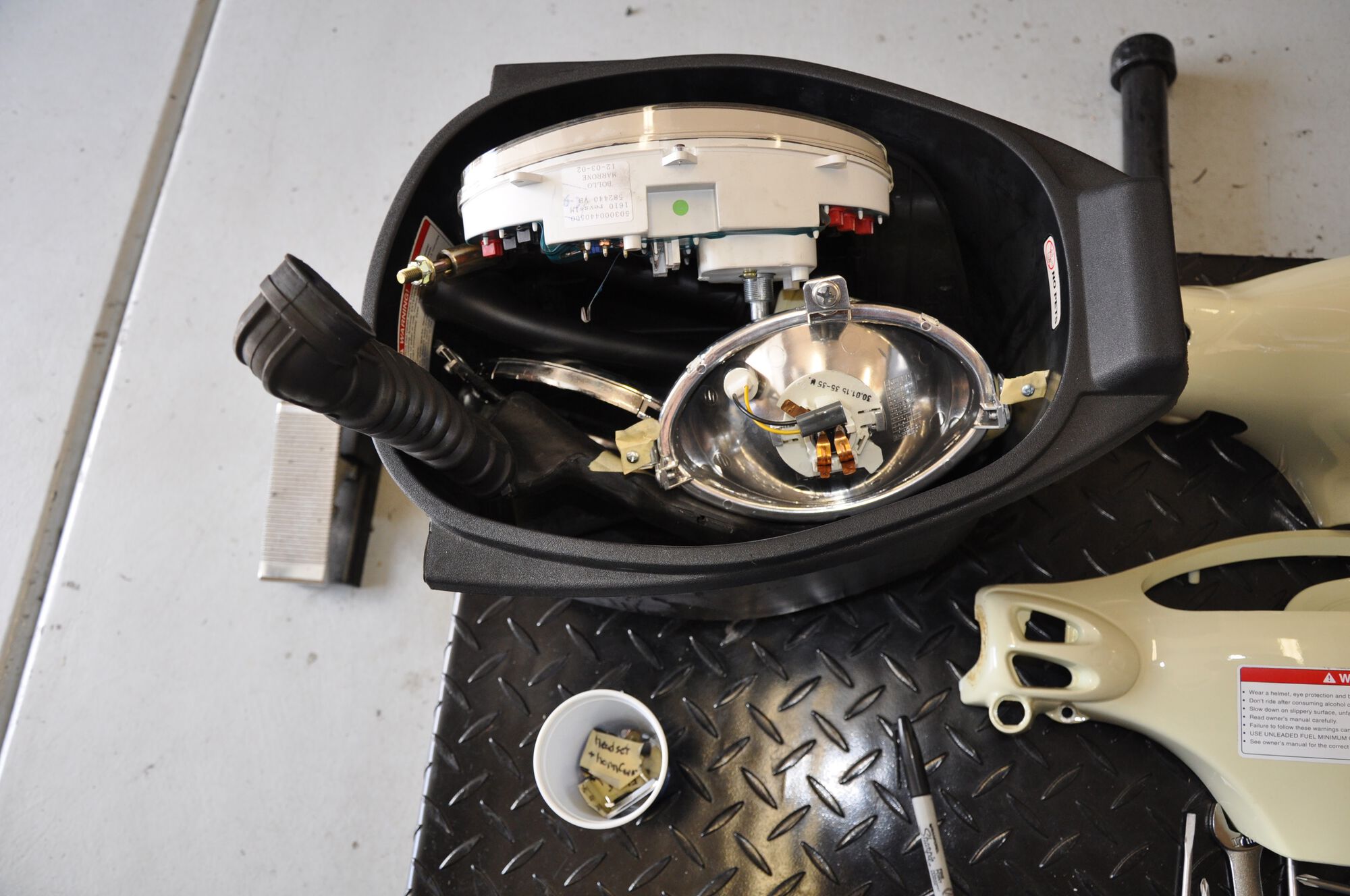

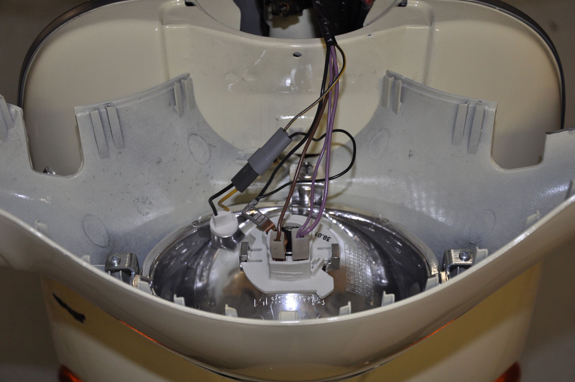

Photos of where the headlight wires plug in will come in handy in a few weeks when things are going back together.

Figured I better get a photo of where this ribbon cable was plugged in before my almost 50 year old brain forgets.

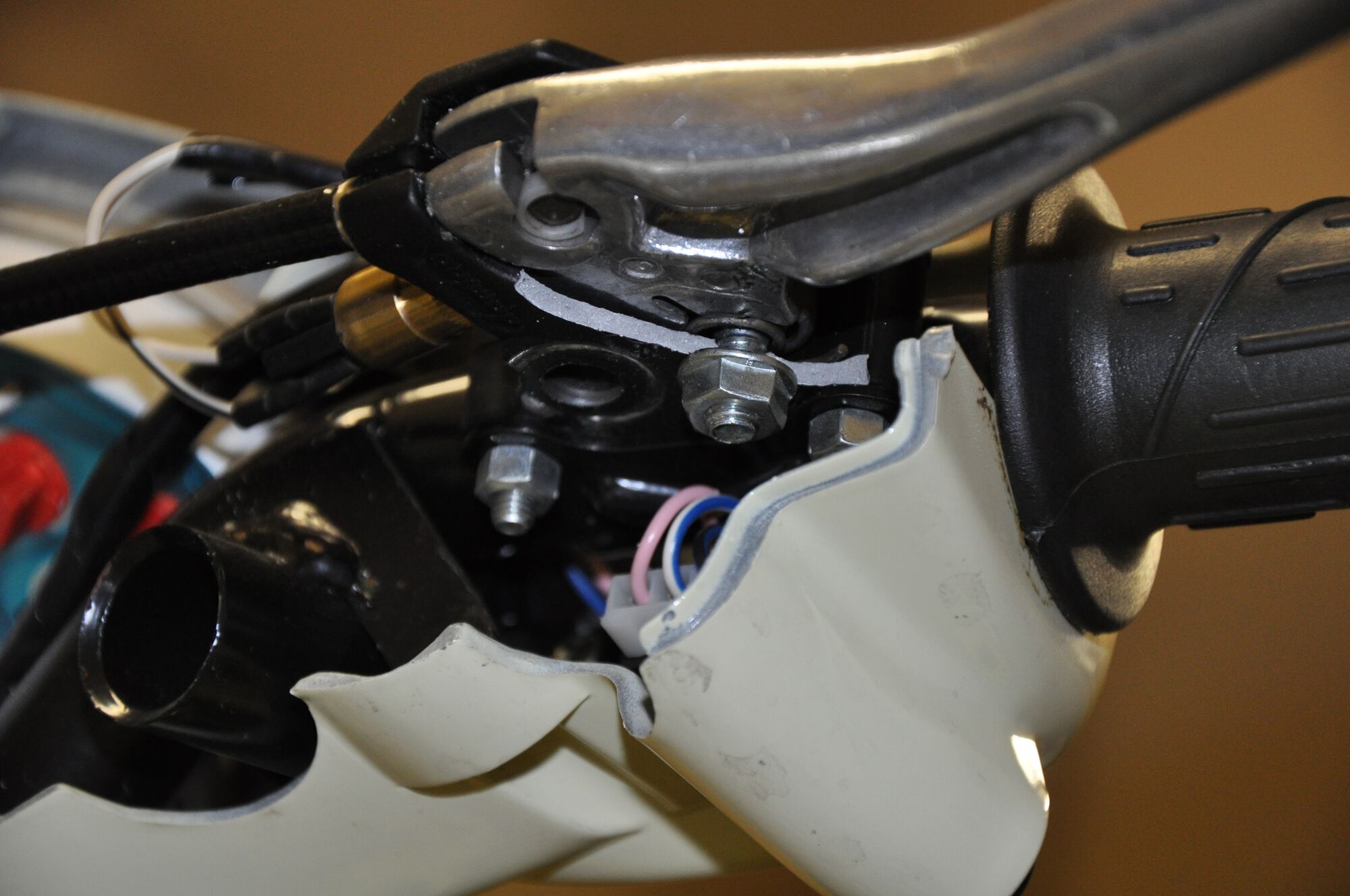

More of the previous owners handywork...
Headset cover removal complete.  It took about 90 minutes to do the work shown in this first set of photos.  Feels like I'm working slow, but don't want to make a mistake since it's new territory for me.  Left it looking like this...

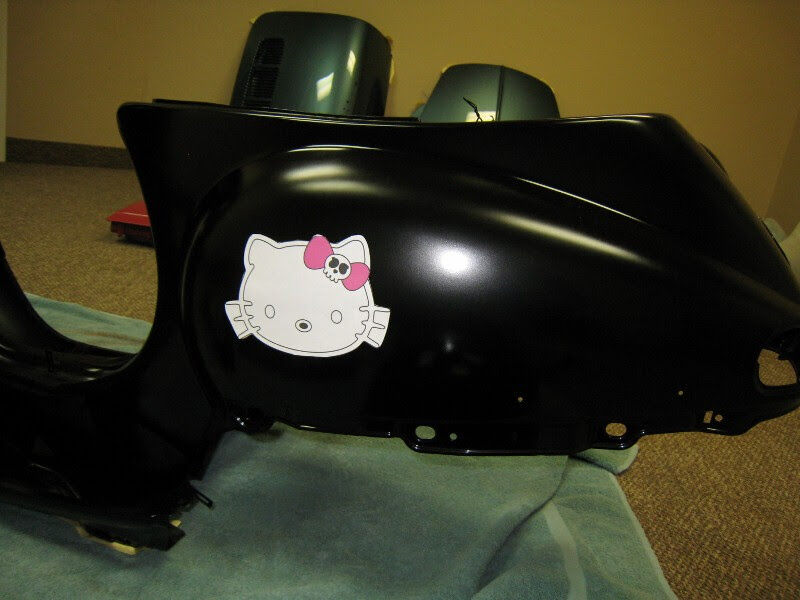

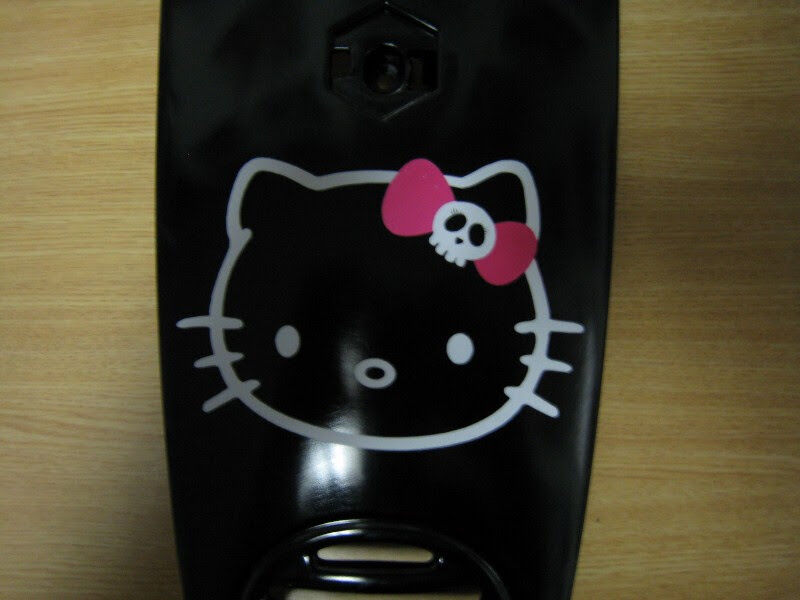

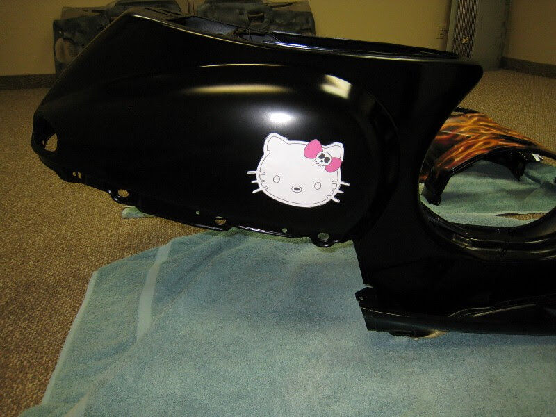

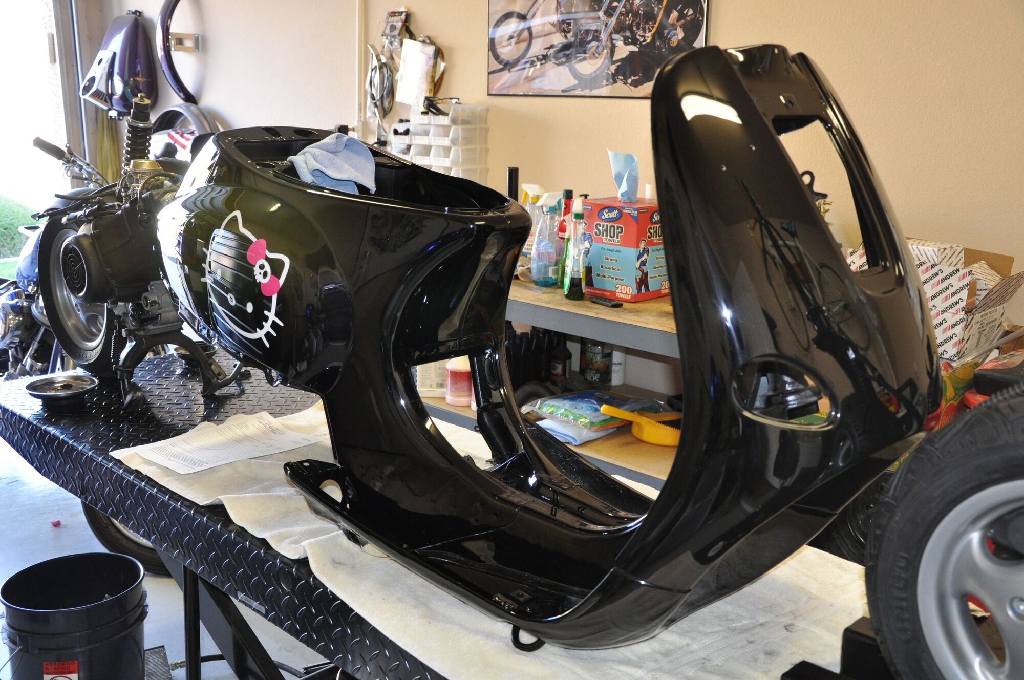

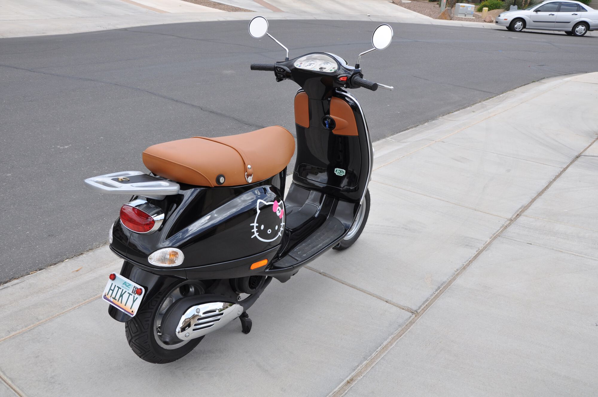

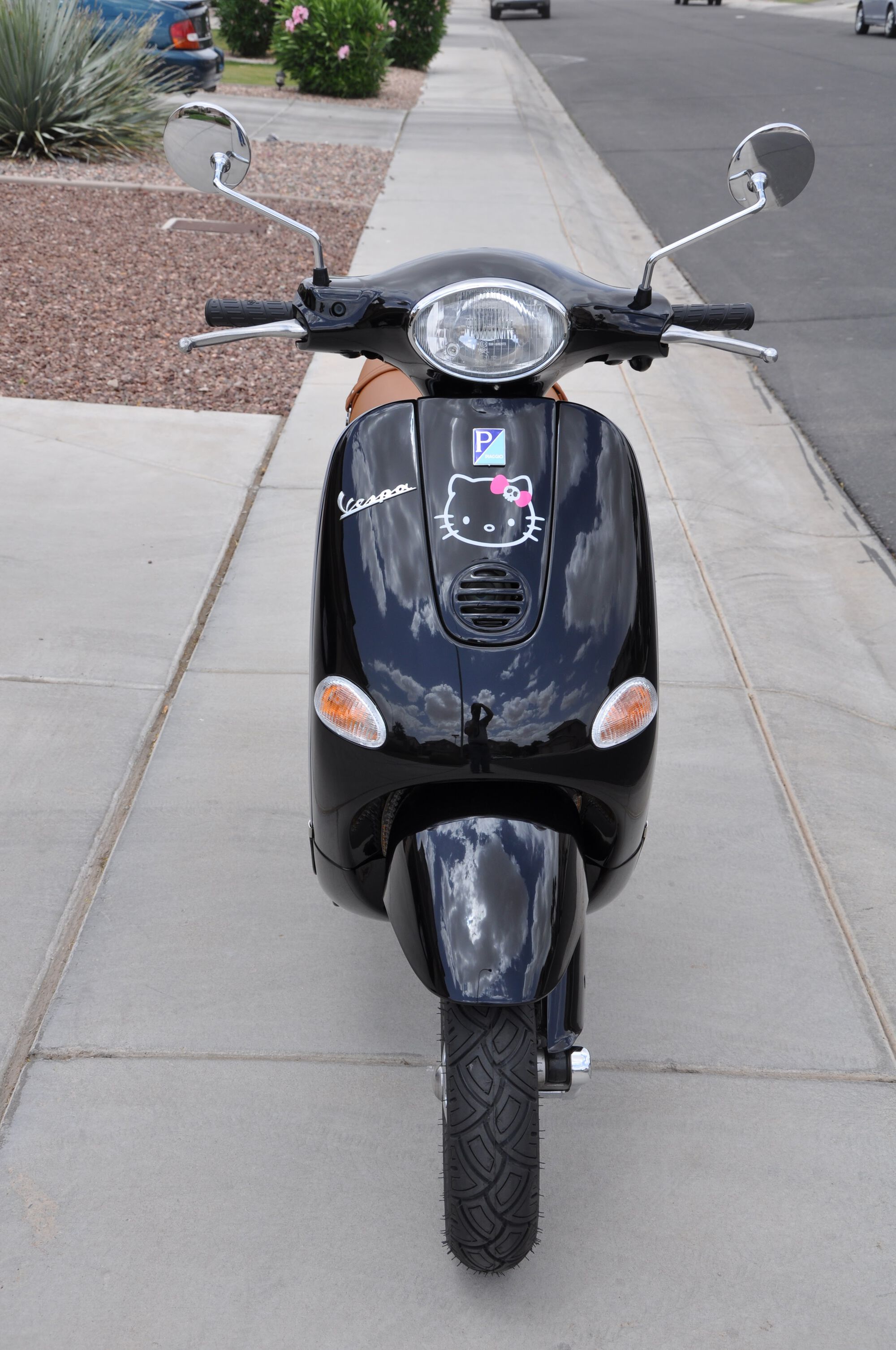

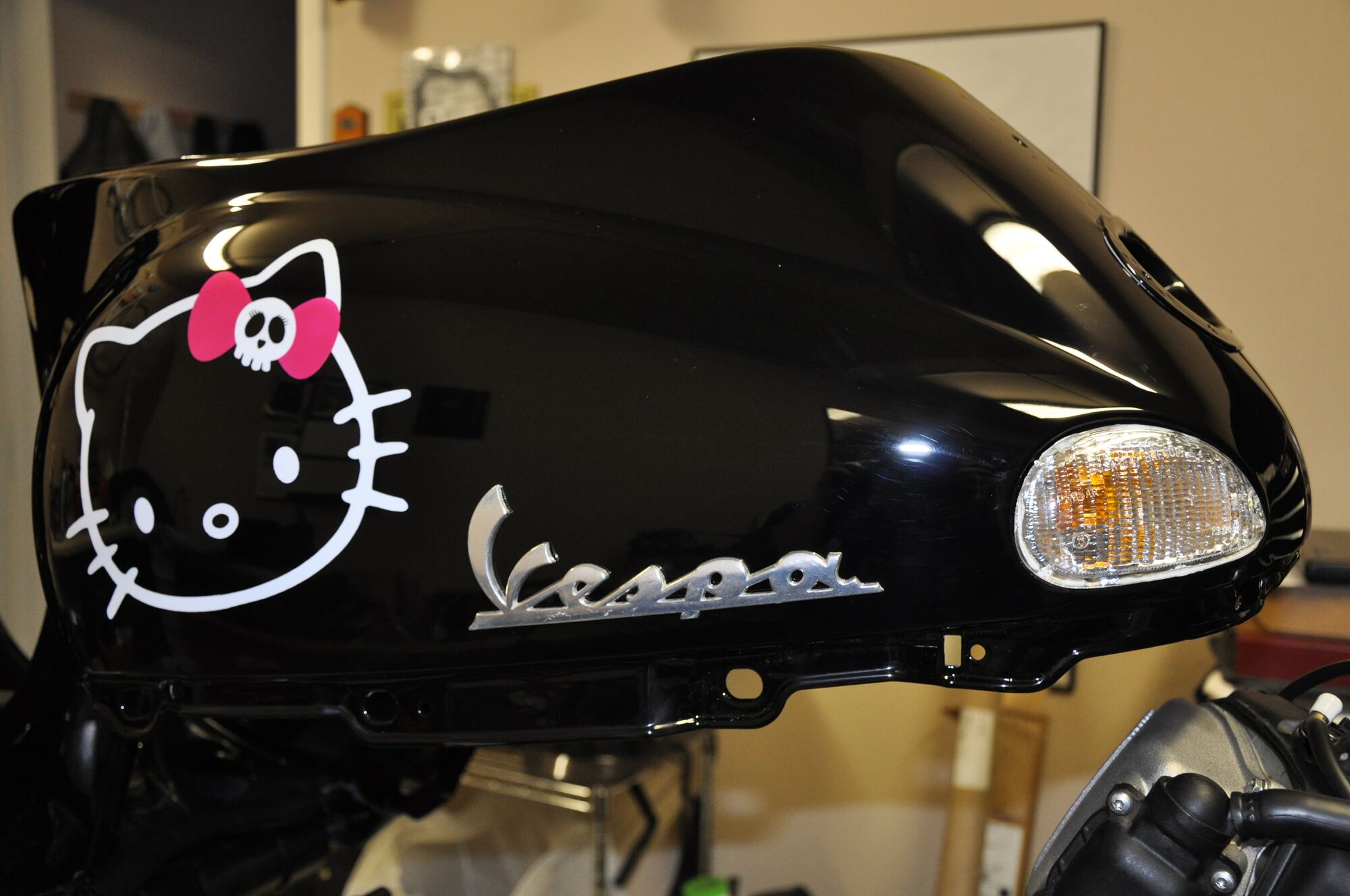

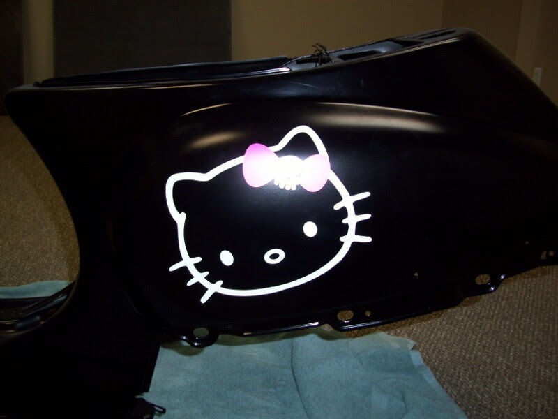

Regarding the question about the paint scheme... my wife is a "Hello Kitty" fanatic. So she wants a "Hello Kitty" theme. But not the usual bubble gum pink. She wants a base coat of gloss black. "Hello Kitty" faces on each side on over the rear wheel and one on the front. She wants the faces to be white outline with pink bows. And in the center of the bow, little skull faces. This is her scooter so she gets what she wants.
Got in a couple hours of work this afternoon before I ran out of time. I've got the fuel disconnected (discovered the petcock is stuck open all the time). Just need to disconnect the electrics from the engine, the throttle and brake cables, shock, pivot bolt, and the drive train should come out. I'll start with that next (probably tomorrow).

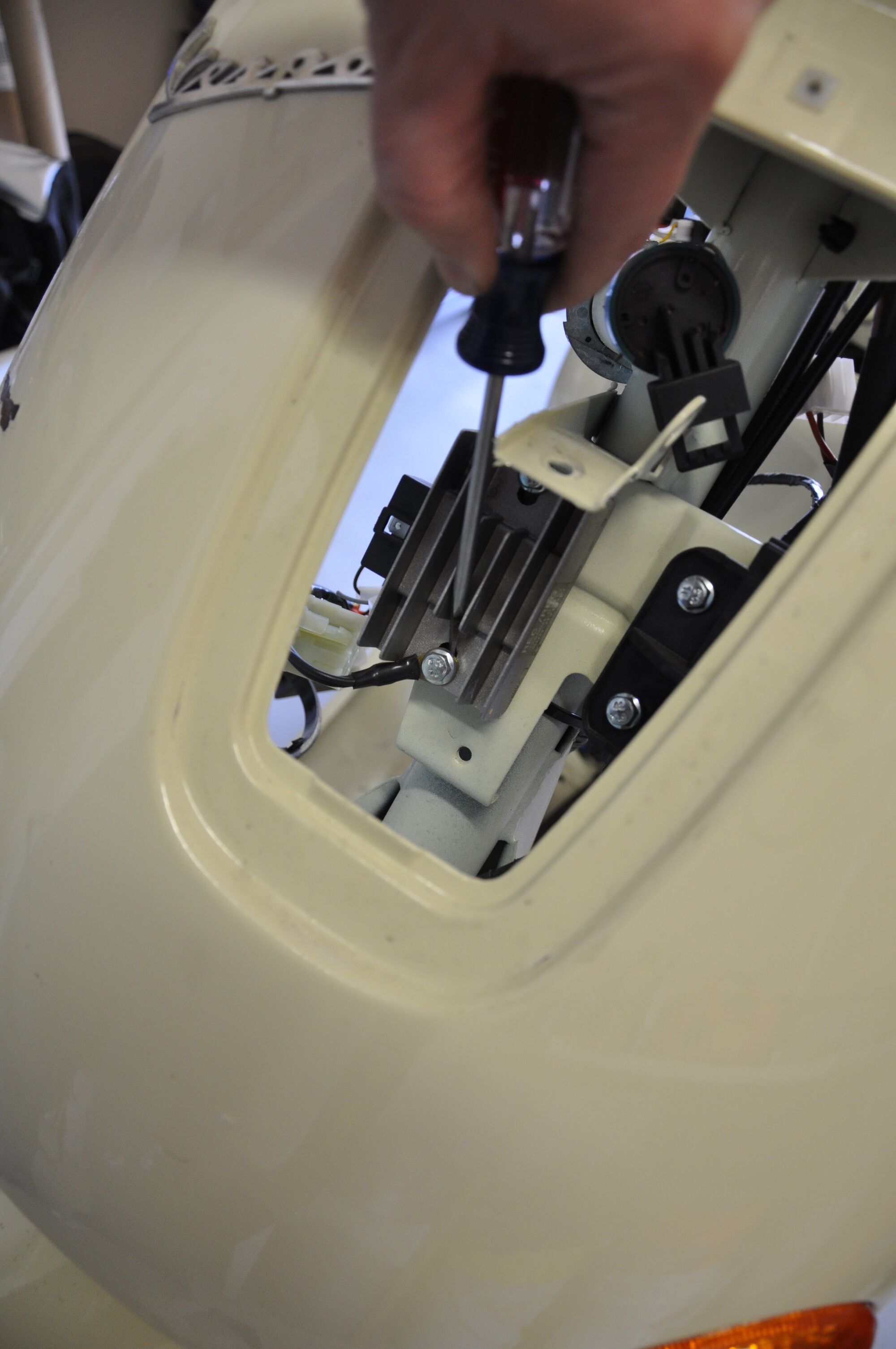

I've taken [b][i]lots[/i][/b] of shots of the wiring harness so I can get it all routed back the same way.  This is just one example.  I'm always interested in where there are zip-ties holding things in place.
Don't want to forget where the wiring harness ground was connected at the regulator.
Things are starting to look less complicated after the wiring harness is out of the way.

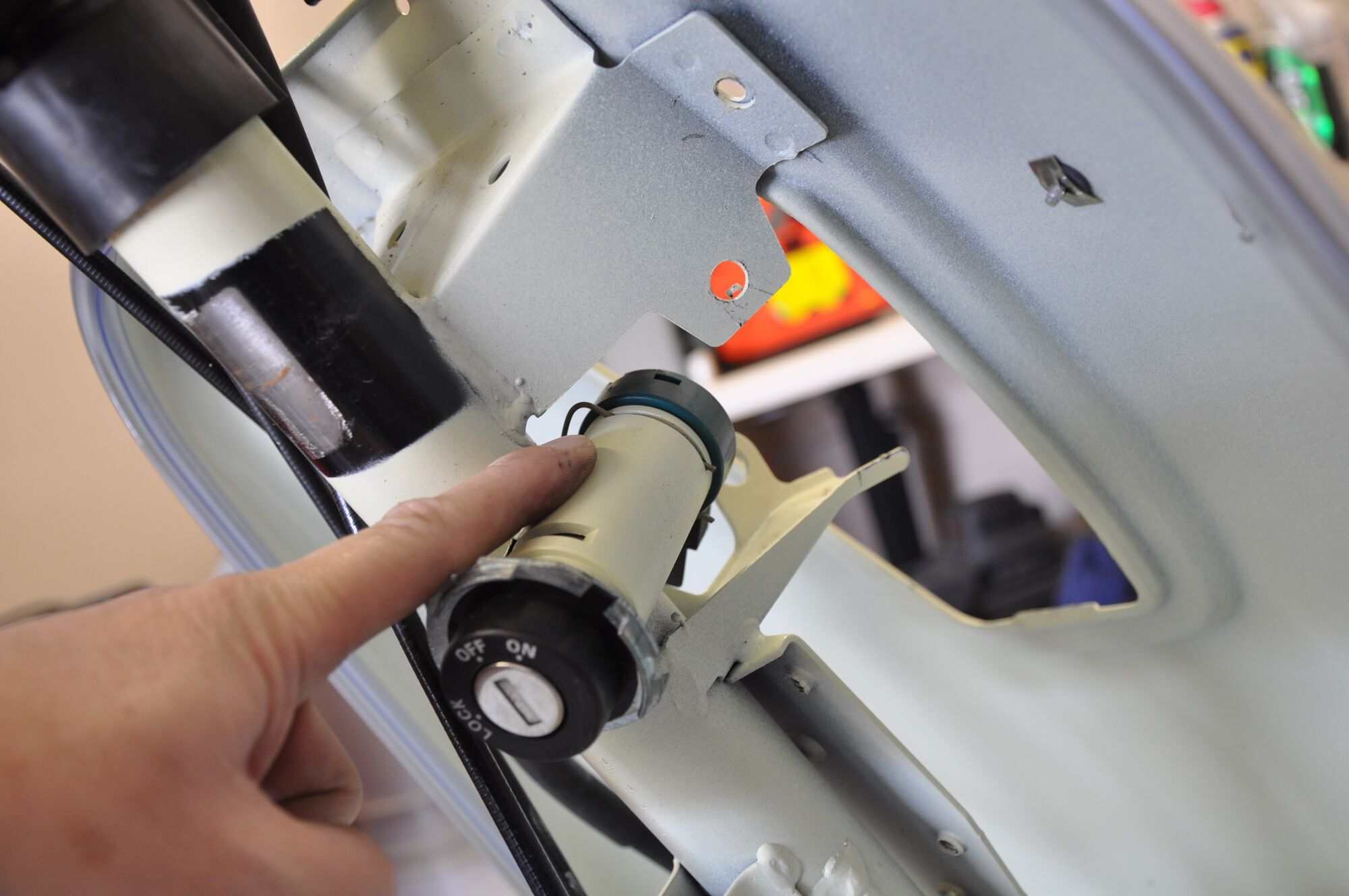

That wire clip is holding the lock cylinder together.  After removing, half the lock came out (the electrical part) but the mechanical part is still there and won't come out until I remove the fork from the frame.

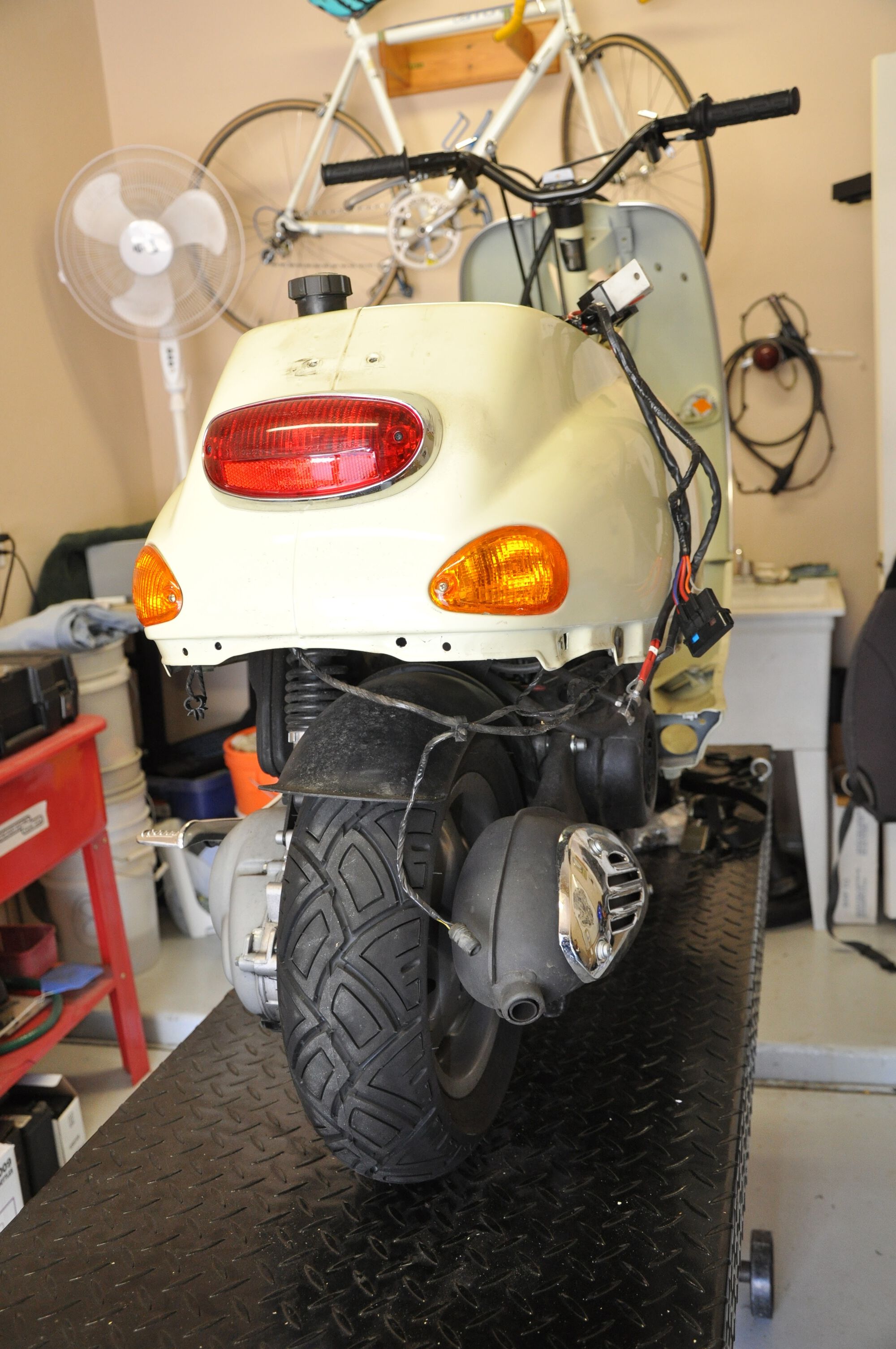

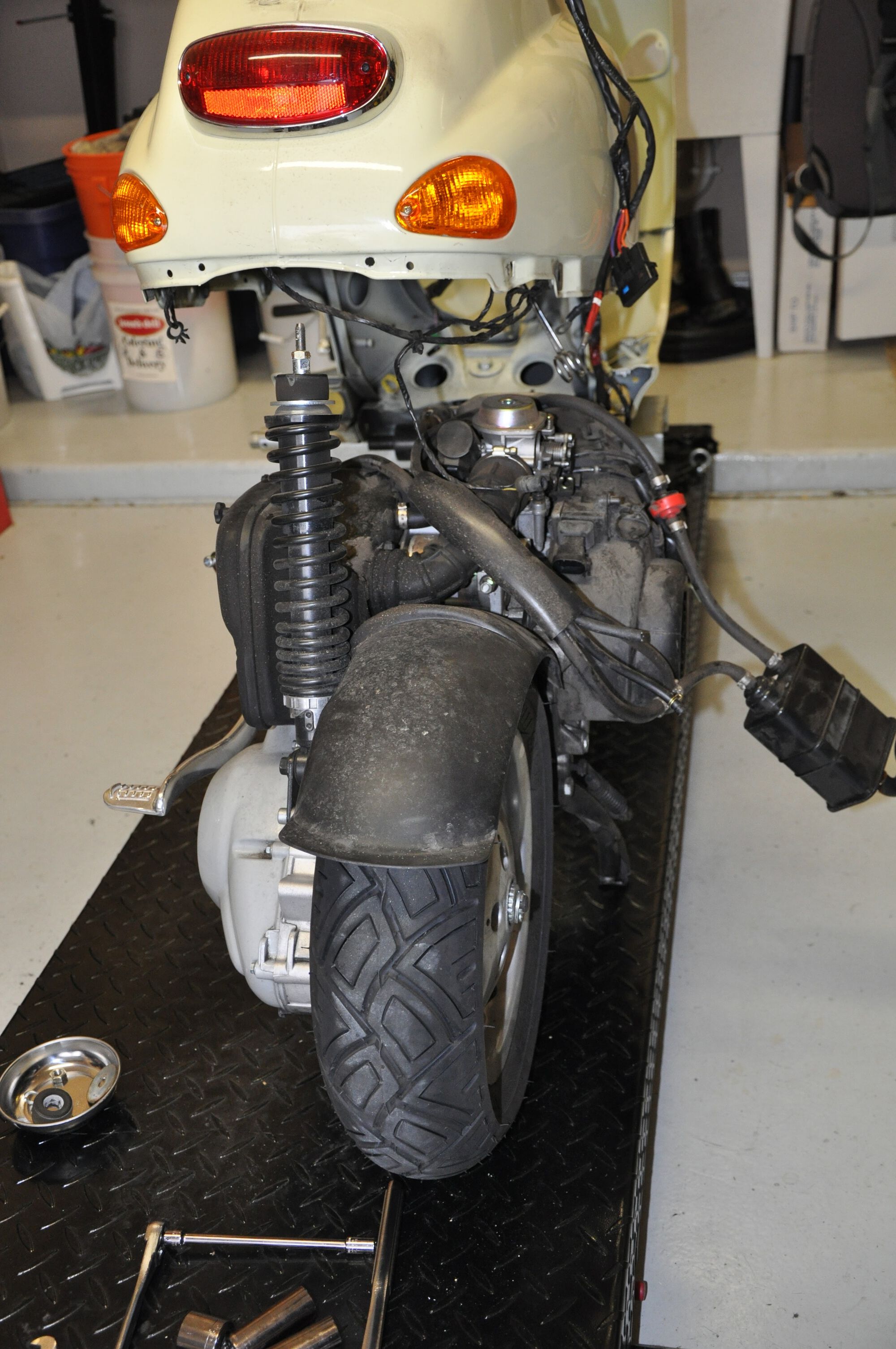

Rear fender is removed.

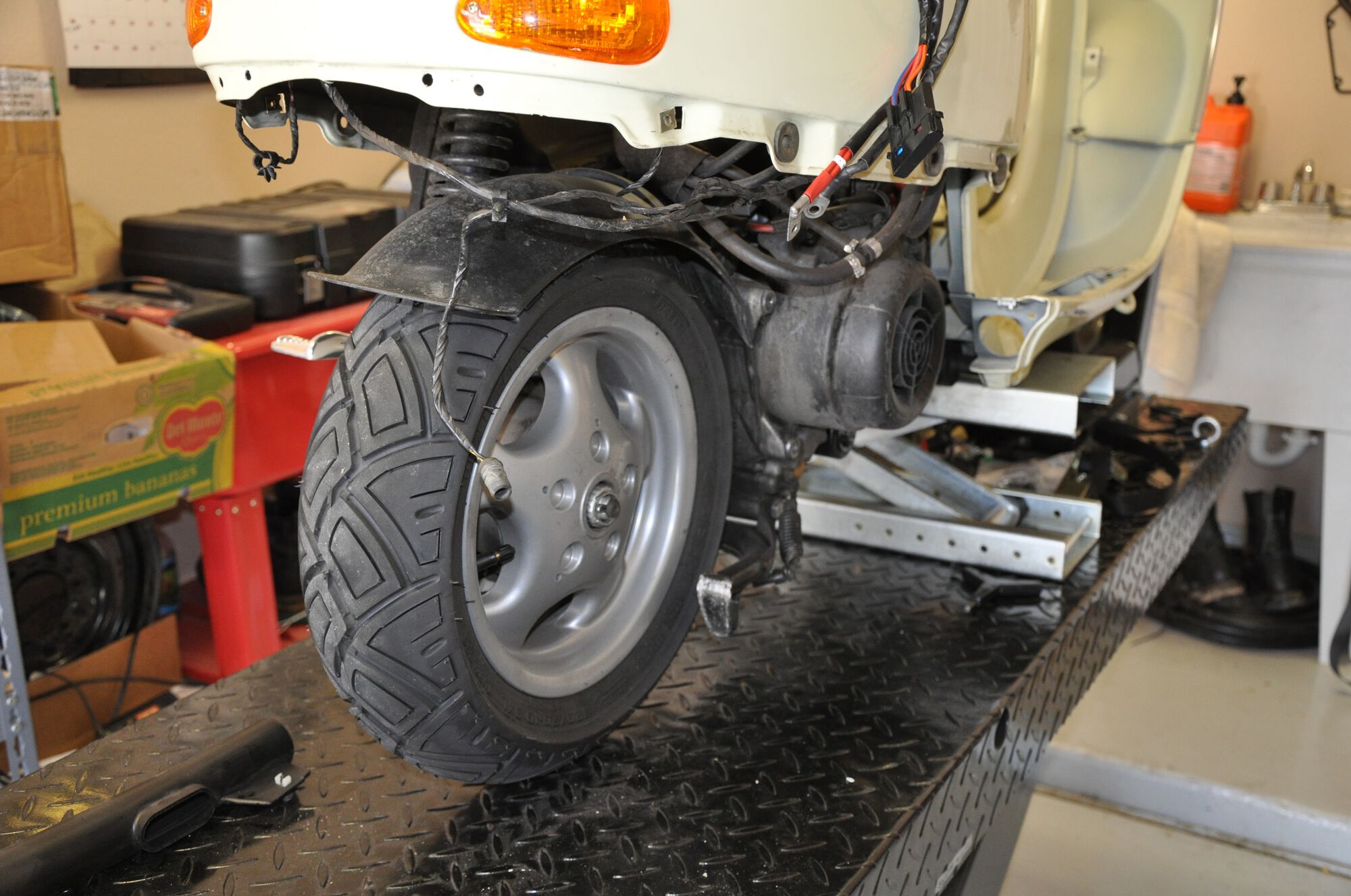

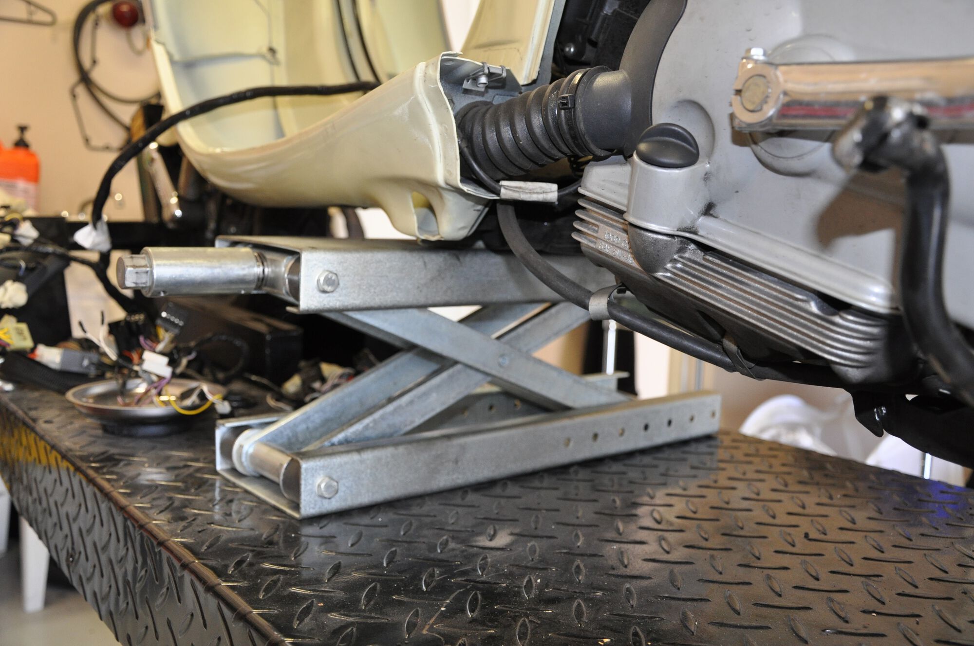

Placed a jack under the pivot bolt in preparation for removing the drive train.
Ground strap between the engine and the frame.
Removed the exhaust.

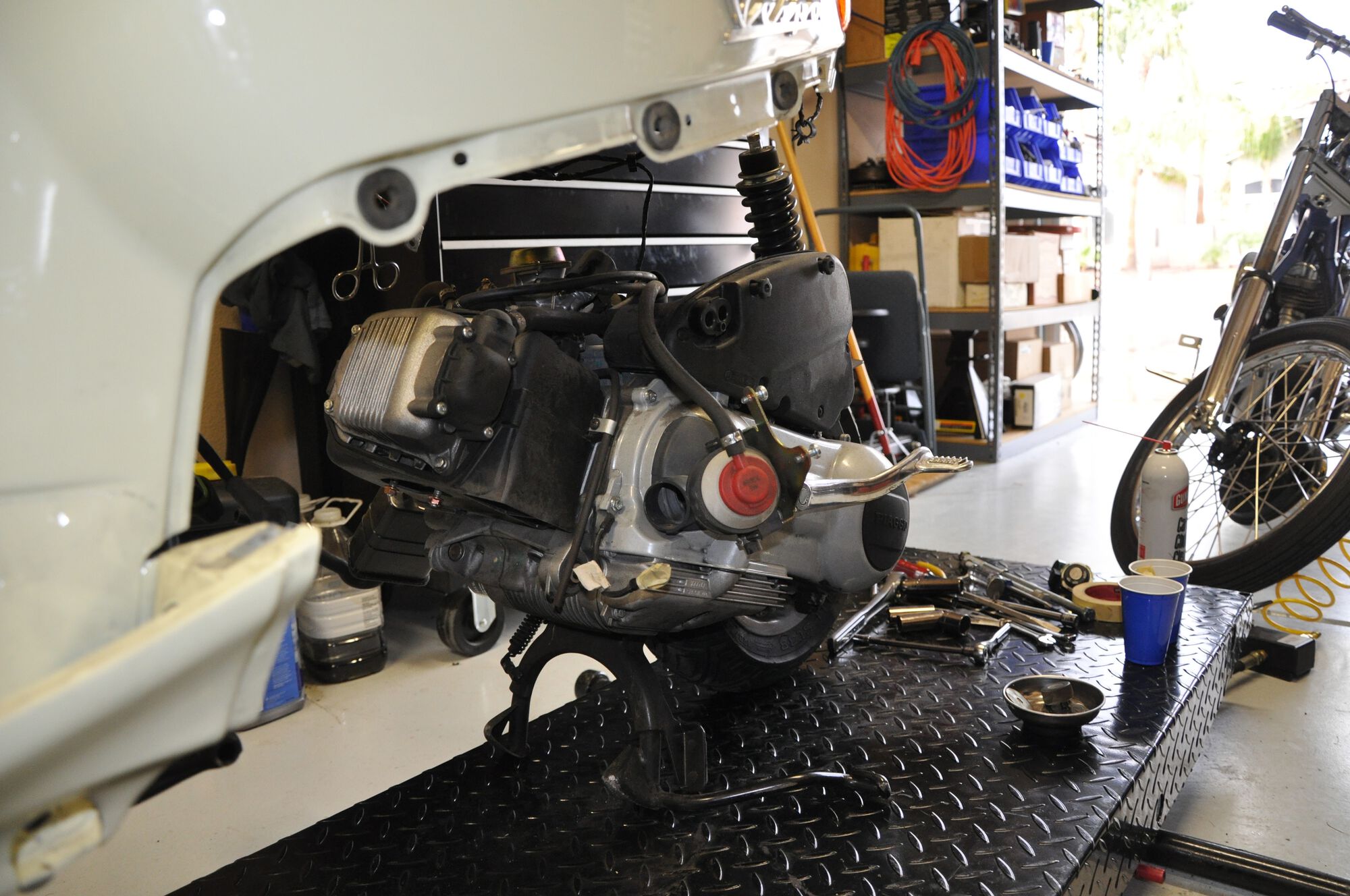

The first order of business was to finish removing the drive train.

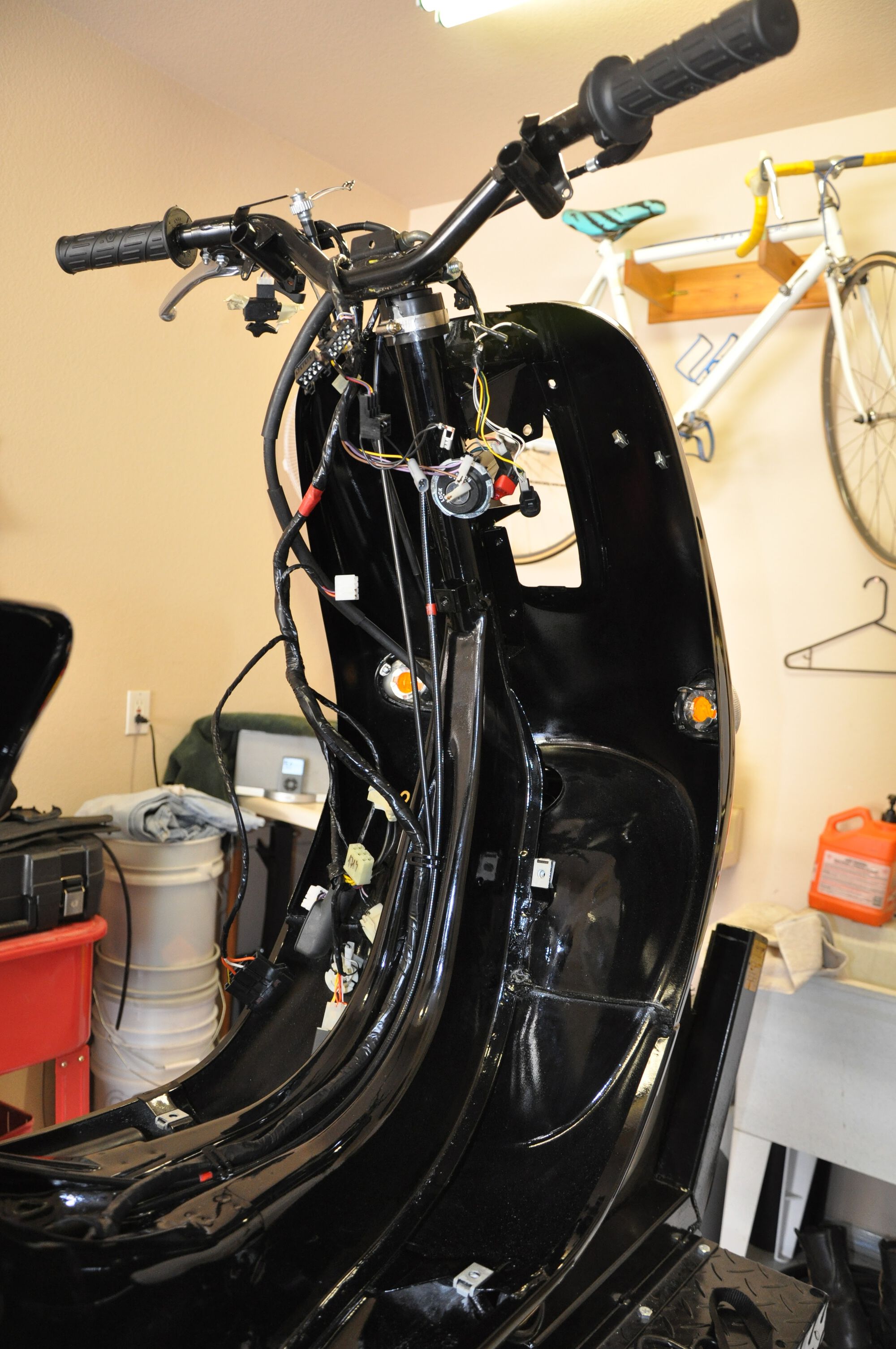

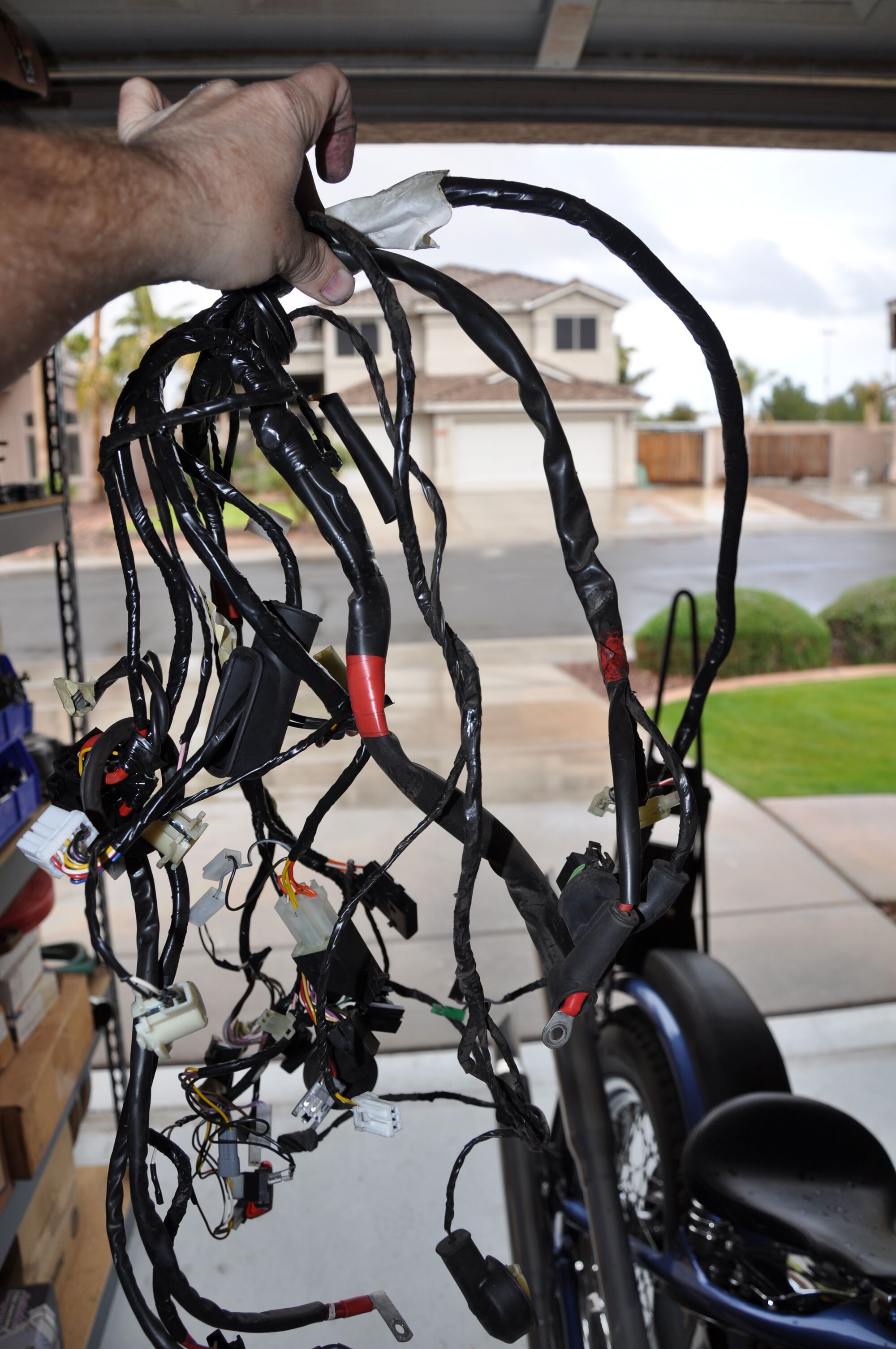

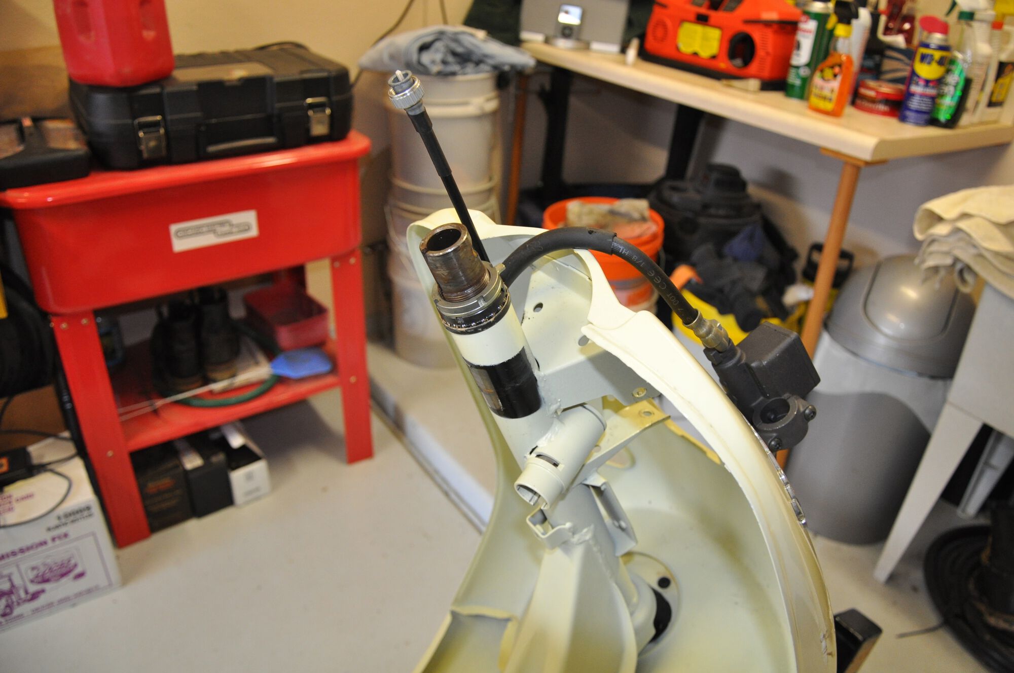

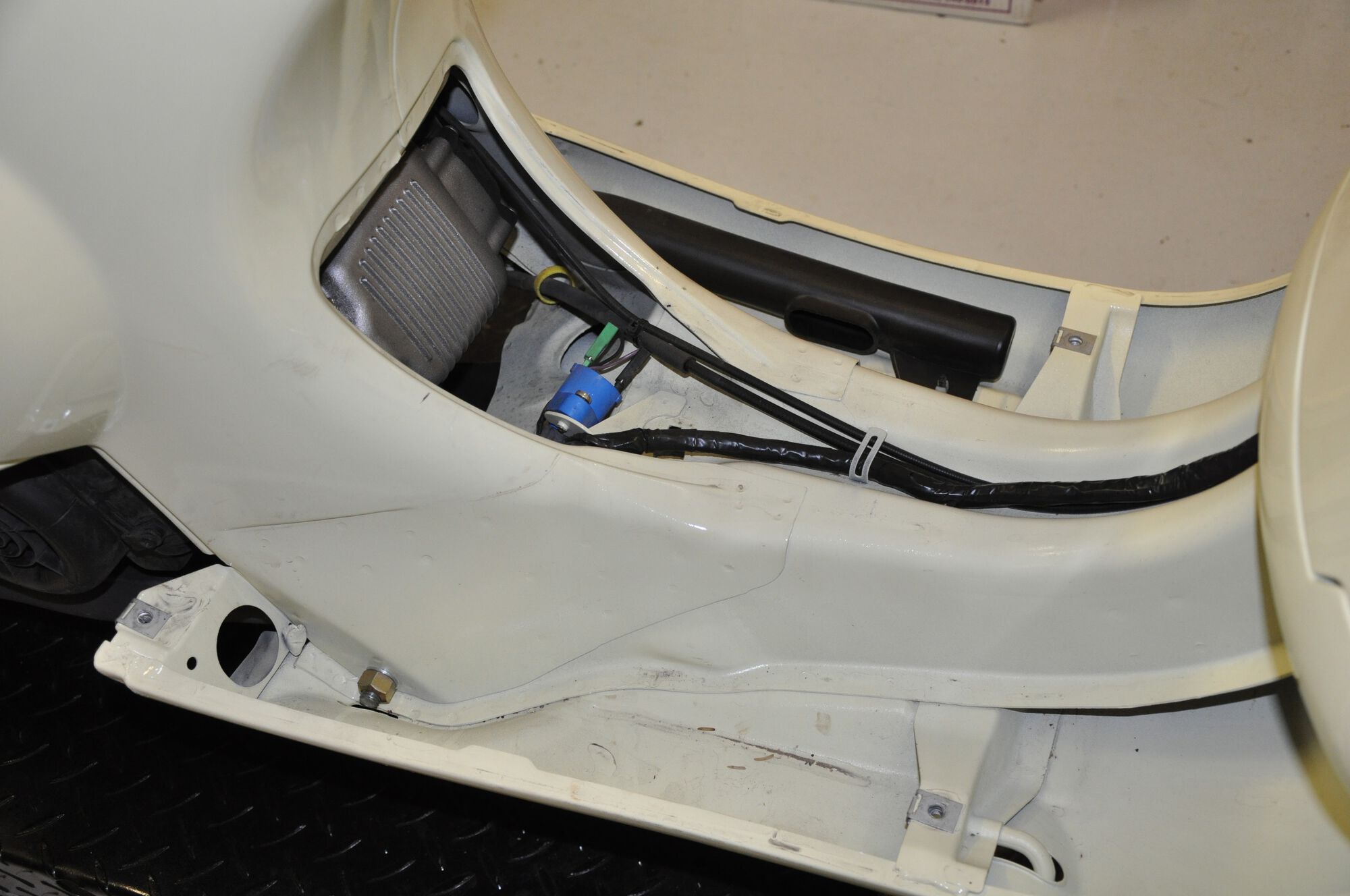

Removed the wiring harness from the frame.
Removed the handle bars.

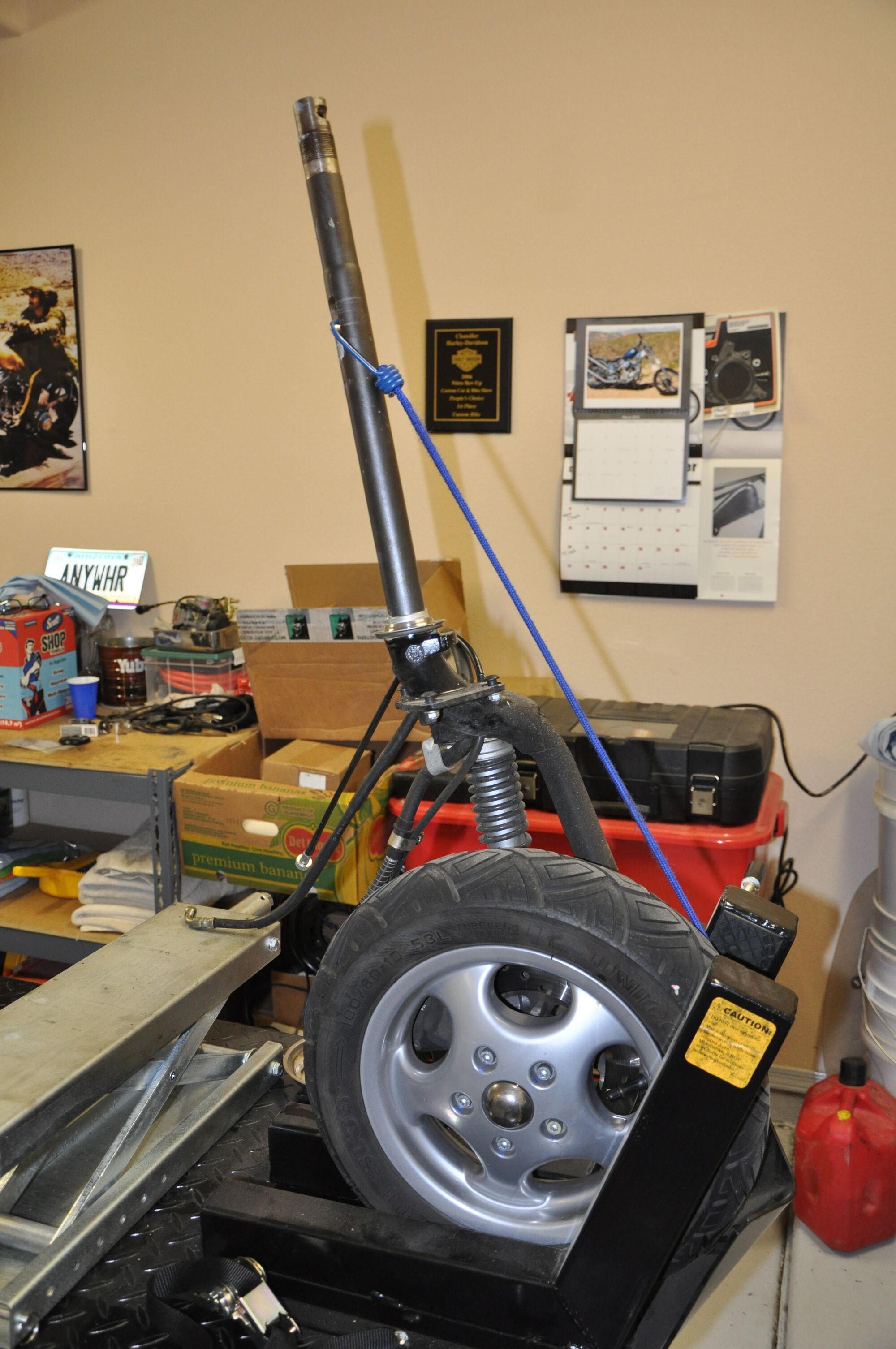

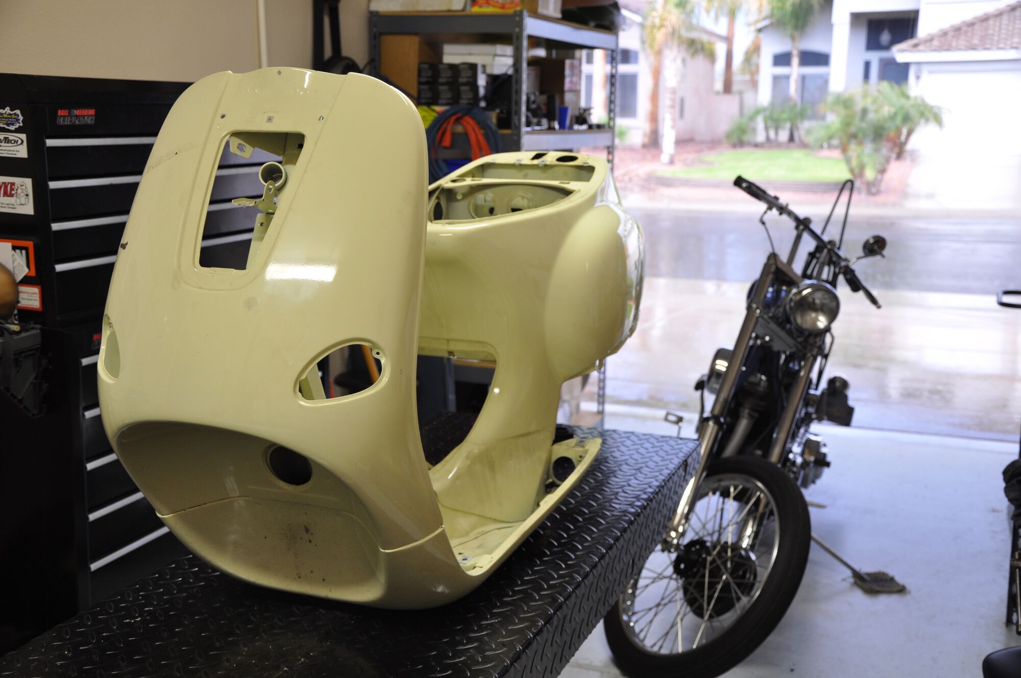

And finally, the front fork assembly.  Leaving the bare frame.

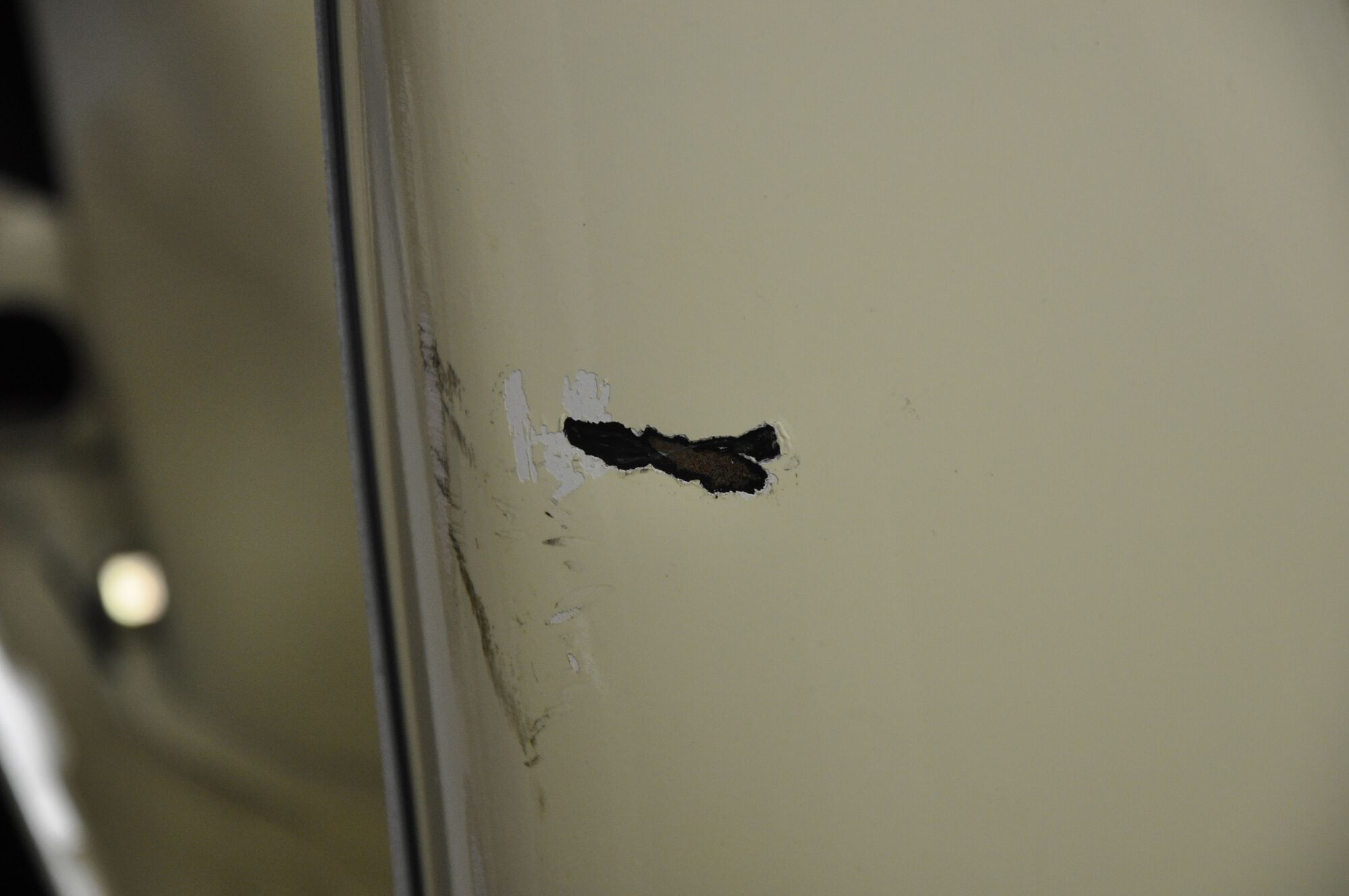

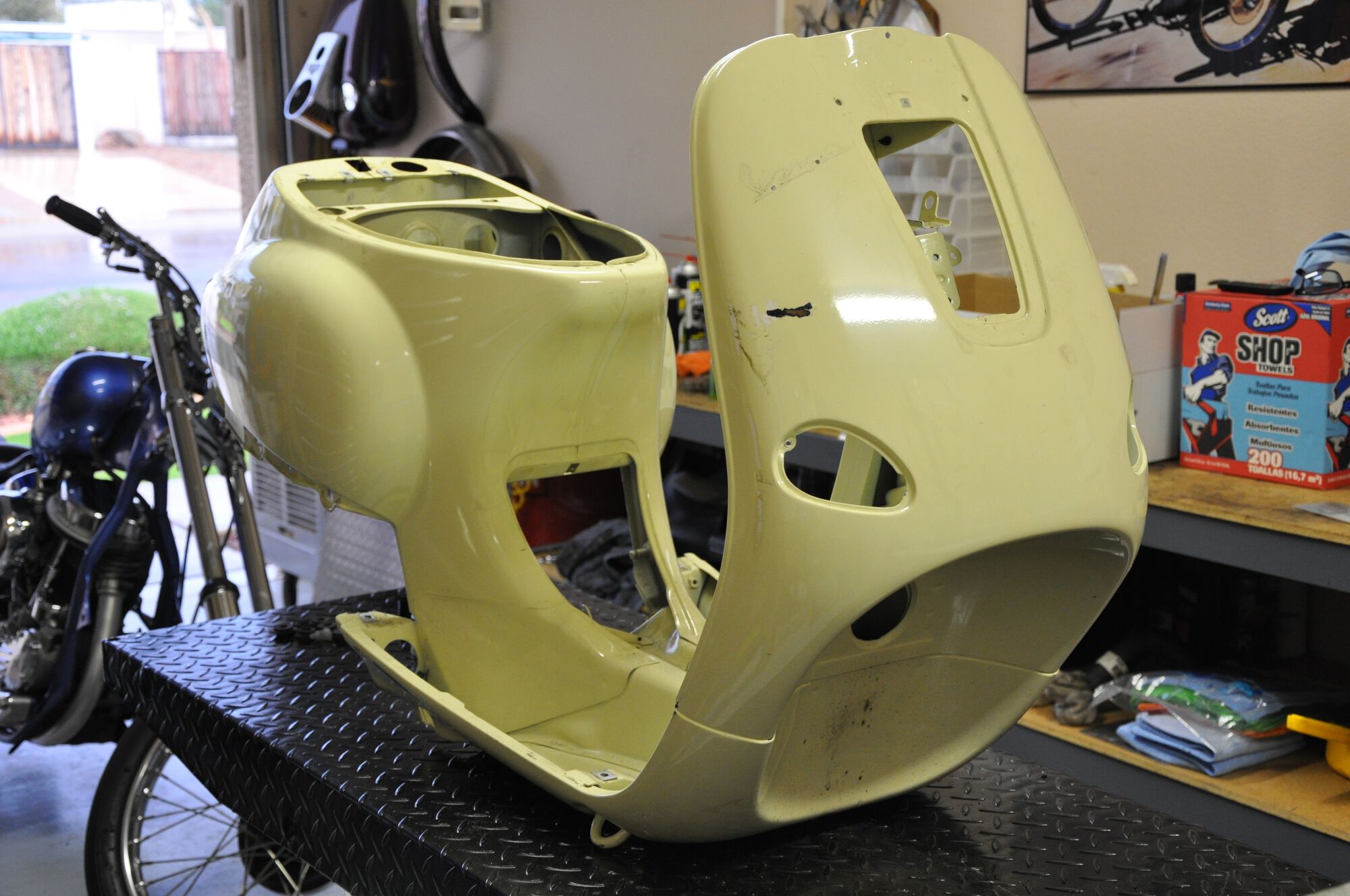

Just a little bit of body work. Nothing major. Yes, there is a small dent to accompany the scratch on the leg sheild. Most of the dents are in the right side rear wheel cowl. I suspect the previous owner is responsible for the door dings in the cowl. They are all very closely located. Must have been tight parking in the garage.
I removed all the covers from the engine yesterday. I need to throw them in the parts cleaner and let them soak for a few days to remove the caked on scrudge. Also removed the carb and disassembled it for a thorough cleaning. I'm debating whether I should throw in a new belt while I'm at it. The scoot only has 1400 miles on it, but the belt is original and 8 years old. Not sure how big a factor "dry rot" is. Any thoughts from those who've got experience?

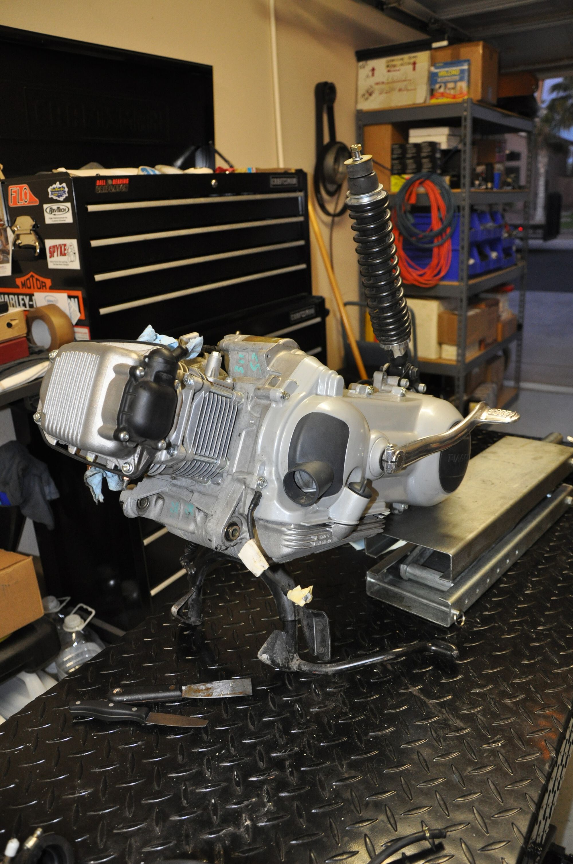

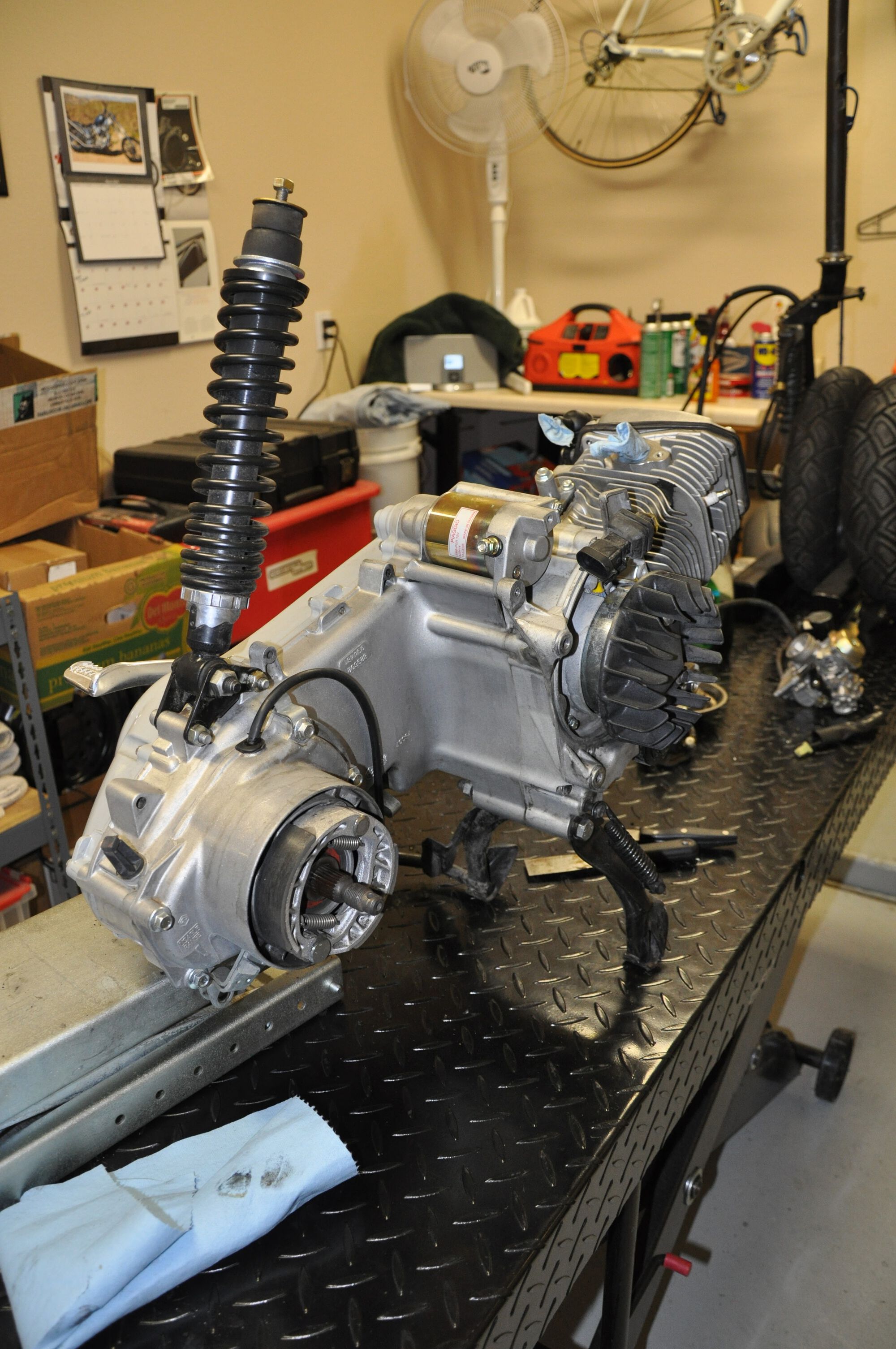

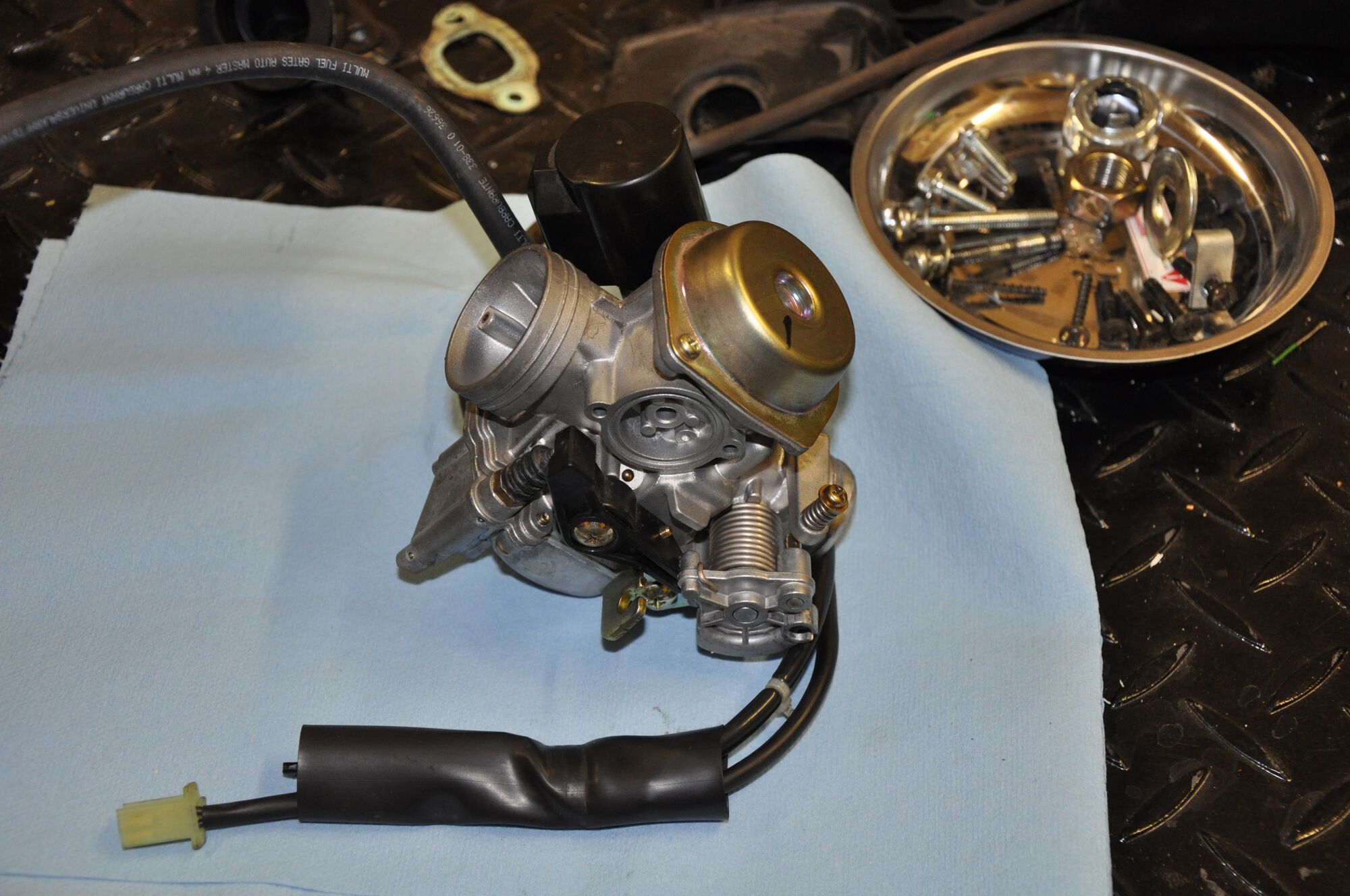

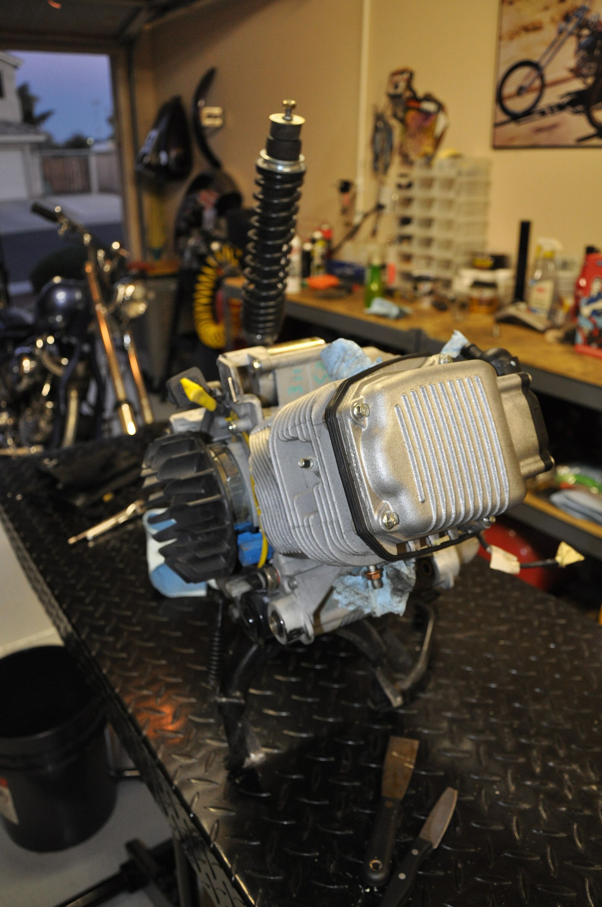

Today all I did was spend some time cleaning up the engine. Even with the low miles it had collected a lot of build-up of grim. It almost would seem like the previous owner rode in sand a lot. There was a lot of oily sand in the hard to reach places.
EDITED 31-Jan-2026 to restore photos lost when PhotoBucket went to a pay model.

The scooter was definitely not "bad" to start. There were numerous little "dings" and LOTS of scratches (it's been thrown down the road on both sides). But most didn't penetrate down below the surface level of paint.
My past projects have been on antique Harleys and this is so much easier. I'm not dealing with 50+ years of grime build up. Also, there are no signs of previous "shade tree" mechanical work. With the old Harleys you typically have to deal with the problems caused by previous owners making poorly executed repairs.
I'm impressed with the way these scooters are put together. Easy to disassemble/assemble and very good quality too. Vespa has done a great job IMO.
-Craig

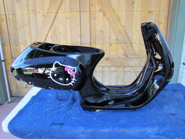

This project is still in the works. The painter is planning to shoot the base color (black) on Monday morning. After that, the graphics will be added and then several coats of clear to bury the graphics.
The painter (2nd Avenue Custom and Classic Scooter Painting in Phoenix) has been awesome about communicating the status. I get emails every couple of days as things progress. Yesterday he sent over a proof of the graphics. After making a few tweaks to the proof and sending it back, this is what we have:
There will be a "hello kitty" on the horn cover, one over each rear wheel cowl and one on the top case. Not too over the top since it's not all bubble gum pink
Most of the mechanical work is done. New drive belt and rollers, carb rebuild, adjusted the valves, etc. The only thing left is to clean up the front suspension and mount a new front tire. And of course reassemble the scooter once I have all the painted parts back.

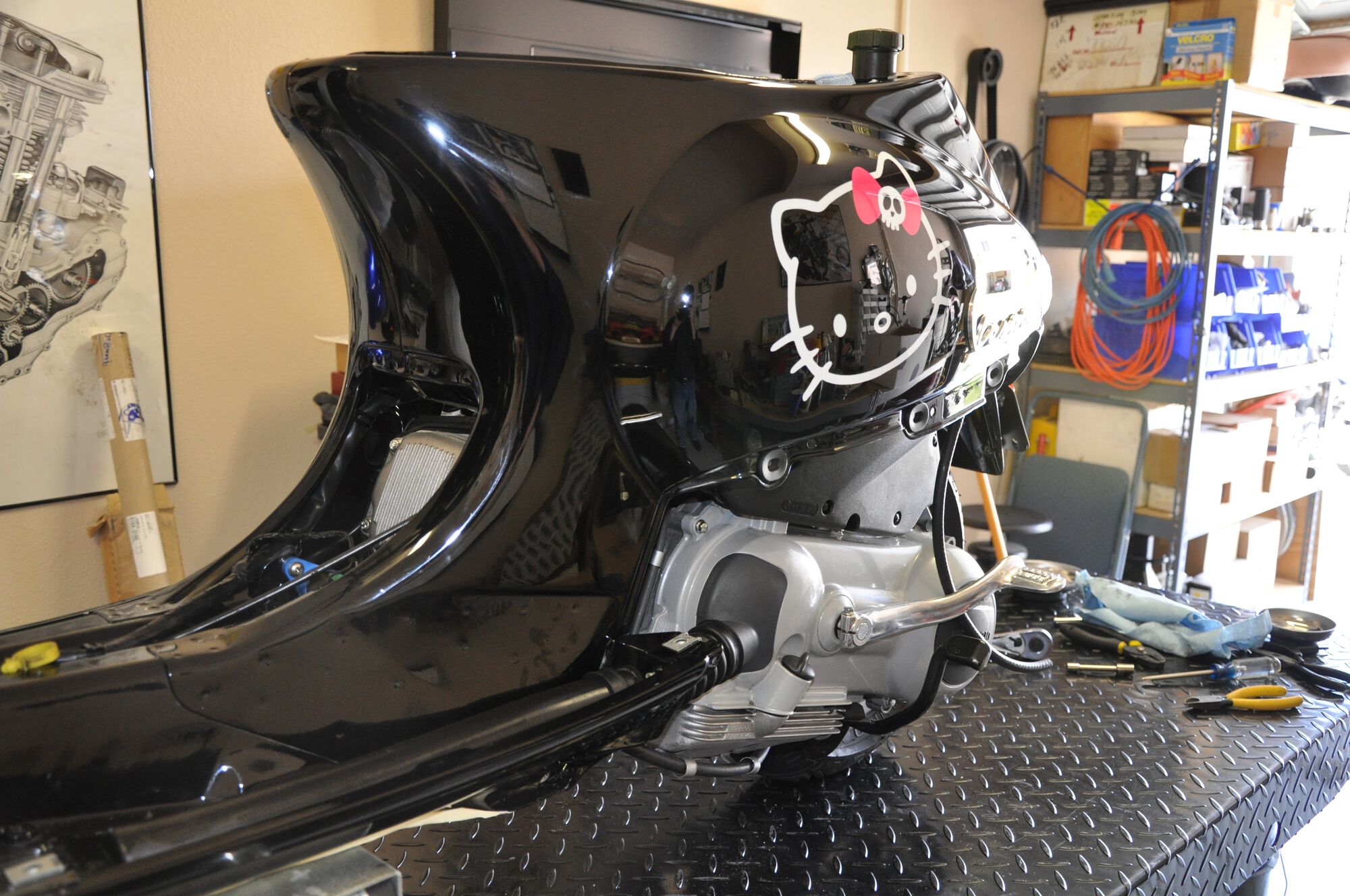

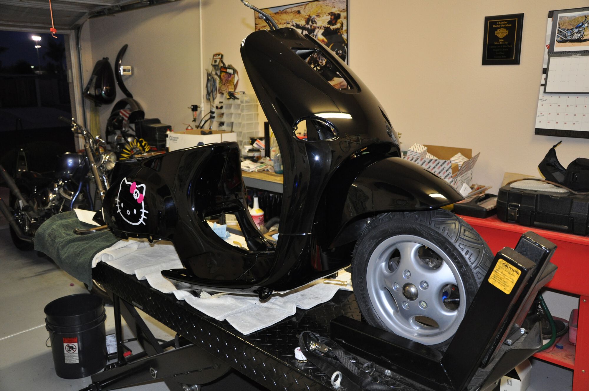

Best experience I've ever had with a painter. I get regular photos and communication on status.

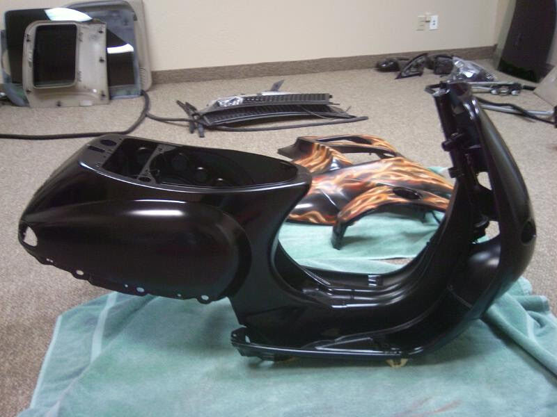

The scooter was shot with black today (no clear yet so it looks dull)...

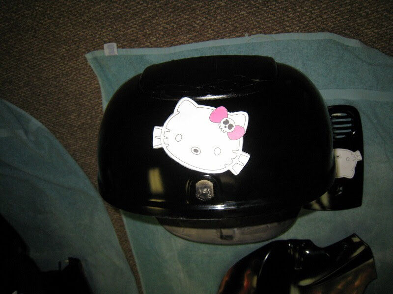

Here are some "mock up" photos for the art work.  Just printed on white paper and taped in place so we could review and give our approval.

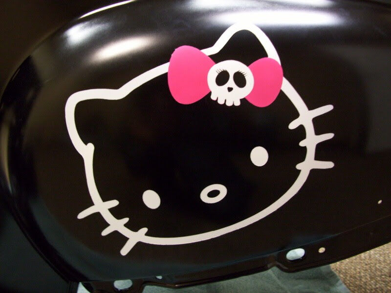

Starting to get some pics from the painter of the graphics. No clear has been laid down yet.
Horn cover:
Horn cover:
Left side cowl:
Left side cowl:
Bow and skull detail:

Looking great, and love the skull bow!!!

The final graphics were added to the body of the scooter today. All that remains is the clear. That will be done next week. Should have the finished parts back to start reassembly by the first weekend in May.

Awesome job !!!

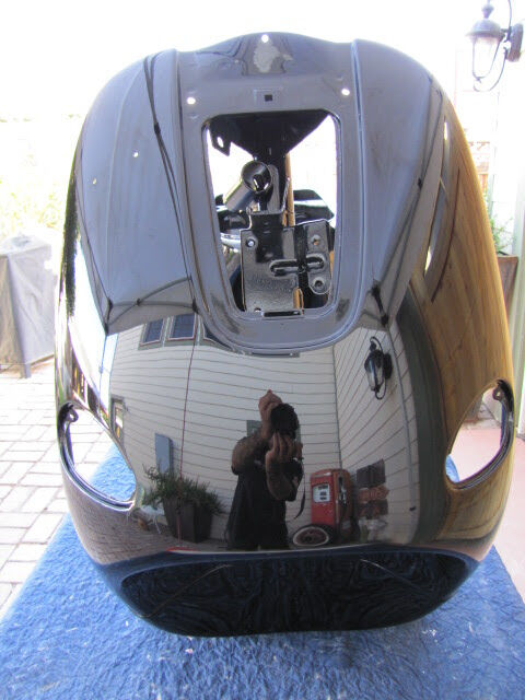

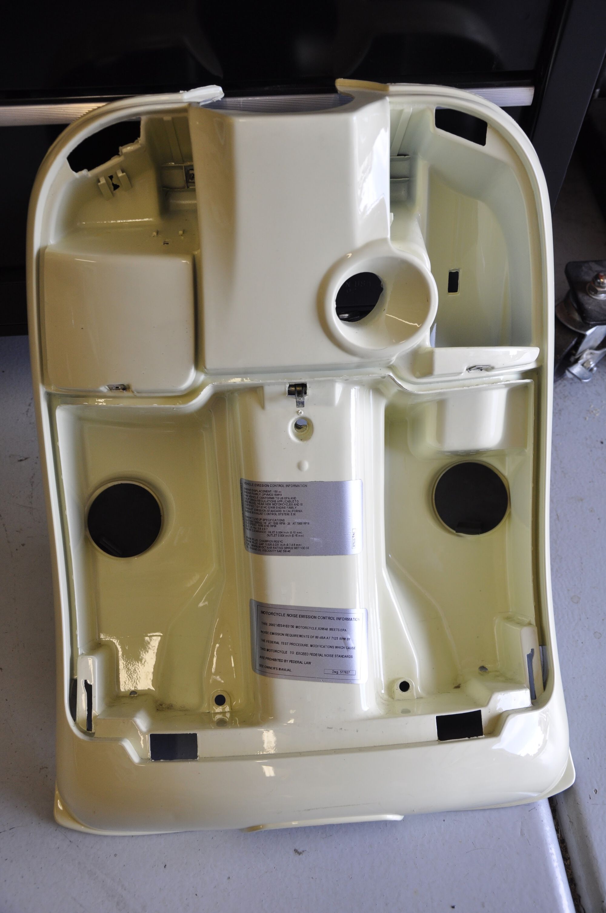

Minor setback yesterday. The painter sent me these photos of the horn cover. While he was buffing out the clear the heat caused the original Vespa factory paint to release from the plastic. You can see he was able to peel all the paint from the plastic. The black stuck wonderfully to the original paint but it looks like the plastic wasn't preped very carefully. He'll need to re-black and then redo the graphics and clear on this part again.
EDIT: unfortunately the photos of the peeling paint on the horn cover have been lost.

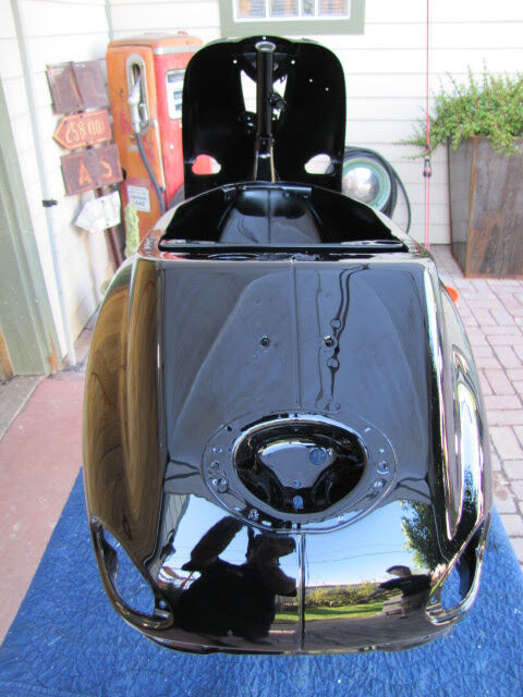

The body of the scooter looks real nice after clear.

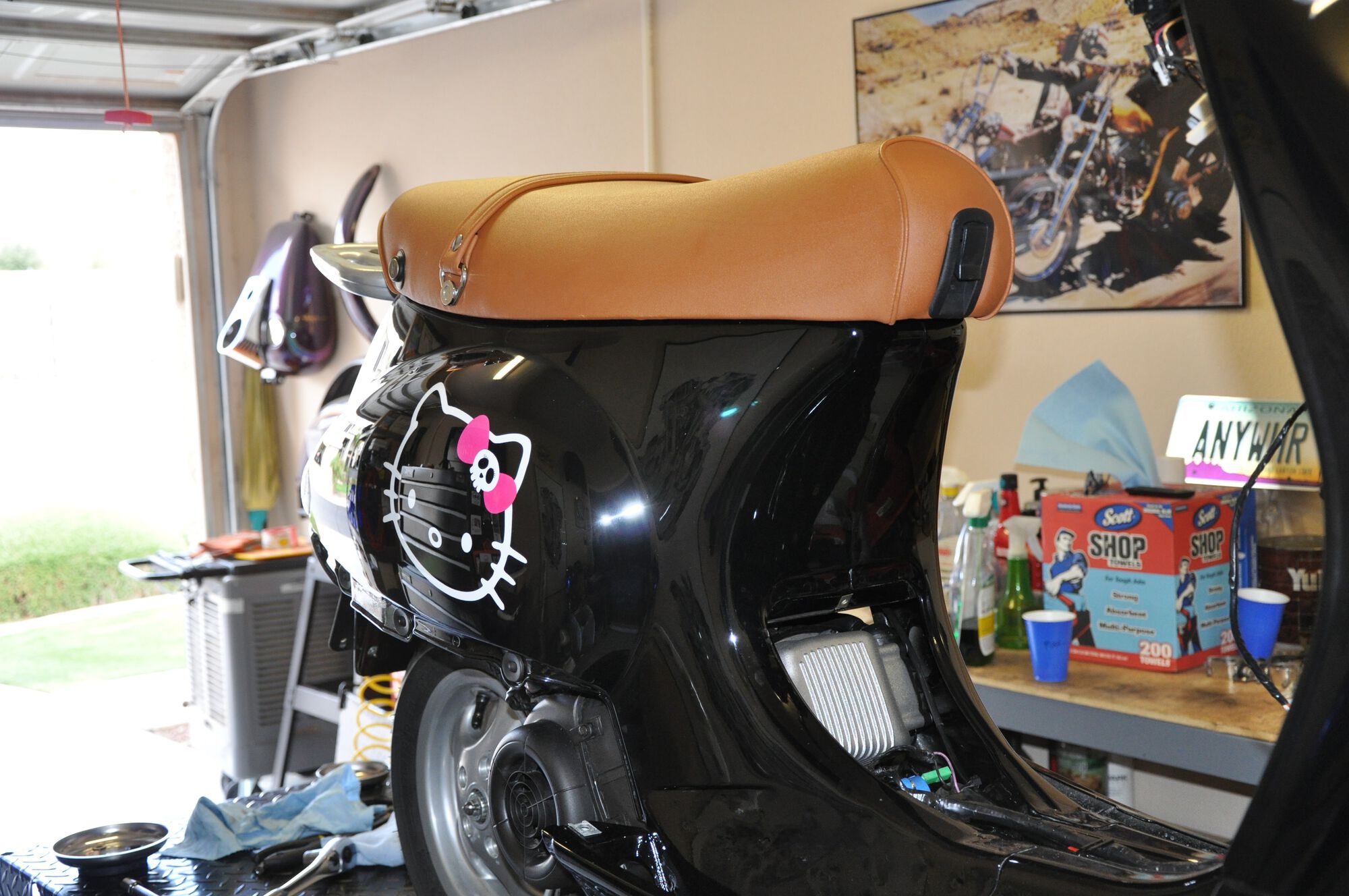

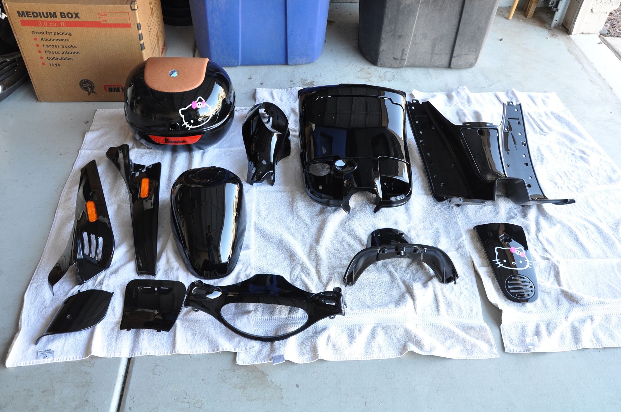

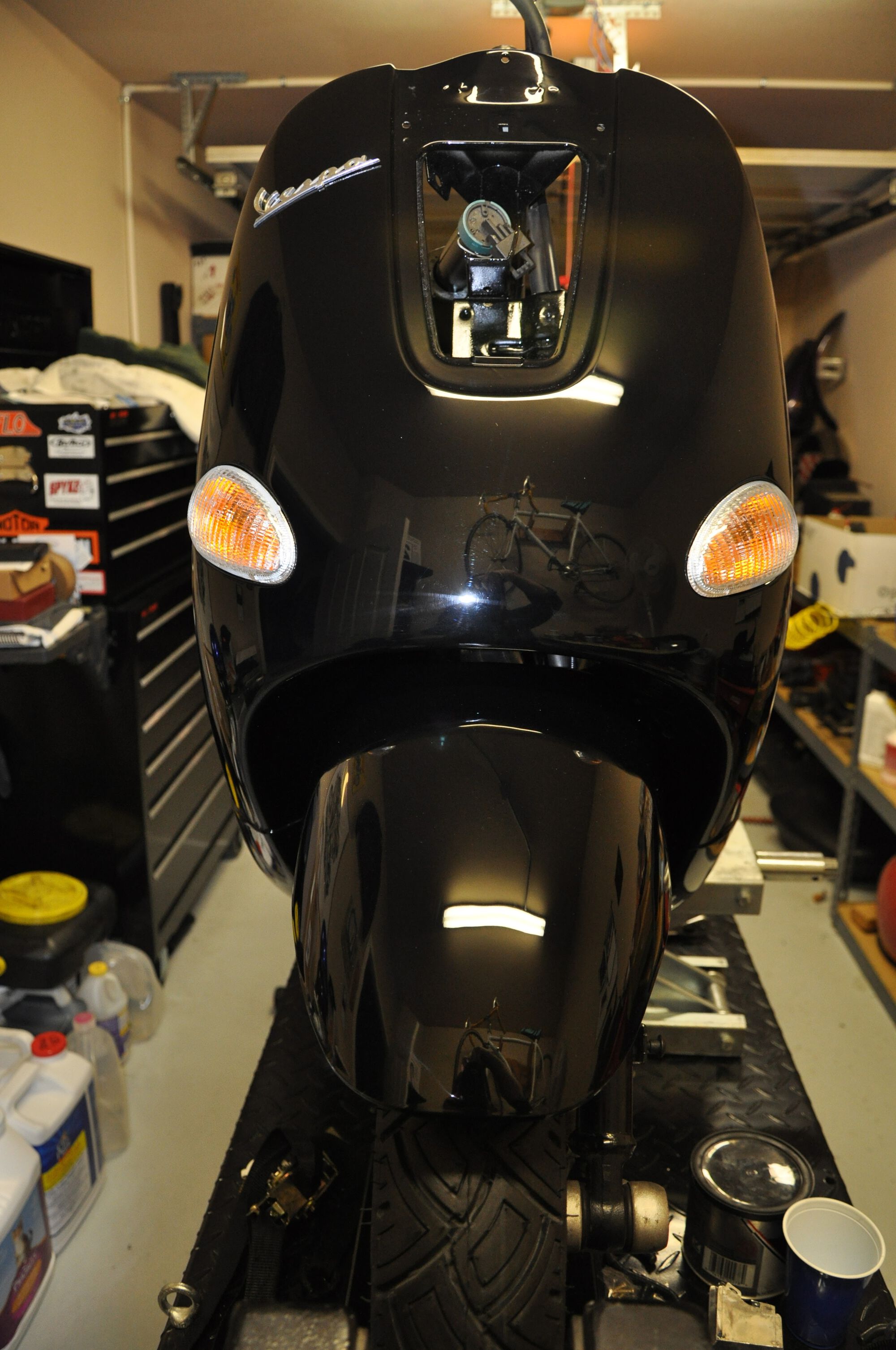

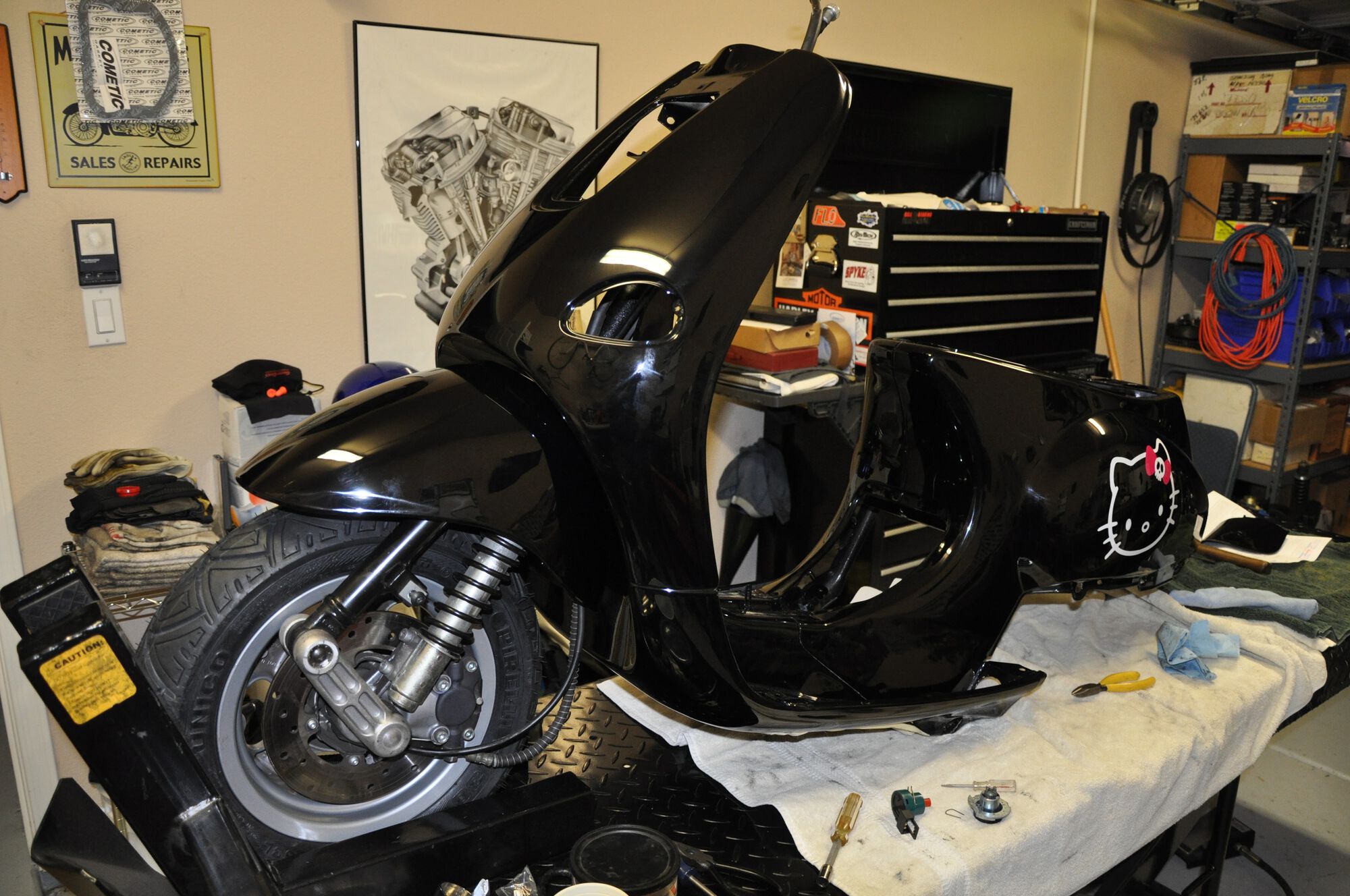

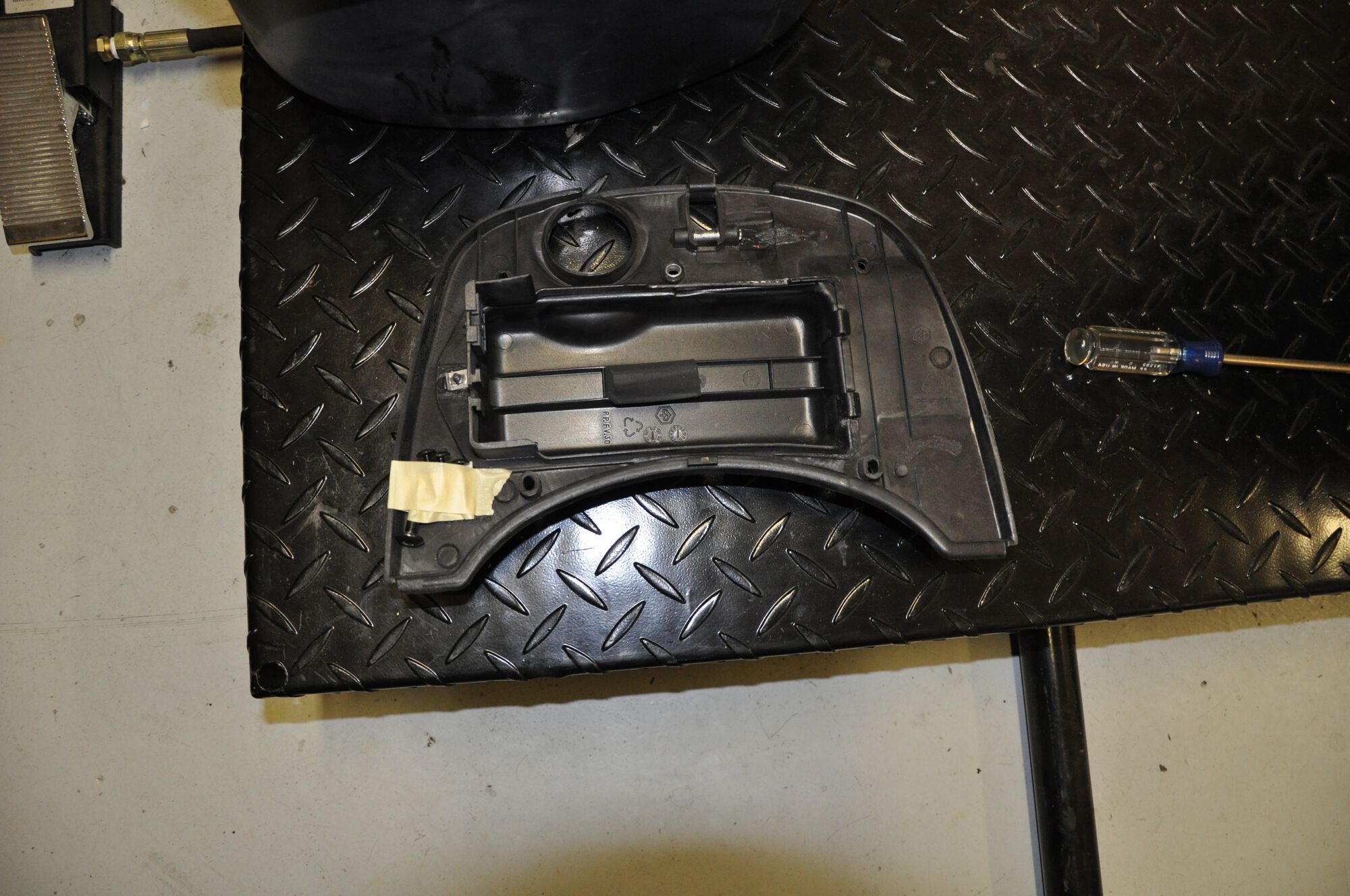

All the painted parts were delivered today! It's always exciting to see new paint arrive. The black came out sooo nice. I laid out the small parts on some towels in the garage and put the body on the table lift so I could begin the reassembly process.
Also installed all the rubber boots in the body and the 15 or 20 clips that various bolts/screws attach to. I had taken lots of photos of the clips during disassembly so I would get all the clips back in the correct spots. I did my best not to mar the paint with the clips, but it's impossible to not do some amount of scratching. Luckily the way the clips work, it's all hidden.
That's enough for tonight. I'll pick it up again tomorrow.

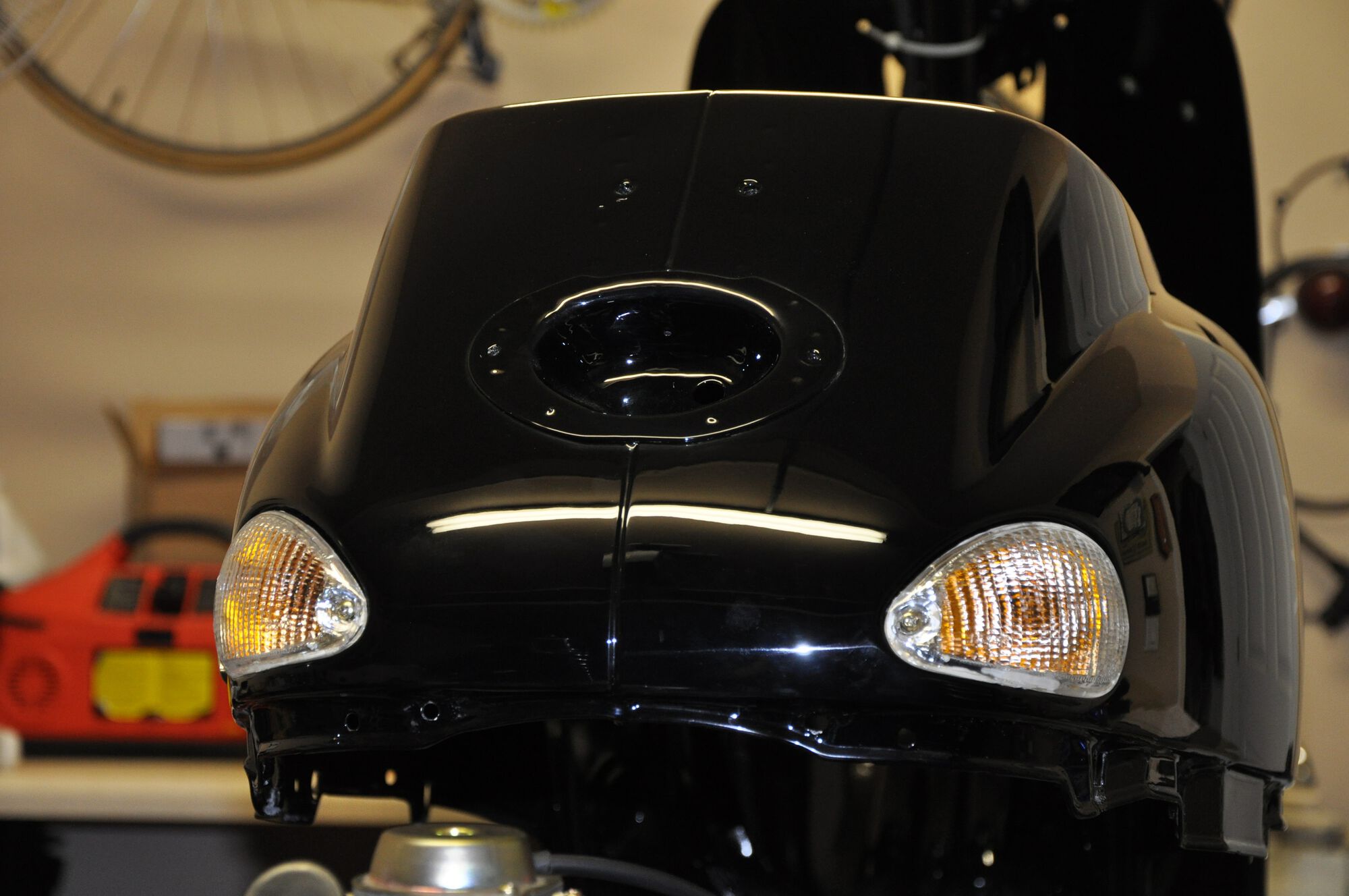

The first order of business was to assemble the front end.

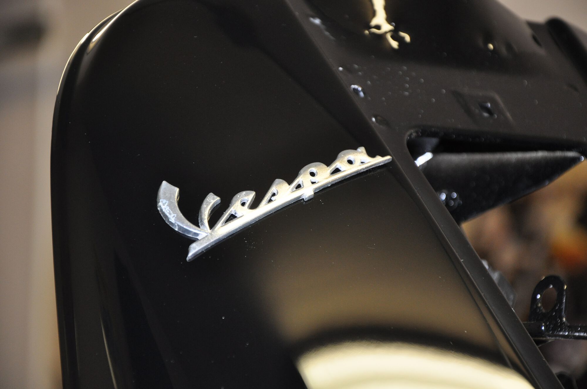

Installed the badges on the body and some clear turn signal lenses.

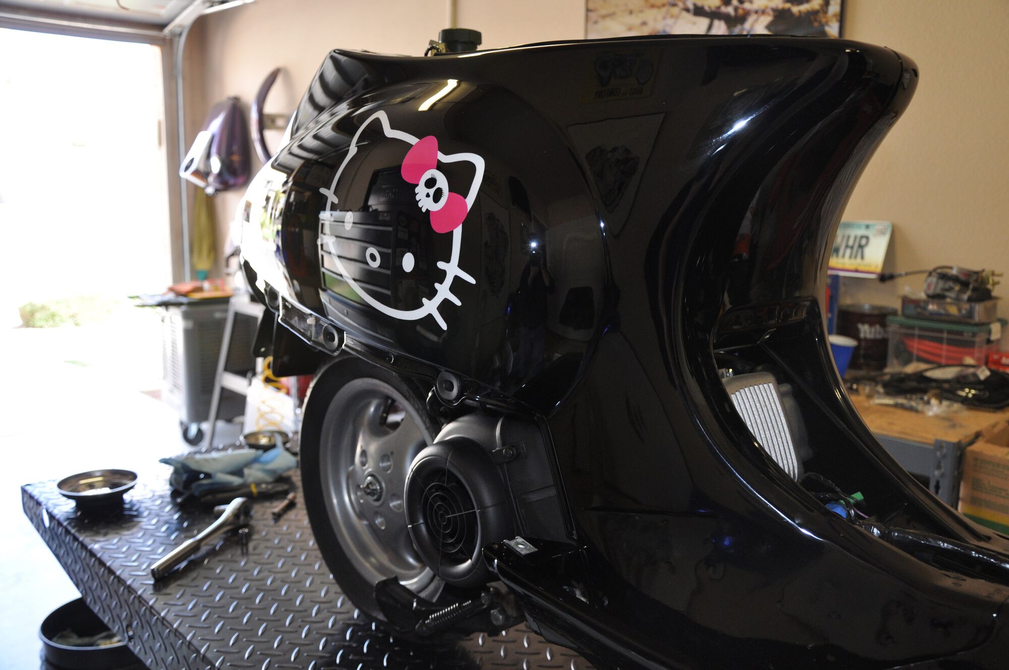

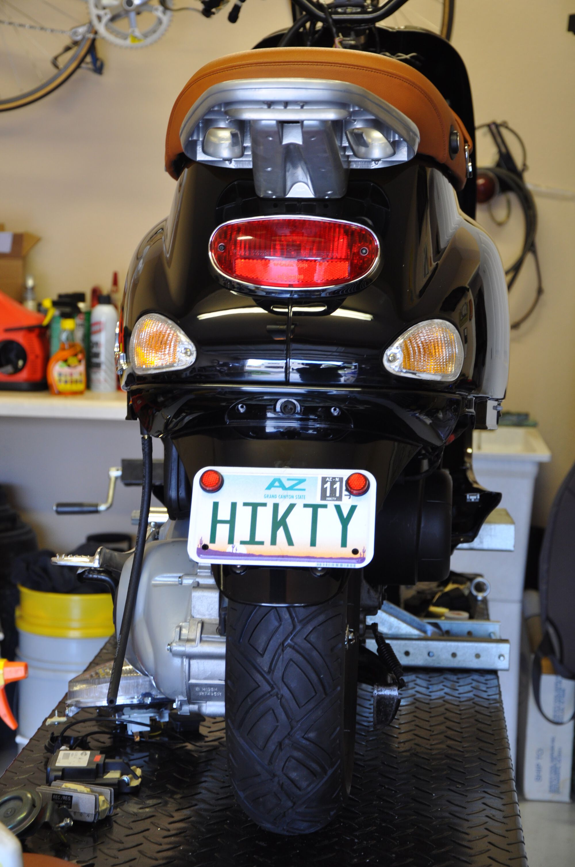

Worked on the scooter for about 5 hours today. Got the drive train back in the bike along with the wiring harness, throttle and rear brake control cables, handle bars (but not all hooked up yet), rear rack, rear lights, battery box, and the breather "snorkle". Still need to hookup the bulk of the electronics, do some wire management behind the glove box, assemble the headset (gauges, handle bar controls, etc.) and a whole bunch of miscellanious tasks. But it's starting to look like a Vespa again.

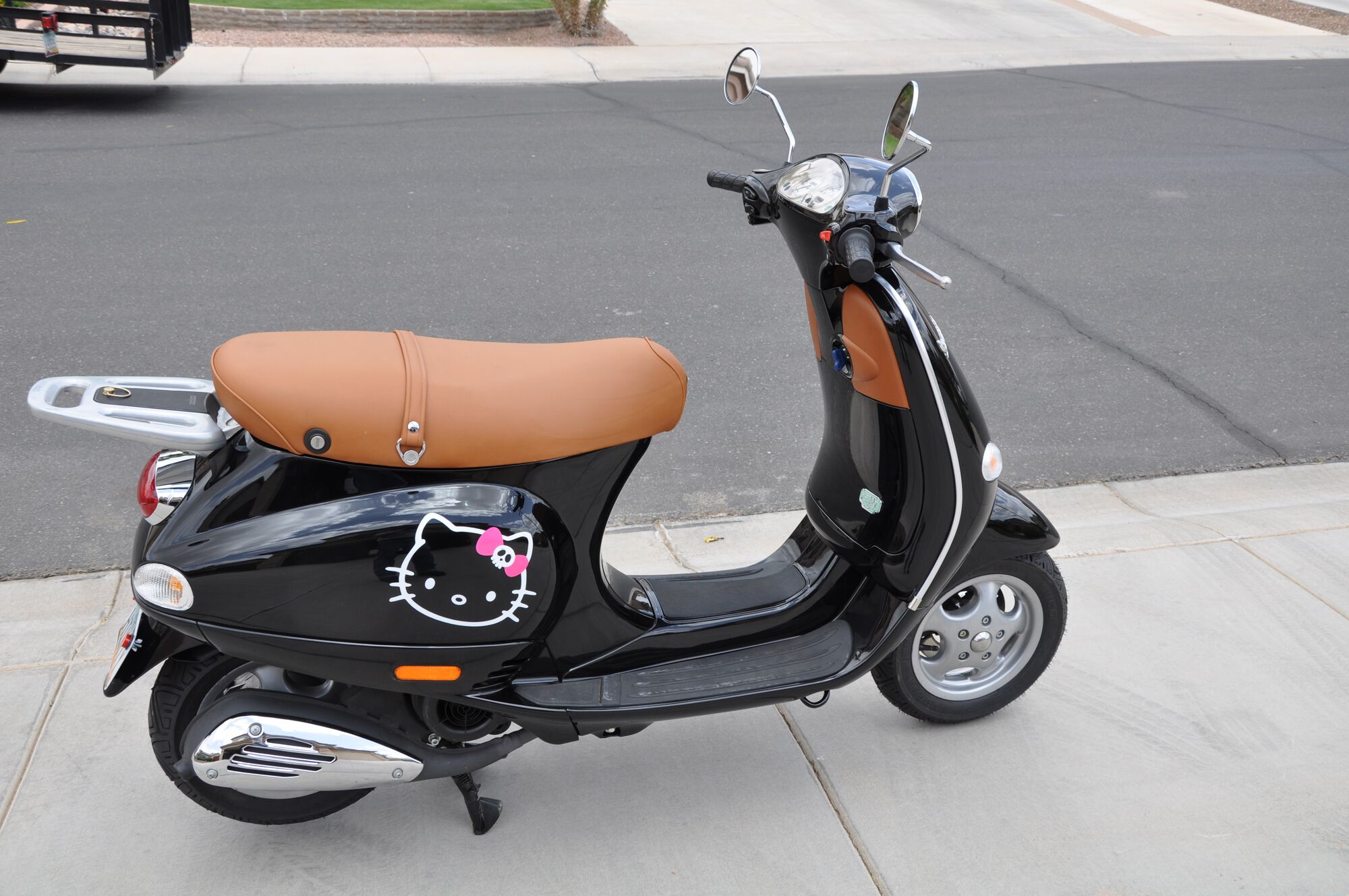

Ok, the repaint project is completed. The bike is back together and the test ride is completed. Here are some final pictures. This was a lot of fun!
