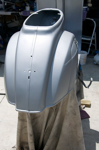

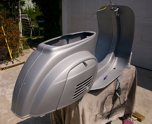

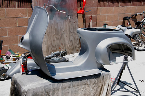

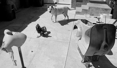

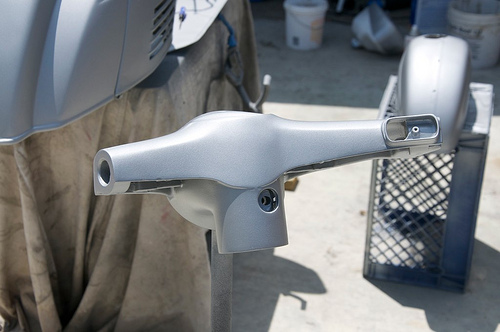

Here is the body.

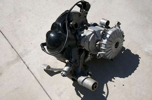

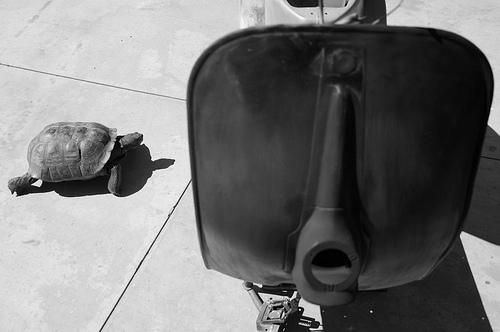

and the engine

50 to 125 you need:
cyl kit*
cyl studs & hardware
125 shroud
crank
primary gearing
on the cyl kit, you need the complete deal-- including the head. and if you're going to get a kit you might as well bump it up and get a performance kit like a DR, athena or olympia.
on the primary a V90 or 100 sport or 125 should be fine
crank, the V50 electrics and flywheel are small taper, so you'll be fine with any small taper cranks. i'd recommend a mazz or something decent.
you'll also want to upgrade your intake/carb and exhaust. depending on what your budget is and what kit you are running you can go with stock 19/19 pieces or aftermarket and pretty much any pipe will work.

The only difference between the 50 special engines and 125s is the crank, top end and cylinder studs. Everything else is basically the same. If you end up needing some stuff im selling off a lot of my smallframe parts, since I don't own one anymore. I have a 125 crank, cylinder studs and some other bits, instead of getting a normal 125 cylinder id reccomend the DR135 kit, its a modest boost in power, bolts right on and is pretty close to stock. You'll need a different exhaust when upgrading from the 50 top end as well. Most people go for the polini "kidney" exhaust, its cheap and effective.

I am trying to get this engine running, The wiring doesn't match up. I expected so much (being that I have a vma2 and a 50 special engine), but the wires coming out of the flywheel don't match the colors on the 50 special wiring chart. I do have a 50 special engine (for sure). I am wondering if aftermarket stators have different color coding?
The wires coming from my stator are green, yellow, beige and black and I have the normal Primavera wiring harness. Does anyone know of a link of that can help clear up what color goes to what other color.

Almost done painting the vespa.
Couple more coats of paint and some coats of clear, then she is ready to be put together.
I am happy with the outcome so far.

Nice work. That frame looks like it's in great shape.

Thanks.
It was a lot of work. A lot of work.
Definitely would have been better off taking it somewhere and paying to have it painted. All the odds and ends and crap ended up costing me more than a pro job would've cost.
I just want to ride this stupid thing.

That's looking really good. That frame is very straight for its age.
Keep the pics coming when the clears on, that will be a nice shiny thing.
