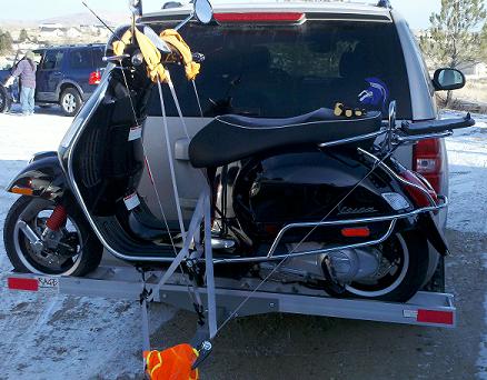

This is how I got my Vespa home (850 miles) on this rack. I was hesitant at first but it held fine. I used 6 rachet style tie downs with soft rags where there might be some rubbing. I know it looks sketchy but it worked great. The rack is from Summit Racing Equipment in Sparks, Nevada. I think I paid about $250. Only drawback is you need 2 people to load it...

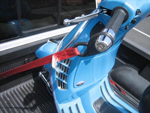

I just added the Jettin Industries Tie Down Bar Ends to my GTS and used them on my 400 mile round trip back and for the Corbin for my new seat. These things are GREAT ! Cheap insurance against damage. Held the Scoot in place like a rock. They look pretty bichin too. See pic below from their website.
http://www.jettin.com/ProductBarEnds.htm
bad thing about using these as tie down points is there is just 1 6mm screw holding them on the bars. not very strong for holding a 400 lbs scooter and the forces being pulled on. you'd be much better off with a set of canyon dancers.
With some chock designs you could darn near trailer without tie downs.
