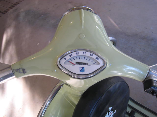

pic of speedo

Hello,
I checked on the Indian Scooter Owners Club website for you. You have a 1964 oval speedo type Bajaj 150. Made in India from about 1963 but most come with a round or vlocano headset. I prefer the look of your speedo. The motor, though Indian built is a stock VBA 3 speed with 5.5bhp. You can replace it with any subsequent large frame motor but will have to change the front end to 10" if the rear wheel is 10" of course. You can't just stick a 10" wheel in place of the 8", you'd have to ask for more advice on this forum. The motor is a 2 port so if you rebuild it it's difficult to get significantly more performance. All the Bajaj models up to and including the Priya,made from 1975 onwards have the rounded rear end. I think it's cute, myself. Don't worry that it's Indian built.Many Indian imports have never seen much rain so the metal can be like new. I'm told it's not the best steel, but is a bit thicker.
Andrew.

Forgot to mention. It would have origionally beenbadged as a Vespa so you're not been conned there.

Sorry Dsdayln, I meant the origional posters scooter in my posts. If you have an Indian built machine then either post the VIN here or PM me and I will find out what I can.I joined the Indian Scooter Owners Club thinking it was alive but it appears to be dead.I can still access the members only pages, though. So I can find out all sorts of information on Bajaj built scooters.
Andrew.

Update on the scooter from the original post
I'm now better educated. I bought this scooter from the second owner since the original post on this forum. It runs well and is in relatively good shape from what I can tell. It is an Indian built Vespa 150 based on the VBA models built by Piaggio model years 1958 to 1960. I believe it to be a 1964 model, sn V40211T11946. I don't know what was done to it since the original post, although it appears someone has changed the speedo as it is not an oval as most information indicates it should. If you look close at the speedo, the lettering is hand painted. So I guess I own an Indian Bajaj and now I know.
Speedo

I believe your VIN should start with V462, not V402
It's possible someone switched out your headset. If I can't find a volcano speedo, I will consider swapping out the headset since Vbb speedos are easy to find.

Update SN
Zeno
From information I found at the Indian Scooters Club website, vins for the Bajaj 150 started with V252, V402, or V462. The V402 is on the frame and listed on the California title.

Zeno,
your scooter is a Bajaj built Vespa 150 with a 2 port motor like a VBA. My VIN starts with C04, This means that mine is not a Vespa 150 but would have origionally had a Priya badge on the legshield which has been replaced with a Vespa badge when it was restored. The Priya was built from 1975 0nwards by Maharashtra Scooters who still make castings for Bajaj bikes like the Avenger. Bajaj own a share of this company. As I've said previously I've been too busy enjoying riding to take the top end off, so I haven't looked at the barrel. My info. comes from the ISOC members only section which says it is a 3 port. It certainly cruises at an indicated 50mph on the level, so I feel sure it is more than 5.5bhp.
So if we are being picky then your description of yours as a Priya is not totally accurate. Hardly a hanging offence, though!
I'm sure that if you got a Priya badge from somewhere it would fit straight on to your legshield without having to redrill it. I expect your top badge will be an oblong, where mine is hexagonal. That too has been replaced with a Piaggio on mine rather than the origional Bajaj.
I'll look up the VIN of the other guy's scooter now to confirm the year.

Dsdaylen,
I can confirm that your scooter would have been built in 1964 and origionally badged as a Vespa with Piaggio badge at the top. It would have origionally had an oval speedo but it seems to have been Italianised!
