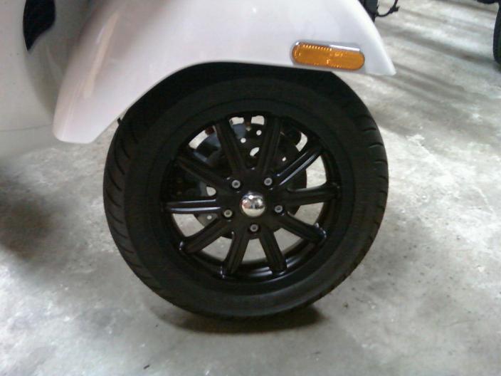

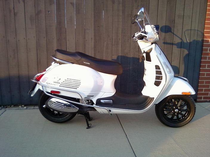

Look for VEZPA. He has the black ones on his white GTS 300 Super. He has posted several pics on the board.

@vezpa avatar
Posts: 4134
@vezpa avatar
Posts: 4134
Cajun Critter wrote:
True to what Jess said, the wheels are expensive...try to find someone who is parting out a bike.
Compared to a GTS Super wheels the MP3 wheels are quite cheap. The GTS Super wheels are Grimecas. I sold my Super wheels on ebay and completely offset the cost of the new MP3 wheels. It was a wash.

@elvispa avatar
2027 GTS Super 310
Posts: 864
Location: Pac NW
Nice Lookin' Wheels...
Any thoughts on the relative weights of the two wheels??
