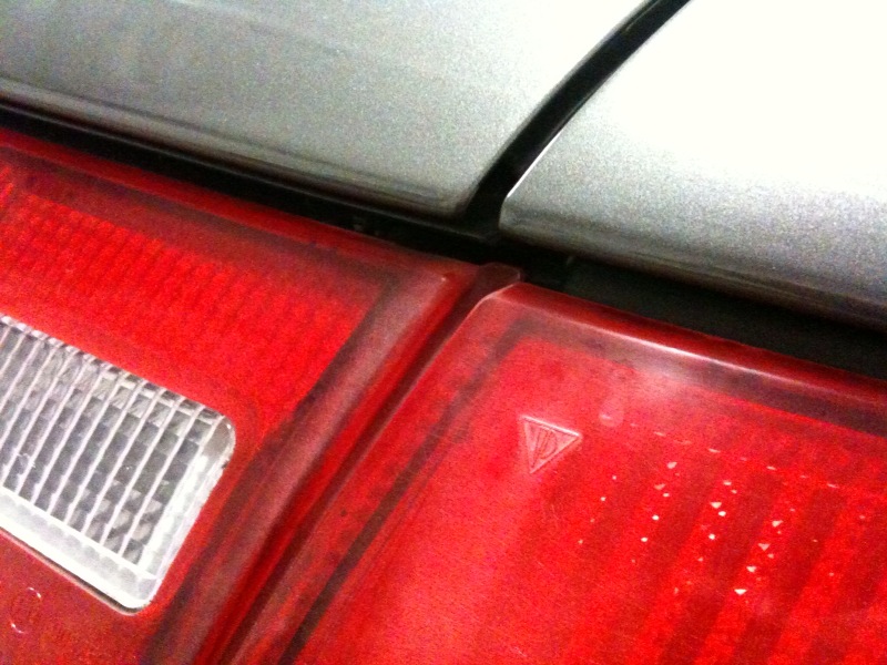

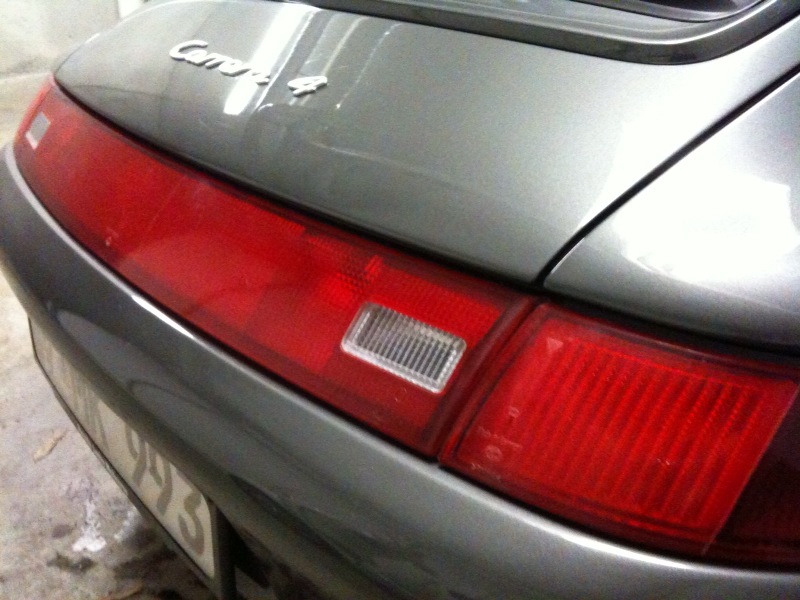

Does anyone know if this kit would work on the tail lights of my 1996 Porsche 911 - they are not faded but a couple of areas have dulled like they have been polished with a cutting compound (I had my engine lid resprayed last year).
Replacement rear light clusters are about $300 each here in AU, and I would need to do BOTH and possibly the red centre reflector as well so they all matched, (this would be over $1000) so the option of polishing the taillight would be a good one.

here are two pics, you can more easily notice the slight hazing between the RH indicator and the centre lens. Its only slight in these pics, but the hazing looks more obvious in sunlight. Looks like the 3M product will be well worth a try![/img]

msap, that is exactly the kind of crazing that prompted my getting the kit and giving it a go. Mine was much worse, however. You may not need to use the coarsest of grits in the kit, and I'm confident you will be pleased with the results.
