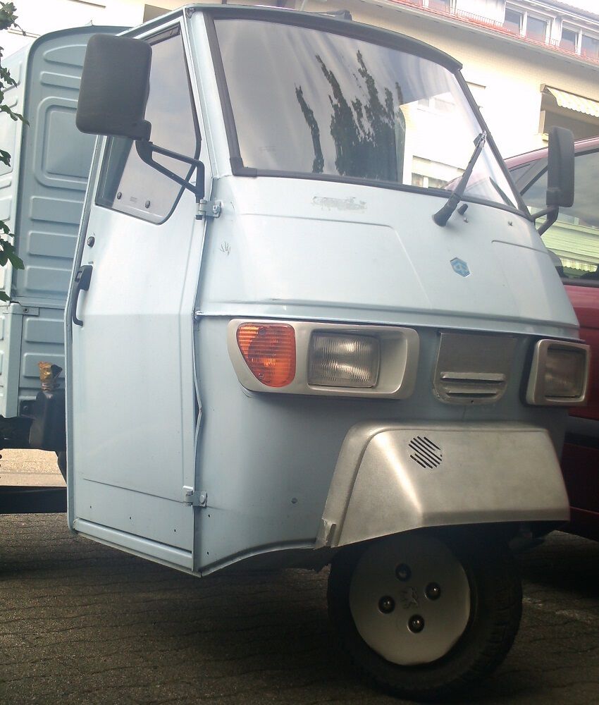

Hi. This is my first post here. I couldn't find any introductory thread. If there is such a thread, I'd be thankfull for knowing.
I've got an Ape 50 needing a front spindle and ended up in this thread, searching for updating to either a telescopic fork or an alternate, until finding out that Lambretta forks would work.
Despite Lambretta forks being mentioned here as not anymore robust than Vespa originals, my intention was to rid of the needle bearing system on my Ape, unless there's a spindle type available which has a replaceable bearing race bushing, so that if the bearing wears out, it doesen't take the entire spindle with it. If not available, the Lambretta design places the load onto both individual wheel bearings which can obviously get pressed in and out.
Of course, a fitting telescopic fork would be the best way out.
As with bicycles, thread-cutting dyes are also available for our vehicles' forks, if there is a need for lengthening these threads, in order to bring both steering bearings to their rightfull adjustment.
Given that Apes don't require fenders, alternate forks of all types would work.
Here's my Ape with a temporary air duct covering:
