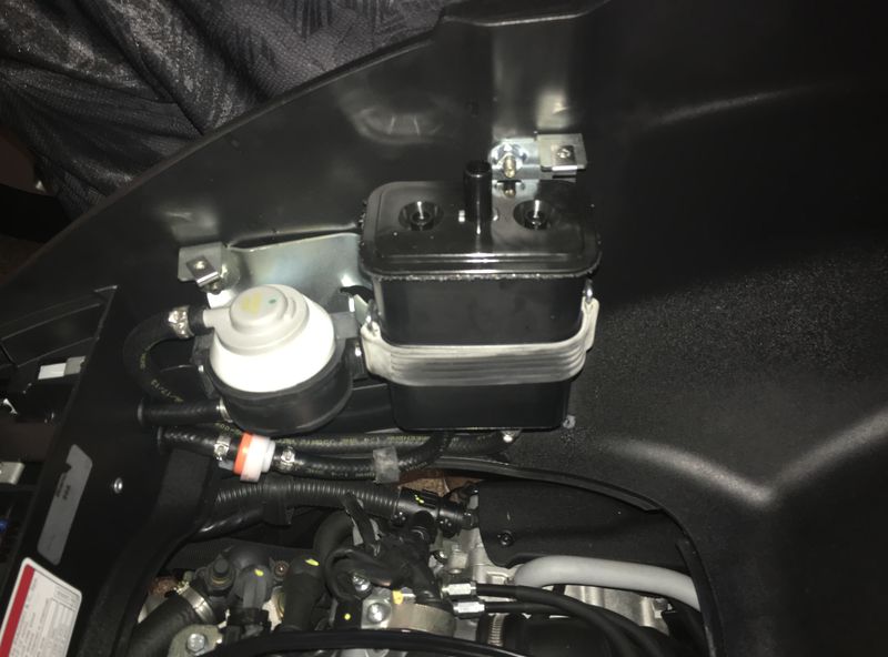

For the 2015 bv350 it's fuel injected. The system looks a bit different than the image above. It looks like a line comes off the fuel tank to the roll over valve to the canister to the throttle body.
Ive seen some people block off the line to the throttle body and put a filter on the fuel tank area.
Ive also see someone block off the throttle body and the fuel tank line and drill a hole in the fuel lid.
Talking to my buddy he said get a one way check valve with charcoal in it then connect the throttle body and fuel tank line with the check valve in line.
So much info out there what do you guys think. Below is a image of the setup. In the bv350 the evap takes up like 30% of the under seat storage and makes stuff under the seat smell like gas.

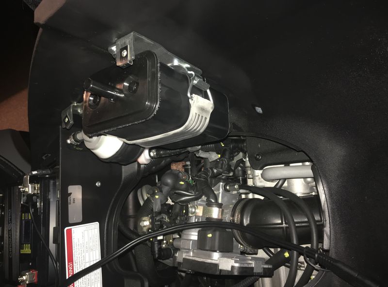

Severl Scooters
Posts: 113
Location: Orlando
Severl Scooters
Posts: 113
Location: Orlando
More pics

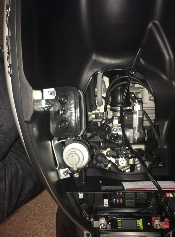

Severl Scooters
Posts: 113
Location: Orlando
Severl Scooters
Posts: 113
Location: Orlando
Additional photos

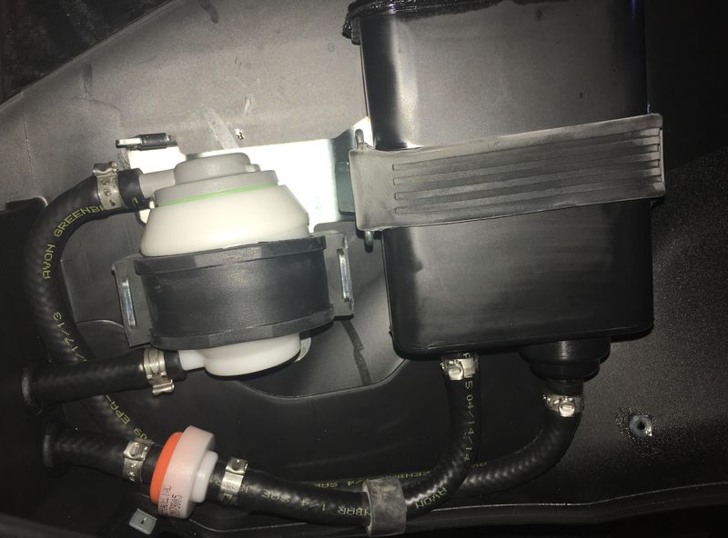

Severl Scooters
Posts: 113
Location: Orlando
Severl Scooters
Posts: 113
Location: Orlando
Even more photos
As the gas tank on a BV350 is located much lower than on a Vespa, the evap system is even less prone to any problems than the Vespa system. In 4 years experience with a BV, the system performed as designed. I seriously doubt there is any performance benefit to disabling or removing the system. Now, if your objective is to gain a bit of room (not 30% BTW) in the underseat area......
