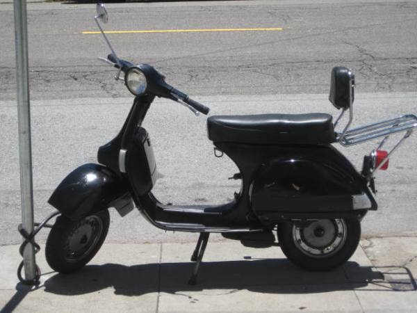

Here she is... got a sweet deal $1300. Put my bbq rack on and shined her up... she runs awesome.. couldnt be happier thanks guys for talking me out of that 125... 8)

nice - dig the black!
it looks like the rack is levitating - do you have the support arms?

haha yeah i just put the support arms on.!!! took the pic midway through installation

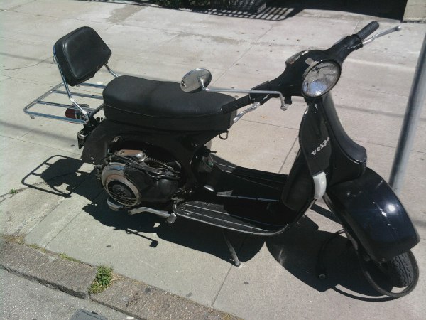

New BBQ Rack
There we go guys..!! the support brackets are installed..

That BBQ rack aint sittin right... the rack should sit fairly horizontal. That looks like a smally rear rack like that Laughing emoticon And the back rest was then bent to compensate...

actually I tried to install a BBQ rack on my P200 and it looks like that photo also...I couldn't get the rack to sit horizontal. Anyone know what the problem is?

Well I don't disagree that your's is special Razz emoticon But every photo I see of a BBQ rack it is horizontal. When I tried to install mine and it wouldn't go on like I was expecting it to, I gave up and it's waiting for me to spend more time to figure out what the problem is. My BBQ rack came with my P200 and the rack was taken off for shipping, so I know that the rack is for P200 fitment and not something else like a SF. So I'm assuming that the problem is the installer's fault (mine, and maybe DominicLNanni has the same problem).

find airfin in the member search and have him measure the uprights
i sold him one that sits right

Yeah Dominic's do look long - mine are about 13" from bolt hole to bolt hole (maybe 14" from tip to tip)

ok, i remember now
most folks mount the bracket in the same holes as the us spec tail light assembly, which is correct
but i do remember some folks placing the bottom bracket near the base of the frame, like around the tag area
i have found weird holes in that area before
with your taillight you want to find shorter uprights so the bracket stays behind the light in the holes that were factory stamped for the light
make sence

You can also see from the photos that if the rack is horizontal, the backrest is actually in a reclined position...and when the rack is inclined, the backrest is vertical. So it looks as if you can either have a level backrest, or a level rack but not both! I think this was the problem I was running into also

Someone musta bent the backrest then over the 30 years

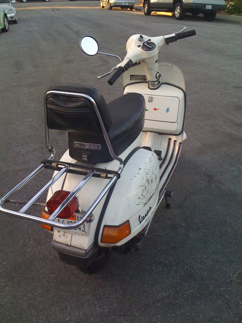

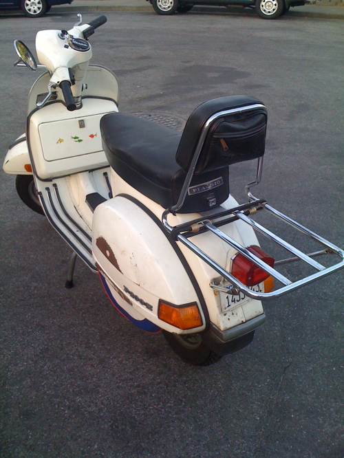

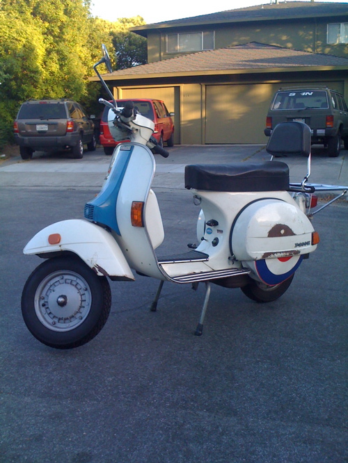

here are a few shots of our P200 with the rear rack for reference

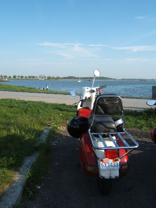

and mine just to show it off Too bad my rear rack broke and needs to be welded...

dude now looking at that picture my bbq rack looks retarded haha..!!! I need to get shorter brackets I think... Im going to go and measure them right now... because my seat doesnt even close right....!!

nicky, great reference
same two rung even
mine was three rung in the middle type

ok... so my supports bars are 14in long... I guess I got the wrong ones..... where can i get the right ones..!!? Barry at SFSC? Thanks guys. I am really happy with my find... she is really a great bike.... I cant wait to get her registered and on the road.. first stop golden gate bridge vista point to get some sweet shots of her..!!

Yup - hit up Barry
about a year ago I picked up a rack from a guy on CL and was missing 1 bracket - went over to Barrys and looked through a box of rack pieces he had.
