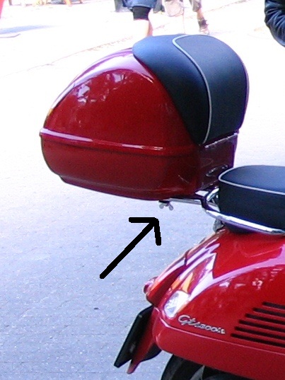

I have been looking for a rear rack to mount my Vespa Topcase onto my 300 Super, via an other solution than the GTS250 'folding' rack construction.
I want to be able to easily detach the case...
AND
I want a slim looking rack when case not fitted...
Recently I came across this one and it looks just wat I need!
Very much a chrome version from the GT style fitting.
It looks genuine Vespa and not too expensive too!
Any experiences?

No experience with that one, but someone in my club did get a Faco one I believe and it never looked that sturdy to me. It make the topcase look like it was falling off the scooter as it angled down and away from the bike. Cat is the one who had that on her Super 250, she eventually got a Vespa rack.

@sakkerju avatar
Posts: 1347
Location: Europe
@sakkerju avatar
Posts: 1347
Location: Europe
I have bought the rack mentioned above. Although it is meant to carry a LX topcase (!!strange!!) on a 300 Super, a GTS topcase fits nicely too.
It takes 3 screws to detach the topcase in a 'blink of an eye'
Without the case attached it is a slim looking rear rack!

Is this alternative rear rack actually easier to take off / put on the top case?
Thats kind of what I'm going for as well. Seems the OEM GTS 300 top case rack / connection hardware for the Vespa top case is almost an afterthought.
Despite the top case having these built in notches (one in back and two towards front) the standard rear rack doesn't seem to take advantage of them at all and instead requires you to mount this little black plastic "clip" that the top case then screws into. I had to look at another Super 300 I saw parked last night just to figure out how it all goes together because it is not intuitive at all.
The rack is designed to fit a smaller LX topcase on to the GTS300. I don't know why the came up with that idea, but that's what it it is...
With the LX case the mount/demount is easy by simply screwing out the centre screw and unclamping the box in one go.
I use it with the genuine GTS case, this makes a close fit like the LX case, but not 100%. That is why I had to make minor adjustments.
Leaves me with 3 screws to detach AND a much slimmer looking rack when the case is detached.
Indeed, the original GTS250 style mounting with the additional plastic clamp around the folding rack is sturdy but a laugh...Piaggio should make a rack lik the one above to 100% fit the GTS top case

cereal boy wrote:
Sakkerju, that's a neat solution. Are you running a GTS box or a GTS Super box on that rack? Are the GTS box and the GTS Super box identical from a fitment point of view? i.e. are they just different cosmetically? I would like to use that style rack on my Super with a Super box. Thanks for any advice you can offer....
Both GTS250 and 300Super cases are identical. Except for the backrest cushion, those fit with each of the seats
The rack is in fact for the LX case, but it does fit with a little tweaking and the case is easy to (de)install.
I am also using the front two holes with a self made clamp as additional support. Just in case when I am riding with a passenger.
