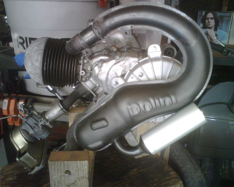

oke, i would like to ask about exhaust, i have a Super '69 with 24/24 carburetor, and thinking about getting an aftermarket exhaust for it. im assuming just like a car, you wouldnt get much of performance gain in terms of hp. however it would ease the flow of exhaust out of the chamber, would you agree?
Second, i see a lot of people like the Sito+ exhaust. Anyone care to share why they like it?
Third, its rather hard to get my hands on a Sito+, however i could get a Polini and Malossi exhaust. Anyone has any experience with them?

Well, it won't work like it does on a car uness you have a two stroke saab or some old east european trabant with a two stroke engine:
On a 2 stroke, the right exhaust can increase your hp considerably.
A sito+ would work nicely, but the super has small wheels, and you might have trouble with the sito+ touching the ground on left hand turns.
The polini is noisy (abit like the car in the video). You loose power in the usable revs in the middle and gain a teeny bit of power on top. If you can get hold of a simonini exhaust, its not too bad. Still a noisemaker, but way better than the polini.
If you can get hold of an original PX125 exhaust, that should help quite a bit. Performance is in between the original super exhaust and the sito+
Other than that, a proper expansion chamber (like the ones JL makes) is among the best you can get. But then you'd sort of need a new cylinder as well to get the most out of it.

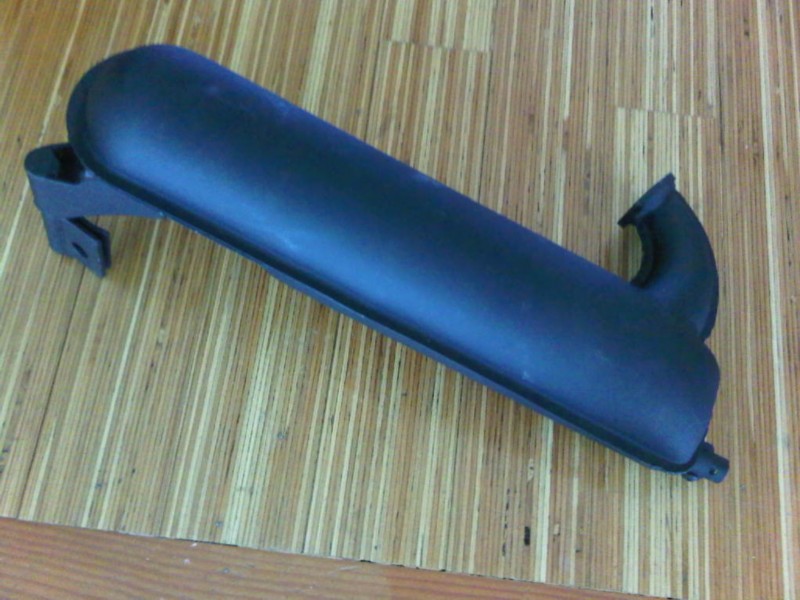

+1 Eric, I put a Sito plus with a one bigger up-jet in my P200. The mod was just to get it to breath better as you explained in the past. I'm happy to report no problems with it. And yes more umph ! up hills and in third gear as well. I recommend this Slight mod. to all 24/24 owners.
I have another Sito plus around here somewhere that I drilled the underneath hole up a bit so I could get it as close to the frame as possible on my Rally. After I break in the rebuild I will be popping it on, maybe by fall. (I hope)

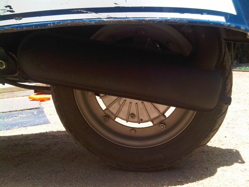

i went from this to this and am so pleased with my descision
@rover_eric avatar
Posts: 6980
Location: Detroit, Michigan
@rover_eric avatar
Posts: 6980
The standard ET3 banana pipe is the best smallie pipe IMHO. Nice choice, Jimmy.
what kind of exhaust is that on the bottom pic?
nothing at all
Posts: 9656
Location: westla
nothing at all
Posts: 9656
Location: westla
helvetica wrote:
as eric mentioned, a stock sito et3 pipe
can order from motorsport san diego or sip in germany
the best 90 bucks i ever spent

i love my Sito+
i have put the Sito + on two of my bikes.
the first was the much loved handlebar frankenbike. i put a 20/20 carb from a LML engine (105 jet i think i ended up with) and i can tell you for sure it has Alot more power than before & the sound i LOVE ! people hear you coming -i think there is Safety factor there.
the other bike i put it on is my Sprint which i put an LML 150 in with a 24/24 carb and the Sito + exhaust. i just broke in the engine and i can say i also like the sound and power increase. i had a chance to ride with another bike with same engine but stock and i could leave him standing easy especially on hills.
although i am sure what Eric says is true i think maybe these minor mods might be worth it in what you gain vs decreased engine/seal life,
any way i know only my experience with these two bikes for what it is worth.
good luck whatever you do ~~~ the Falcon
