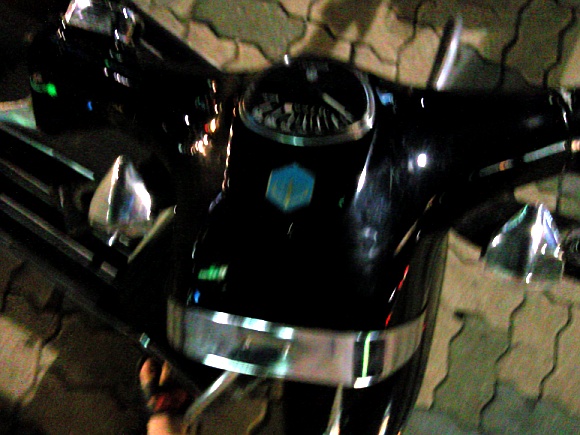

have you ever seen this type of headset?
61 Gs150 vs5 , 55 Acma125, 62 Gs160 mk1, Lambretta TV200
Joined: 15 May 2010
Posts: 113
Location: korea,south
Mon Jun 21, 2010 5:15 am quote
it is VBC, but has square headset.
and headset has not speedmeter same as sprint,
there is vbc (or 125 small) speedmeter on headset
owner said the vespa vbc is from bali.
have you ever seen?
i love square if it is original, i want have one

I think that's one of the DanMotors bikes.... Square headset with the late 60's / 70's speedo...
it was a bike built by SE Asia, FOR SE Asia, IIRC.

it means it is not original, just a crazy asia vespa? or just oem?

It's original to the bike, just not Italian origin.
It was made by a vespa licensee in asia.

look here Vespa Super 'Squarish headlight'

These were made by Piaggio. in Italy.
VBCs with these headset were made in italy and exported to UK, Indonesia, Singapore and Australia. They were not sold in the domestic Italian market and hence also not documented in the vespa tecnica.
Italian domestic market VBCs with the small headset stopped production around 76 and these export only VBCs were made starting from 75 to 79. They are also known as MK2 super. They came with 3 port cases and a 2 port jug. Also, px type crankshaft.

but have different bearing set up... same with older model
