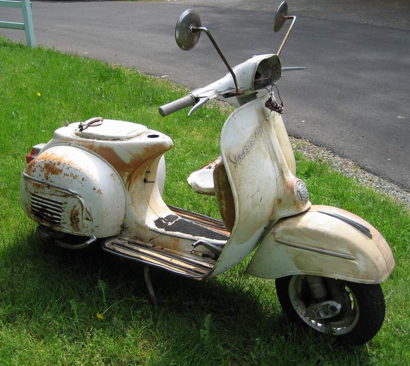

hi all -
so i am going to run a new harness - i mistakingly said before i was switching to 12v -- but as it turns out the harness i got is still 6v but get s rid of battery and has 2 new coils(?) for stator to give good power.
so 1st any good tips on how to proceed?
2nd he told me to wire it like a sprint/super and i have diagrams but i'm not sure where to start ....?
i have a good friend who's helping me along with this who has elec. experience so at least im not totally up sh** creek!!
so any help , links , tips or mumbled wellwishes /prayers happily accepted!!
thx , the Falcon

PS - heres pic to refresh your memory-

To pull a harness you need to have the headset off, and the gas tank out ...
Figure out which end of the new harness goes to the headlight, and feed it up from the hole under the gas tank, through the chassis and up through the headset.
This gets hard right around the area where the brake pedal attaches to the center channel, as there's a reinforcing plate in there that restricts the hole to pass through cables to a little tiny area. I've used a cable inner fed through, and taped to the harness to pull it through....like fishtape.
you want the harness to come up on the side of the column lock - side of the fork.
I actually prefer to re-run old harnesses if they are in good shape ( like i did for my GS / SS ) because they are thin and slip through easily. It's the big harnesses that have been made lately, with tons of electrical tape balls on them and stuff...those are a pain in the ass to pull through.
