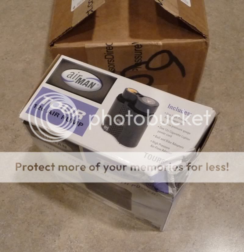

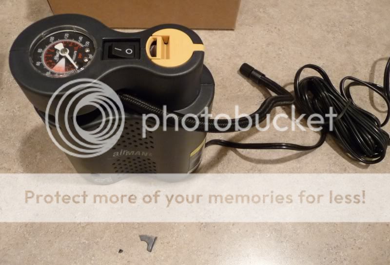

Considering the condition in which the compressor arrived I should have returned it. The shipping box was in fine shape but the product box inside was very smashed on one corner. Opening it up and inspecting it I could see nothing wrong with the pump itself - but I could hear some rattling inside, and clearly something was broken internally. I did not plug it in, deciding instead to just open it up and see what I could I could find - worst case, I damage it further and either return it or keep it and write it off.
What I found were several of the molded plastic bosses on the inside of the case were broken from the impact; the metal parts they held in place moved too much with whatever impact the unit had sustained. I was up to the challenge and proceeded to completely disassemble the unit and repair it with liberal application of epoxy. When I was done the unit worked quite well, and has held up ever since. I like the built in pressure gauge, which has proven to be accurate.

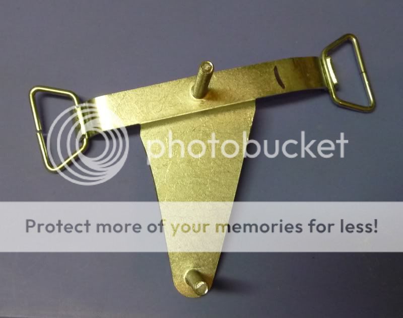

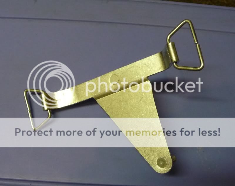

First thing I did was take the original canister mounting bracket and modify it by cutting off the canister holding extensions and grinding the cut metal smooth. I reworked the rubber strap mounting hooks to wrap around the larger size of the compressor, and I cut the D-rings from the canister retaining rubber strap. Using deft hammer and plier skills I banged the hook ends onto the D-rings, making a bracket that would retain the compressor with a strap. This worked out well but a bit odd in function since the original strap was wrapped around the canister at an angle - but it works well with the compressor.

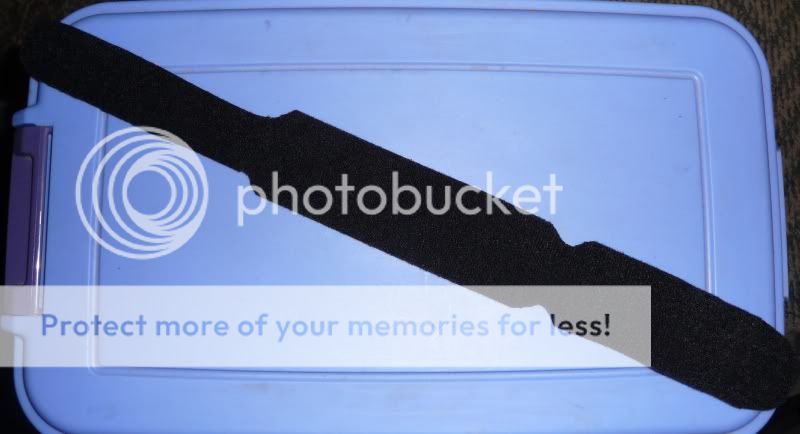

I had bought a length of 2" wide double-sided Velcro from strapworks.com just for this project. I cut it to fit the D-rings and secure the compressor to the bracket when wrapped in place. The Velcro holds securely and is easily removable when needed.

Delivery damage
And the first bits that fell out...
When opened I see plenty of broken bits.
This was all I could find - now to determine where they go!

This is the velcro strap, cut to fit (sorry, kinda dark).

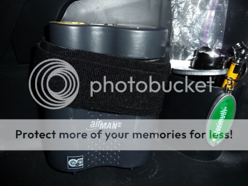

The bracket installed under the seat. Rubber stoppers are evident right below it. With the flash the bracket looks silver!
The air compressor in place.
A closer view of the installation - completed!
