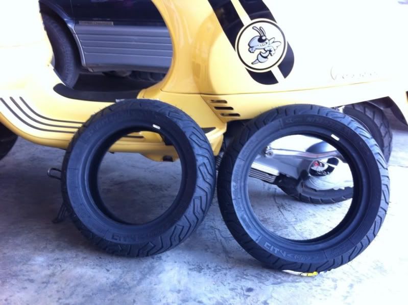

New City Grip 2
After 6200 miles on the original City Grips I replaced the rear with the "2". It claims to have improved traction with the use of contoured treads and longer sipes. The compound now has more silica but still has longer tread life.
https://motorcycle.michelinman.com/motorbike/browse-tyres/by-category/scooter I am 250 pounds and ride hard. Several turns scraping the stand. Smooth roads and very anal on 29 PSI in the rear. The front City Grip is fine for now and Michelin told me there's no problem in mixing CG & CG 2. I'll report back in a few. Ralph |

Thu, 09 Jul 2020 21:43:05 +0000
quote
Well I just bought 2 tires and no one had them. Now everyone has them in stock

Fri, 10 Jul 2020 12:40:26 +0000
quote
Where did you find that? I could not find them in the US yet.
My local scooter shop in ClelevandMoto got it for me. ScooterWest also has them. |
