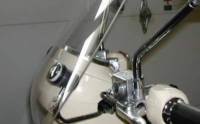

cellingburgh sent me the pic below showing the new shims. Max - are there instructions on how to mount them? With them being tapered, I thought they would mount behind the windscreen between it and the black plastic GTV mounts. I figured the fat part of the tapered shim would be at the top, causing the windscreen to mount at a more upright angle by offsetting the severe angle of the GTV mounts.
Update cellingburgh cleared it up. The hole in the shim is small enough that it can only mount where it is in the photo (on the outside of the screen).

Another update from cellingburgh - he decided to drill out the center hole on the shims and install them on the backside of the windscreen with the thick part of the tapered shim on the top. When I asked if the shims helped with the mount angle, he replied:
They did indeed. Even though the shield move ahead the thickness of the shims the increase of angle has the shield almost touching the speedometer unit and before I could easily pass a cloth between the shield and the speedometer for cleaning. Can't wait to take it for a spin and see the difference.
This is great news!

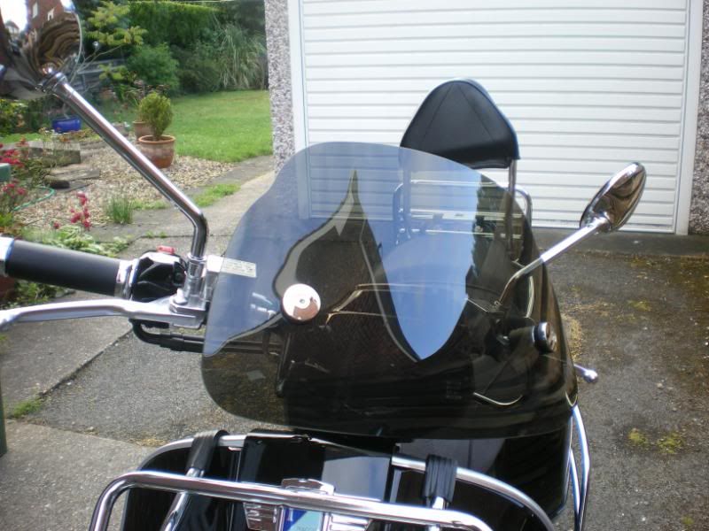

small tinted screen from Motorsport.
