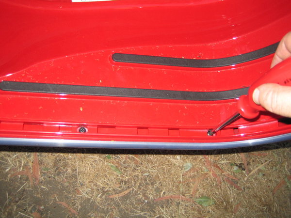

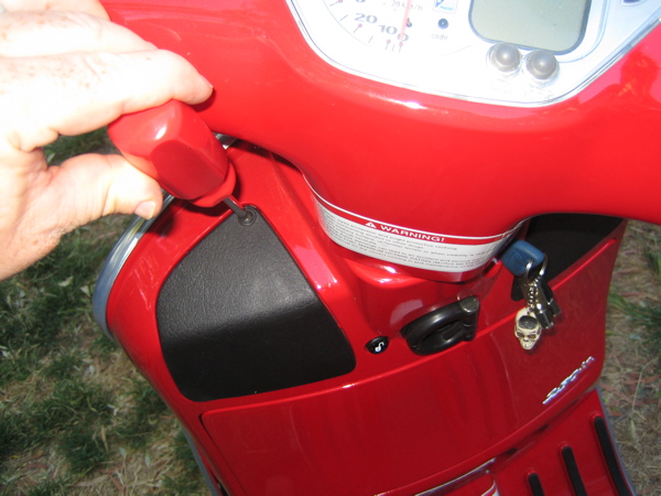

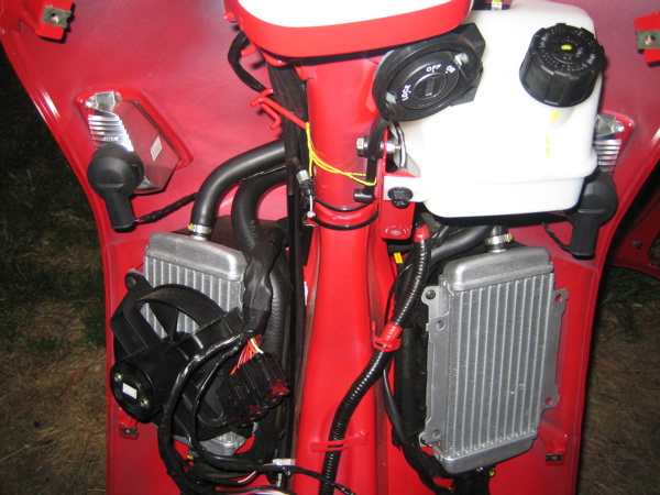

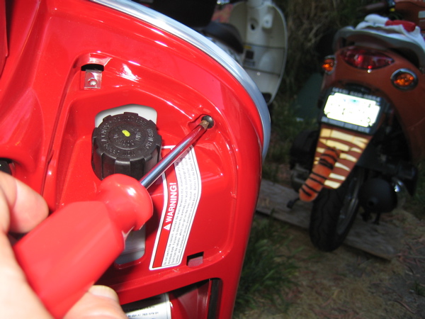

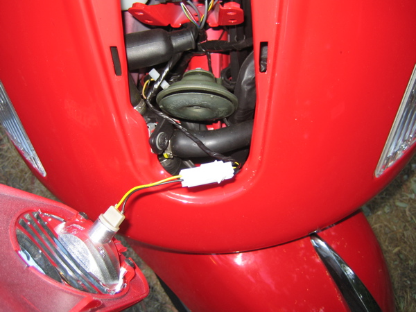

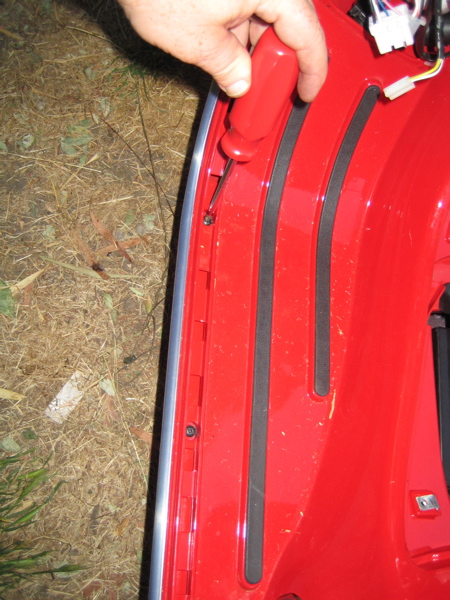

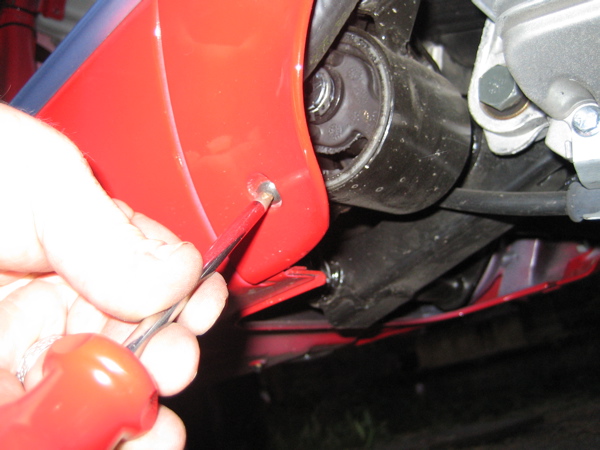

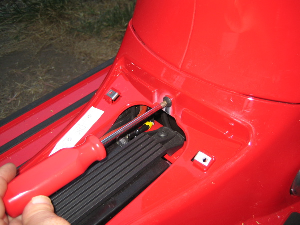

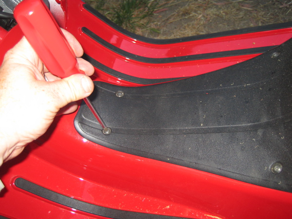

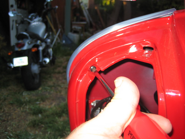

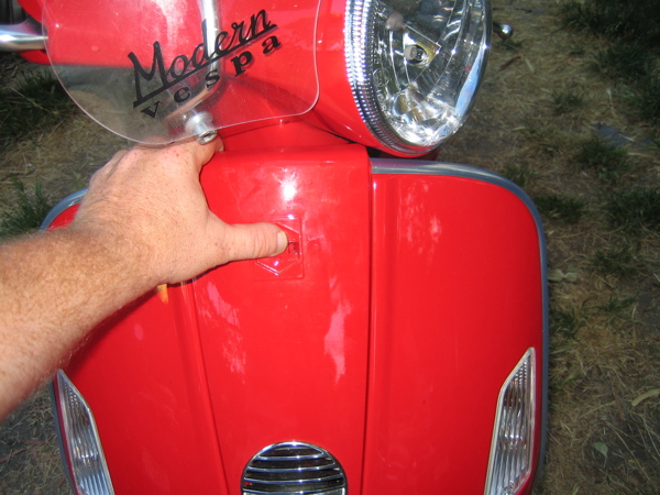

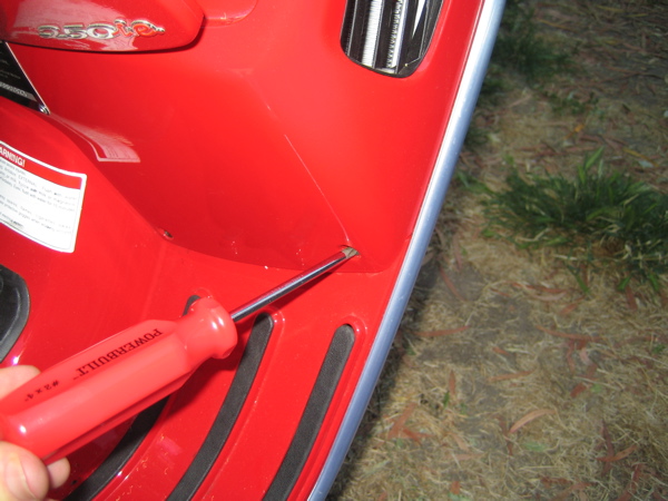

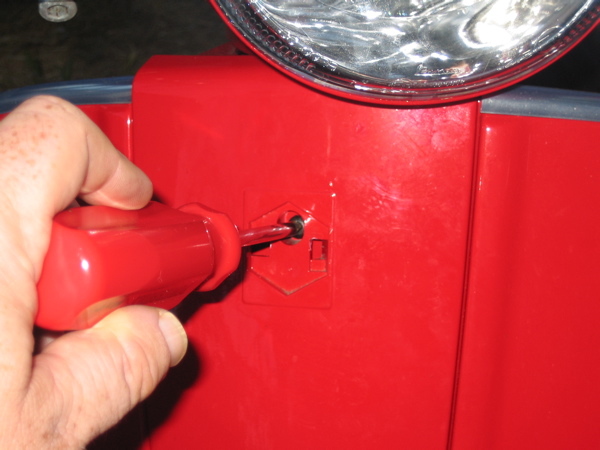

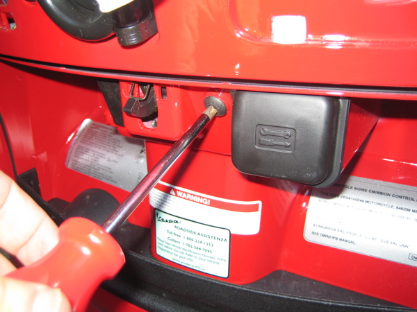

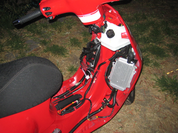

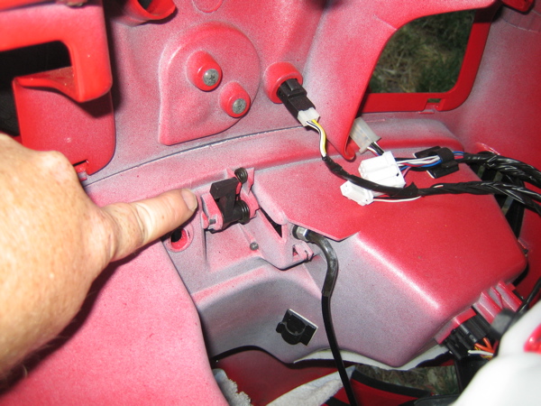

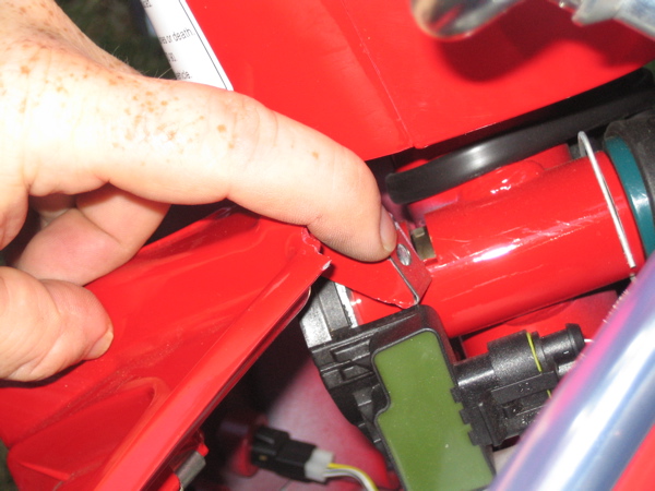

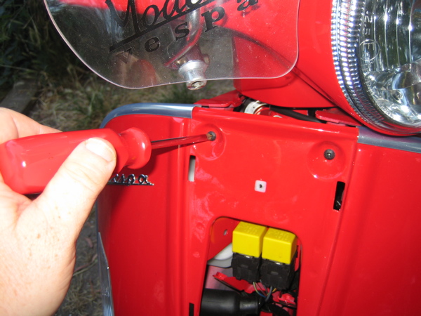

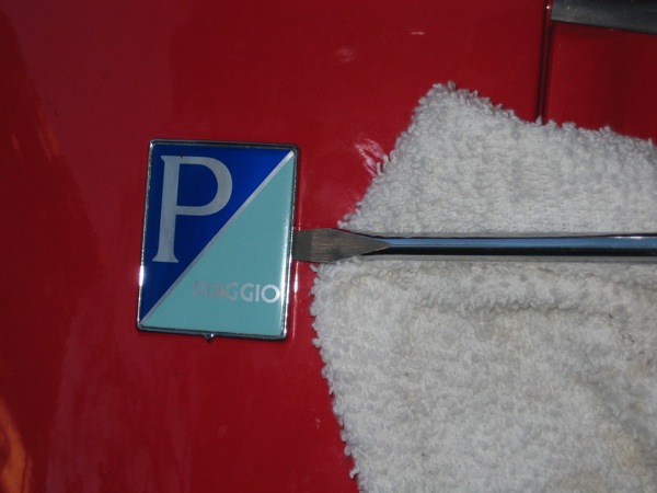

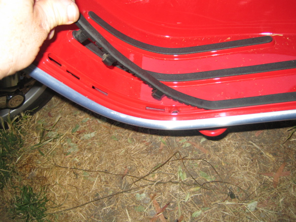

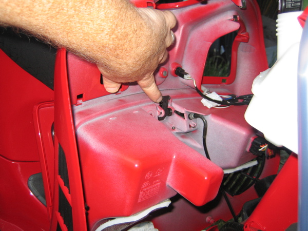

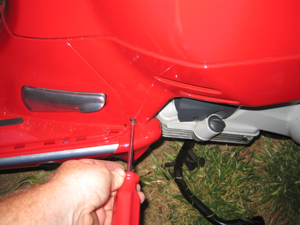

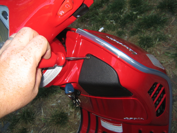

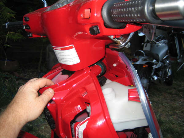

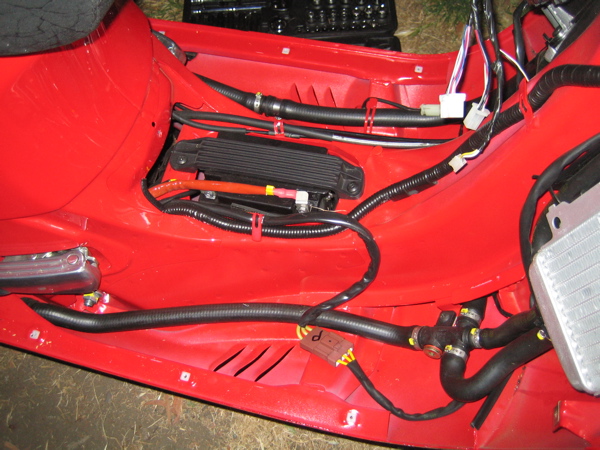

any tech tips or advise on removing the floorboard of a GTS. Any photos? Order of removal of parts?
Posts: 39725
Posts: 39725
I don't have any commentary, but I have a series of pictures showing an overview of most of the steps. Note that these are the high points, and not exhaustive. You may still have to hunt down a screw here and there that's not shown in these photos.

also, take care in reassembling the footboard and glovebox-- the beading is really easy to mess up.

that's great, I don't think I would have found some of those buggers before going crazy.

thanks a million jess. the only commentary missing would have been wresting the plastic back of the leg shield off is a tough exercise in patience only on par with putting it back on. All worked out perfectly and the new trim looks beautiful.
And Greasy, screw gun ruled the day!
