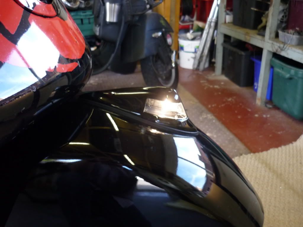

Hi 60yoMod , I did a conversion on my ET4 I used amber led in the turn signals, you could use white, check out my pics
EXTRA BRAKE/TAIL LIGHTS+FRONT RUNNING LIGHTS
It is legal in the UK to show a steady amber or white light to the front
