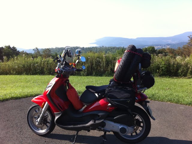

After prepping my scooter for the upcoming Scooter Cannonball Run, it was time to give her a good shakedown ride. The scooter is a 2006 BV250 with a completely stock engine. I recently replaced the belt, oil, and tires (Michelin Gold Standards) in preparation for the Cannonball. The only real modification to the scooter was the addition of a 2.25 gallon auxiliary fuel tank, which feeds directly into the main tank and gives me a cruising range of 200+ miles. Additionally, I was carrying loads of spare parts (including two spare wheels/tires), tools, and luggage using a pair of Nelson Rigg saddle bags and a dry bag in the tunnel. Navigation was provided by a Garmin Zumo 550, using Bluetooth to relay voice prompts.

So, what did I learn on my shakedown ride?
The Good: The scoot ran great; no major mechanical issues to report and I was able to keep a decent top speed even with all the spare parts and luggage I was hauling. Performance definitely suffered at higher elevations (the bike has a carb), but this was expected and didn't cause me any issues. My GPS routing worked fairly well, though there is still room for improvement. The Zumo itself worked great, and using the Bluetooth to get the navigation prompts was fantastic.
The Bad: The biggest issue I had was the plastic kill switch housing not sitting properly (this actually happened before the ride started, when I was adjusting the mirrors). Hopefully I can get it sorted out, but if not, a little duct tape will make sure it stays where it needs to. The RAM mounts were relatively trouble free, but still tended to shift around a bit during extended high speed runs or off road adventures.
The Ugly: While my performance at speed didn't suffer nearly as much as I thought while carrying the spare tires and saddlebags, trying to maneuver the scooter onto its center stand has become a real challenge. Talk about too much junk in your trunk!
The Awesome: Don't let anyone tell you different: West Virginia is awesome. It was a great trip through a scenic state, with some awesome scooting roads and friendly people.
The scooter is heading west via Forward Air on August 30th; after this ride, I'm confident that she'll make a good showing in the Cannonball.

I wholeheartedly applaud you for doing a full-dress shakedown well prior to the start of CB. It's all about preparation and knowing what you and your bike can do.
I am a bit concerned that the spare wheels are going to get tiresome, though. Weight that is placed way high up like that tends to make the bike squirrelly and fatigues the rider. Are you positive you need to carry both of them?

Thanks, Jess. I appreciate your concerns and still have some reservations myself. Unfortunately the BV uses completely different tires/wheels for the front and rear, so its either carry two spares or no spares. (Or I guess I could flip a coin and take my chances with a single spare, but I didn't really consider that). The tire situation was the biggest factor motivating me to do a full shakedown, as I wanted to make sure the bike handled okay and the wheels stayed firmly secured. Based on my experience over the weekend, I am comfortable riding with the tires back there and trust they will be okay for the ride up to Vancouver and home from Portland after the Cannonball.
That being said, you are correct that they are cumbersome and I am considering just throwing them in the support truck during the actual Cannonball, trusting my plug kit/pump to get me to the end of the day.
I normally wouldn't bother carrying spares while touring, but I really want to make sure I make it to the finish line on time and under my own power. And given the remoteness of the route, I felt the benefits of bringing the spares outweighed the negatives.
Any additional thoughts you have would be appreciated. I know several of the GTS's had to get tires changed on the last Cannonball due to running out of tread, but did anyone actually get a flat?

Bummer! That's an unfortunate fact that I was unaware of. Makes sense, though.
If it were me (and it isn't) I would throw those babies in the support truck. I didn't carry wheels with me on the road during CB, but had a full plug kit on the bike and a couple of mounted wheels on the support truck. However, I knew I could count on the support truck being relatively close behind, and made a conscious decision that not carrying an extra wheel was worth potentially sacrificing my time on one leg of the route.
Yep. I hear you. It's a gamble either way.
I'm not aware of anyone getting a flat. We all ran out of tread, except for Oz on a set of Heidenau K61s. I brought a mounted 140 as a replacement for my rear (which I knew I would chew through) and a whole mess of mounted 130s for the team, which could be used on either front or back.
