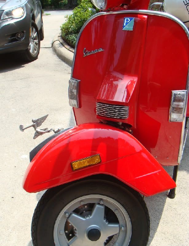

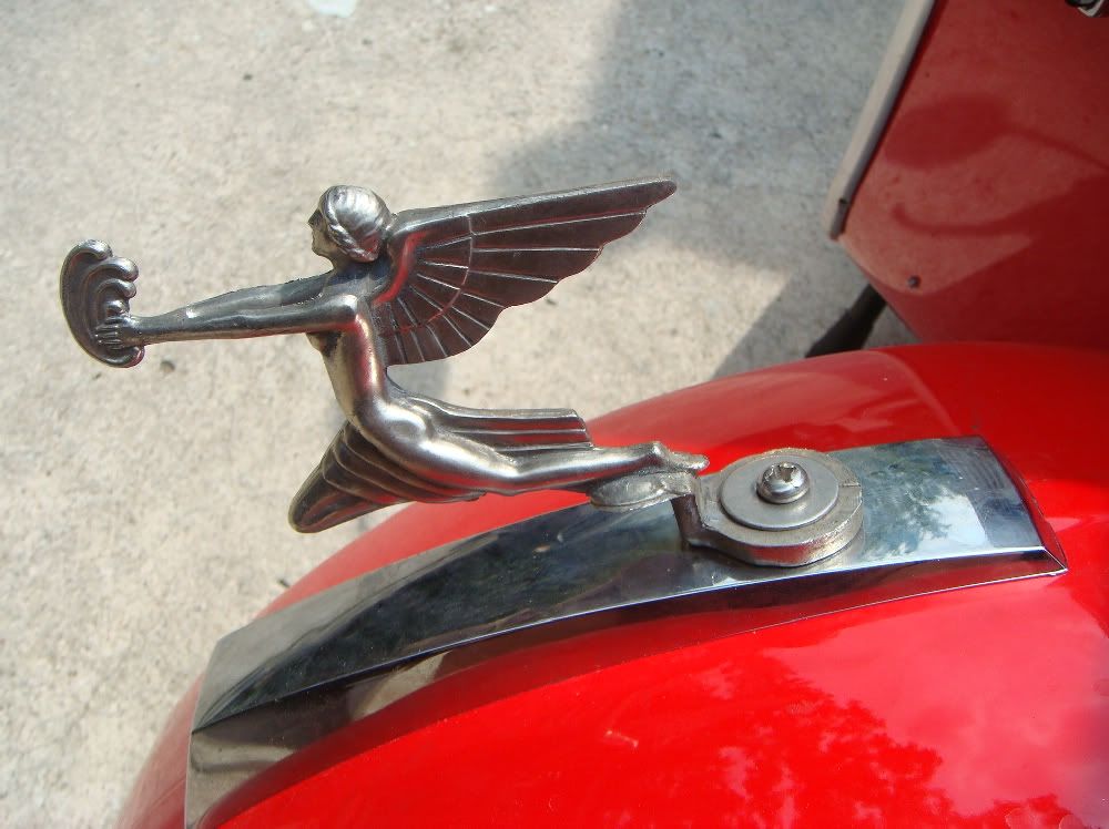

I've had a little search ongoing for a while, looking for the "perfect" old/original art deco radiator cap/hood ornament for a fender crest for my PX. Finally found her a few weeks ago... and I have it bolted on now. But I am looking for suggestions for ways to "lock it on", such that anyone with a screw driver and pliers can't remove it, but so that I can remove it, if necessary.
Any ideas?

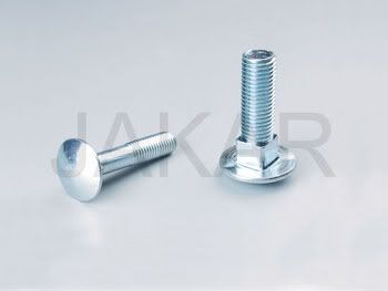

Something like this perhaps?
The rounded head means you can't get it off from the top, the square section holds the thread in on place (you need a square hole for this to work) and the nut goes on the bottom.
Fairly neat and safe, I think...

Is that a plastic fender? If so, all a thief has to do is give it a good kick and the fender will split apart. Then, in the privacy of his own home, he can whittle away on the special fasteners to remove the chunk of your fender still attached.

my goddess mascot...
I had no idea there was such a market for security fasteners! Thank You! Lots of solutions suggested here that would work... I need a few days to research the options available and I'll be back with pics of what I end up doing.

Something along these lines was my original installation intention (under/through the OEM chrome bit, with bolt/fastener hidden inside, but the chorme-thingy that comes on the PX is plastic chrome... cutting into it yields a messy plastic edge. I wonder if there is a metal version of this trim bit available as an after-market PX accessory?
The fender (red part) on a PX is steel, as is the rest of the scooter's frame, the shiny chrome fender trim (OEM stock bit) is unfortunately plastic. The mascot is currently bolted through a hole in the steel fender (with hole drilled through the plastic decorative bit as well)
