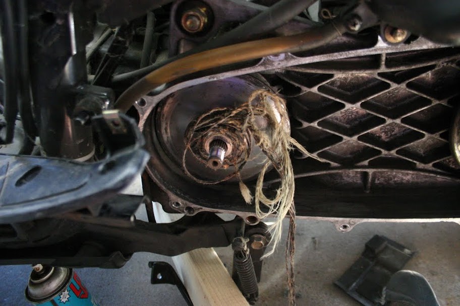

I don't know why I didn't learn the first time, but I tried another third party drive belt for my GT200L. This time it was a Furioso. The belt snapped at 2,500 miles! Below is a picture of the remnants. Luckily it didn't get all wrapped up like last time and was easy to remove. I had my wife bring a belt and my tools out and I changed the belt to an OEM on the side of the highway. Not a fun prospect in 98 degree, high humidity Florida. From now on I am using only OEM and replacing every 8 thousand miles as the service manual recommends. This is my 4th snapped belt. When will I ever learn! Luckily I came out of all these without damage to me or the bike. I in no way endorse this as it could be very dangerous. Here are my stats on the 4 belts I have snapped:
first OEM belt: 11,500 miles.
Malossi belt: 6,000 miles
second OEM belt: 10,000 miles
Furioso belt: 2,500 miles
Be Safe! Don't be like me!

Change your belt or it will look like this:
