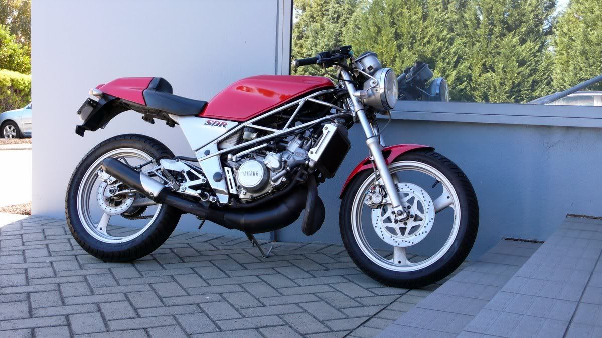

I've had a single tailBlazer from years ago that I've carried across all my bikes where able to, i.e. not dual globes.
Mine was an earlier 10W version, but that was less than a standard brake light and useless, I don't think the product would have survived if they didn't step up to 20W out of the box. I have used a 20W globe in my 10W body for several years without problem, on the same globe. I'm sure they've at least tested it before repackaging it with a 20W bulb. Anyway the conclusion there is a testament to the product.
As far as operation, I highly recommend it. The price is a little steep to start with, especially 2 of them for the Fuoco, but considering it's plug and play for a standard socket, you can move them over to your car, next bikes, other bikes etc. etc. as I've found, so the value far outlives the purchase price. That said I only got one when I scored a cheapy on ebay, I was a poorer student then.
I used to ride social city night rides and I really loved it for those times especially. A rider can be distracted by more urgent obstacles for just a second, and they can miss the transition from tail light to brake light. The change is what gains most attention, so having it repeat was great. I rode behind my bike at a change to try a friend's new bike, and it really achieved what I thought it would.
Especially when leading a ride, it was easy to cover the brake in anticipation of a problem and know you're giving people time to slow down before you might come to an abrupt halt.
Funny timing, I recently just found out from a friend following me on a back streets cafe racers ride that my brake lights weren't coming on at all. At the cafe over coffee I couldn't believe it, tested it and found they don't light until I'm doing an emergency stop. Rear brake light switching properly nice and early.
Currently my tailBlazer is in my road racer, ironically the front brake switch is faulty with that one, and I'm also using the rear brake to trigger the light in the meantime. I have some urgent minor maintenance to "stop" me before heading off on a ride
If you find a good deal on these, I'd be keen to get a couple for the Fuoco so I can leave the other one to go between my other two bikes.
