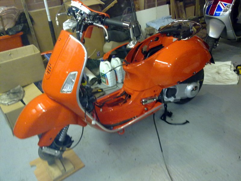

Back to the build. I had been suffering with a bad cold at the end of the week which eventually laid me up all day Saturday, however after a good nights sleep I managed to find enough energy to get back out into the garage today and take a few more steps down the line. Here's the progress I managed to make:
I eventuelly gave up trying to correctly route the speedo cable and brake pipe, so in the end I removed the column, removed the mudguard, fitted the brake cable clamp correctly & refitted the mudguard. Why did I not do this first time around???
Column refitted, torqued up the top race & clamp with my special tool (see LX restoration for details), fitted the handlebars & tightened up the clamp bolt. Instrument panel came next.
If you have help at hand I recommend plugging all the wires into the switches before fitting the assembled panel; I did this on my own so fitted the panel and removed the two upper switches so I could fit the plugs.
GT(S) now starting to look more like a scooter than a pile of clean parts. Unfortunately I can't fit the front wheel yet as I'm teetering on the edge of its balance point.

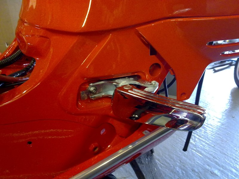

I could not resist fitting the new footpegs any longer. They had to be replaced as the originals were heavily corroded as a result of driving around in Scottish weather for 4 years & it was cheaper to buy new ones than to re-chrome.

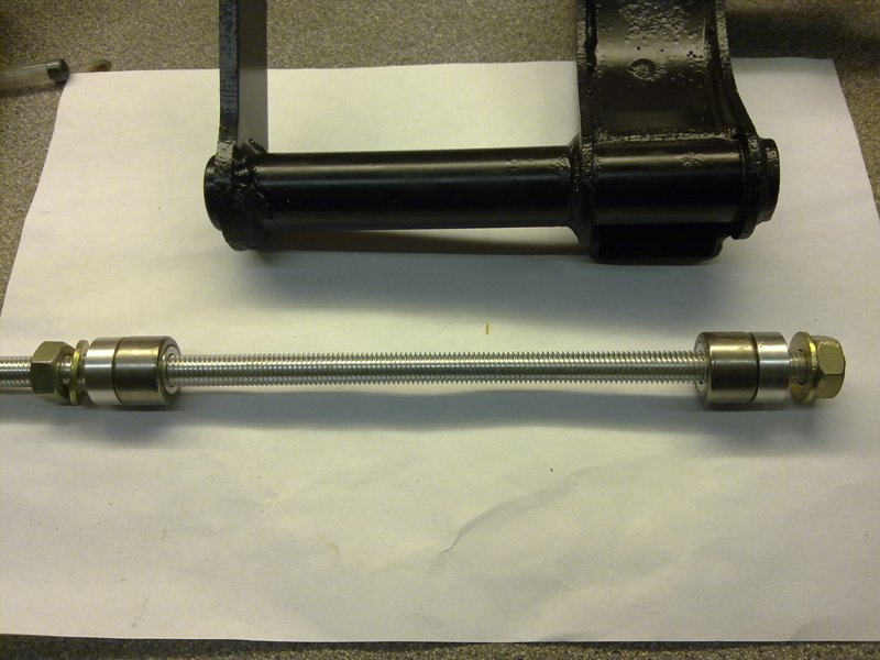

Hurrah!!! The swingarm bushes arrived yesterday so at last there's nothing holding me back from fitting the engine.
Today I managed to put the old Boxford lathe to good use again by making a couple of insertion pins for the bushes. The plan with these is to use them as guides and draw the bearings into the arm by using a length of 10mm studding up the middle of the assembly, thus gently pulling in the bushes without risking damage to the outer housing. I'll take more pictures later to show you what I plan in more detail.
Quick sketch + 20 minutes on lathe = 2 x bush fitting pins.

Update on last night's efforts:
These are the new swingarm bushes. The photo is not quite sharp enough to show that there is a seal at one end only. The seals go to the outsides.
Assembly of draw tool, bearings & tube plastered in grease to aid assembly (always good to lube things before insertion).
One nut in vice, the other tightened with a spanner. Be careful when putting your nuts in a vice....
Bearing fully home, note that the mandrell finished up inside the tube to allow space for a flanged nylon bush which takes any side loads.
Nylon bush & centre shaft in place, swingarm finally ready to assemble.
.... and easily fitted into the frame.

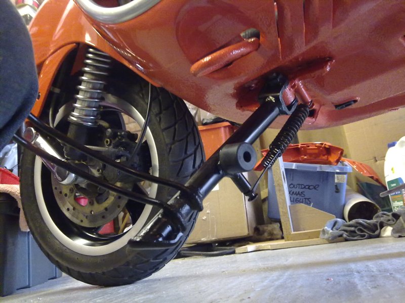

End of play last night: front wheel stand from LX project in use again, body lowered down onto trusty tool box & the engine on the floor ready to be lifted in.

So, with the wife away in Spain until next monday, there is nobody stopping me from visiting the garage after my supper & burning a few more midnight hours:
Bit of a fiddle, but lifting the engine into position was not too much of a drama.
Getting the bolt through the engine mount was a whole different ballgame with only one pair of hands.....
But well worth it when the wheel went on and I stepped back to admire it on the bike for the first time.
Carefully fitted the bearing carrier to avoid scratching the paint, loads of grease on the axle to help with the installation and help to prevent future corrosion.
Now it is off the saw-horse it looks very low...
I could not resist trial fitting the brand new exhaust to see what it looks like out of the box. Half price Ebay bargain on account of a little damage to the tailpipe - but I'll be fitting a stainless one in any case.
Engine electrics connected, hoses cleaned & connected, filled up with coolant, throttle cable connected.... should be ready to fire up on Saturday if all goes to plan.

To finally celebrate a leak free bike I lay on the floor and fitted the side stand. Pack the shaft with clear grease on assembly.

Footpegs had to be removed to next fit the footboard. So far so good.
... so footpegs had to then be refitted.
