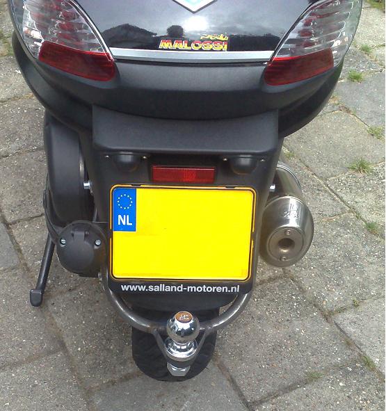

when i install the hitch, i will make some pic's but is a simpel hitch construction connected to the upper shockmounts
i have to make a apointment yet to pick it up
this  is how the hitch bracket looks like the red centre bracket hooks  on the licensesplateholder

The hitch only has three points of mount? two upper shocks, and plate bracket?
@maksor avatar
Gilera Fuoco 500ie
Posts: 4563
Location: Netherlands Olst
@maksor avatar
Gilera Fuoco 500ie
Posts: 4563
yes and its RDW and TUF (german) a proofed

no they are a littlebit different the Fuoco / 500 type hookes on the licenses plate holder the 250/400 type will be a bit smaller and will have another centre bracket

1 yes this one does not tilt the hook on the trailer can turn left and right and upside down so both wheels stay on the ground
2 yes i did have a test drive with a littlebit of load in the trailer a 20 kg you won't feel the trailer is behind it
if you load the trailer you have to put the heavy stuff near the axle thats all

here are more pics how the hitch works
this winter the hitch will be powderrcoated black  its still bare metal

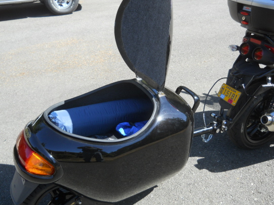

the inside

jimc wrote:
I've been on about this before, so won't go into too much here in this topic - but if you want to use a trailer for transporting more than just a sleeping bag and a few bits, for goodness sake get a two-wheeled trailer that's good for 150kg carrying weight while only giving a few pounds tow-hitch weight.
Good grief Jim, even in my wildest dreams would I ever need to drag along 330 lbs of stuff, regardless of trailer size or number of wheels. (150KG = 330LB) Where do you come up with these figures? I loaded all my normal camping gear in the UniGo and although it's only 3/4th full I have everything I'd need for extended camping. Maybe I should unload the stuff and post a photo of it?
I documented the handling in my Red Dog Scooter blog and FYI the only thing I noticed was a very slight front end wobble - not continuous, just occasionally. It turned out to be due to low pressure in the rear tire and it went away after I pumped it up to the recommended level. The trailer tracks fine and the MP3 handles like it wasn't there; I ride at speeds in the mid 60's when towing, same as when I'm towing behind a truck or RV.
Your many comments regarding weight on the tow-hitch might enter the picture if one overloaded a UniGo to 330LBS but certainly not for ordinary loads. I stopped at our local truck scale the other day and the MP3 500 with me on board and the UniGo fully loaded with camping gear registered 900LBS. I wasn't carrying any food as I normally buy groceries as I travel along. The top box was empty which is where I'd carry my extra clothing but that wouldn't weigh much. I'm fully confident the additonal weight for either of these items would amount to anything substantial.
Seriously Jim, I hate to challenge your expertise as you've forgotten more about scooters than I'll ever know but I seem to recall you've never towed a one-wheel trailer with an MP3 500, correct? That might make a difference if you were to take a test ride. Or perhaps not... Wha? emoticon
