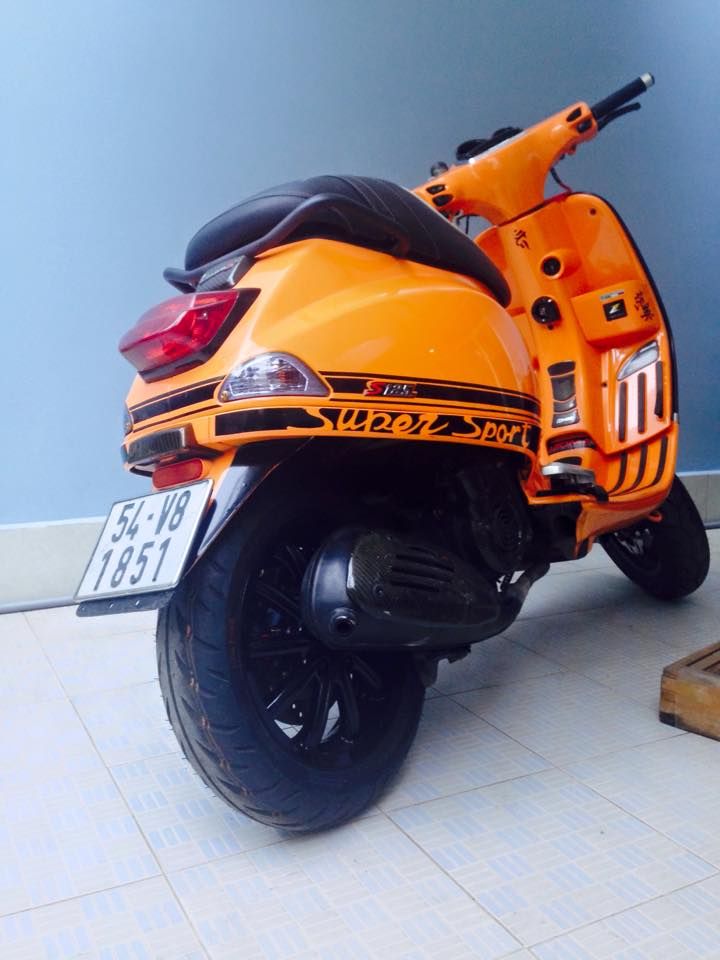

I just done my Vespa S followed by your guide
I got pair of Mp3 wheel for mine ^^ It's look quite high at the back, im thinking to change other lower tire. Any advice?

Excellent work bluecloud. Forums are all about sharing ideas.
Your Project S is being featured in the BikeBuilds.net
directory here: bluecloud's Vespa Project S
We're currently displaying only a reduced-size photo (similar to what you'd find in Google
Images). We'd like to ask for your permission to publish the original full-size image with your
build listing.
If anyone would like to have a build of their own listed, just shoot me a PM with a link to
the build thread and we'll take care of the rest. If you wish to add your build personally,
please feel free to peruse our Submit feature. No registrations required.

Major update. Finished the paintwork except PPO plastic front fender needs plastic welding to fill the holes. Proof that very professional looking results are do-able with spray cans. Also recent additions MP3 wheels and wavy rotors.

Sweetest scoot I have seen in a while. What warranted a re- paint? Was not it orange before?

Just the plastics. De-chromed head and tail light bezels, shaved horncast and mirror and marker holes, and modded rear fender.
