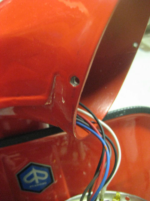

the 2 headset screws that hold the light assembly have striped the holes. how can i fix this? i tried a thread tap last year but now those have striped as well.
drill new holes?

Oh boy. I guess you could tap up to the next size and figure out some new hardware.
Is it the setup with the little brass screw holding on the bezel, and the steel holding the headlight in those little guide rails?

no. its just a screw.
i have tapped the threads for one side already, but now both are whacked.

O man, I missed this...
Looking at your pic and I'm pretty sure I am seeing a euro Rally???
A simple insert coil job fixes these in a jiffy. I have done several, right on the scoot and 5min. each side... Don't go bigger!!! there is very little room between the hole and the front edge of the headset.
