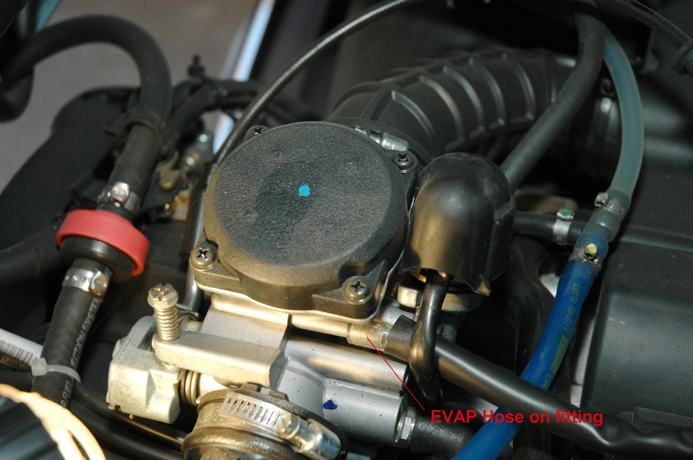

The solution is to remove the evaporation hose from the carburetor inlet where it is normally attached, either permanently or long enough to drain the accumulated liquid gasoline. The hose is on the front left side of the carbeurator, near the top, as illustrated by the following two images:
External inline image provided by member with no explanatory text External inline image provided by member with no explanatory text
[Click Images For Larger Size]
If you intend to leave the hose disconnected permanently, it would be prudent to affix a small foam filter to the hose inlet on the carbeurator to prevent dust or debris from entering through this hole. Under no circumstances should you completely block the inlet on the carbeurator. Another possible solution would be to leave the evaporation hose connected to the carbeurator but to fit a hose-T inline to the evaporation hose, again with a small foam filter on the end of the T to allow air to pass into the hose.
