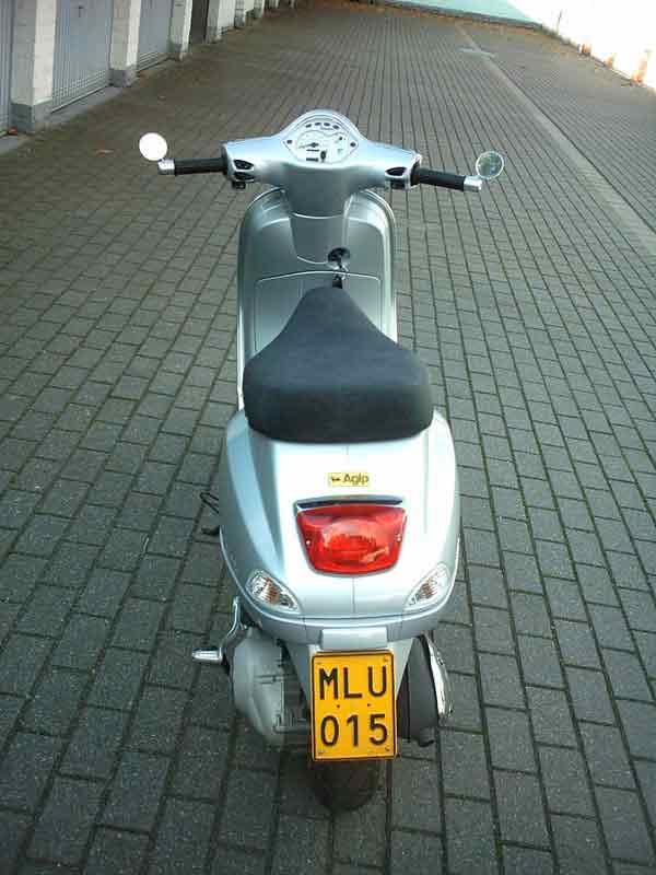

Hello,
I´m triyng to make my vespa look like the older ones, and after seeing some like the vespa sprint 125, I want to take out the hand-bar for the passenger
I just wanted to know how it´s done, and if you can , please post pictures.

Open seat
Remove pet carrier
Remove battery cover and fuel lid
Slide fuse box from side of cover
Remove phillps screws holding down black cover
Remove two bolts holding hand rail
Remove plastic cover where rail mounts above tail light
Remove bolt holding rail
Remove rail
Reinstall covers
I don't think you can reattach the cover over the tail light, but it has been a whil since I had it off. You might need to use some fillers.

E voilà:
B.T.W.: Is your rear rack painted?
Send me a piccy and put it on my blog...

Thank you very much!!!!
Now I just need to find something to put on the bolt holes above the tail light, since I don´t know if I wan´t to do this definetley
