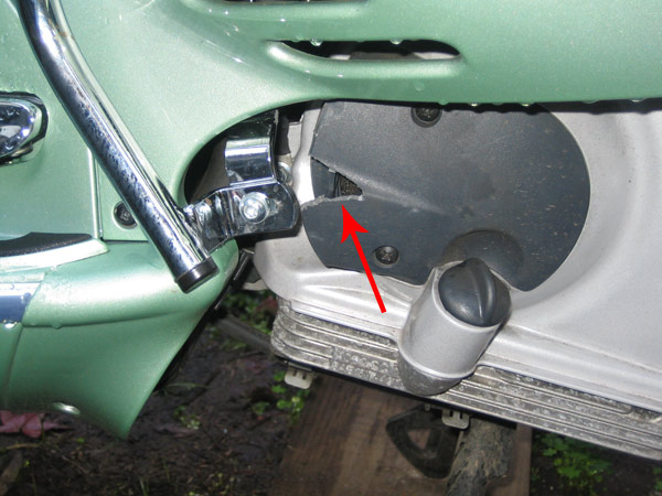

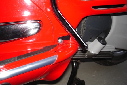

My partner's GT200 has had the Piaggio rear crash guards installed since January 2007. However, we haven't really been able to ride much because of weather until recently. Today he noticed that when he went over even relatively minor bumps that he was hearing quite a loud noise. Once back home he looked his scooter over and noticed that the brackets for the left side rear crash guard was eating into a black plastic intake cover of some type (sorry I don't know the name/term for it) in front of the oil dip stick.
Has anyone else had this problem from the installation of this rear crash guard on their GT? The crash guard is solid as a rock and not rattling at all.
What do you think we need to do to stop the noise and the damage? Do you think we need to be worried about the other side where there is a hose near the bracket there. So far there isn't any sign of contact with the hose on the right. Any ideas would be appreciated, thanks in advance.

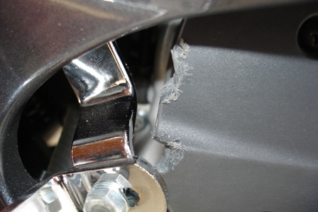

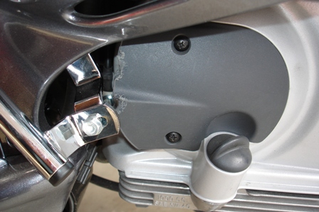

Close up of the damage to the plastic intake cover
Another shot so it is more obvious what this part is.

Sadly, this is common. I hesitate to say "normal", because Piaggio-branded stuff shouldn't break your Vespa, but it does. It happened to me on my GT200: It's Not A Rally Till Something Falls Off Your Bike
I've heard that the latest version of the Piaggio bars have been redesigned so that this doesn't happen anymore.
Posts: 39740
Posts: 39740
BTW, If you flip that bolt around, the head will probably clear the air horn. You might also need to use a lower-profile button-head cap screw, as seen in my picture (facing the wrong direction).

I have the same crashbars installed on my GTS - I have a love bite on the same plastic part too. Not worried about it, will take a dremel to it some day to make it look better.

So it sounds like we should change the nut and bolt to something smoother, shorter and flatter. Also I guess we would need to remove the Air Intake thingy and dremel it smooth. I wonder if the rear crash guard I have on order will be the same as my partners. We just got his in Jan07 and I would have thought that it would be the new design already. I might need to do the same thing for my GTS if I want to avoid this damage.
Posts: 39740
Posts: 39740
I think the redesign might only be for the GTS, now that I think about it. The new design mounts the forward end of the crash bar through the screw hole in the body-colored plastic fascia that's just in front of that air inlet.

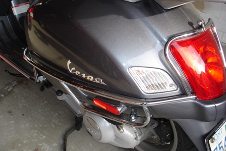

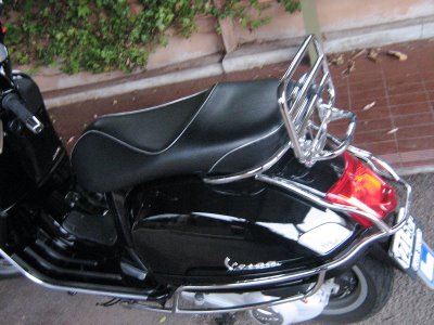

I've got a new one and it screws in underneath, with a brace bar that runs under the scooter. It also sits a little further away from the cowls.
Photo is blurry. I'm a crap photog.
Oh okay that is the new one. My dealer actually already has those in his shop. Perhaps I need to look at those ones as well. I kinda like the ones that wrap around the brake light though, but I guess that one avoids damage to the scooter. Have you had any issues with it since installation?
Your scooter looks awesome by the way, love the seat.
The crash bars look great - they sit wide so you can feel them with your calves occasionally when you stop at the lights, but not in a disturbing way!
And thanks for the compliment. I am quite in love with the seat myself. Inspired by our beloved Scoots, I spoke with upholsterer about piping or not and he came up with the most excellent concept of chrome piping. Isn't it gorgeous!!!!!

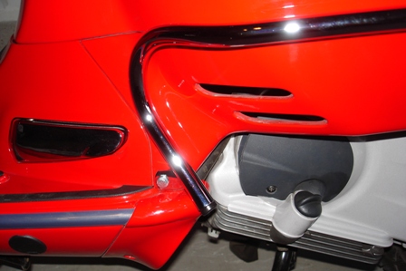

As a follow up to this thread I started a while back, I got the Piaggio rear crash bars for my GTS installed today. The mount at the front of the bars is completely different than what is still being shipped for the GT. The front of the bars do not mount from underneath the cowls at all therefore there is not risk of damage to the air intake or the tubes. I can post a photo if anyone is interested.
Posts: 39740
Posts: 39740
Yes, please!

Here are a couple of shots of the mounting of the front of the crash bars.

Absolutely not, thank god. The plastic trim has to be removed and then a bracket is installed with the plastic trim being replaced. Then basically a spacer then the bar. So it screws in thru the plastic trim utilizing the existing hole in the trim.
