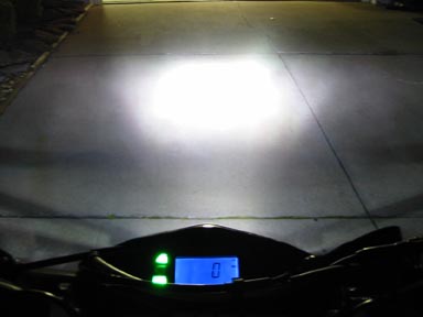

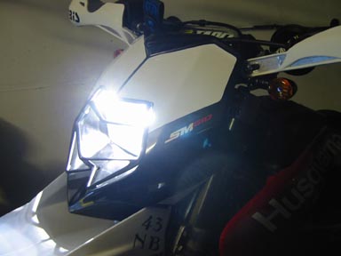

i have HID's on my supermoto. it's worth every penny especially for night riding. i have the bi-xenon too and it works like a charm.

here's a shot of the lowbeam against my driveway...

IS heat not a problem with the HID?
