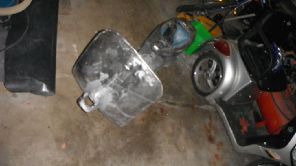

Hi all. This is a 1970 Sprint body that's being resprayed at the shop next to my house. Overall it doesn't seem to be in such bad shape, and the shop says they see no need to do any welding, so I take that as good news.
However, it appears to have been welded in the past.
Since I have no experience with welding and very little idea how to assess structural integrity, anybody with some expertise willing to weigh in? Does it look dangerous to you?
Also, I drove this bike pretty much daily for about a year and a half, and it always seemed pretty sound. And my girlfriend is the one who dinged up the legshield. She hit a curb while learning to drive it in a parking lot and finally got it through her head that the clutch lever does not make you stop. Heh.
Finally, it looks like they didn't blast the insides of the cowls. This is probably less than good, yes?
Thanks in advance for the advice!

i dunno who weld ur bike before but it seem u cannot avoid bondo to hide the weld in ur center floor if i were you i will reweld it in a nicer condition and ur floorboard, it had 2 bones but from pics it appear someone allready change it in past (normally aftermarket floorboard have 3 bones but ur is 2 so i pressume whoever change it have similar mind with me )
other then that the frame look strong
have a nice day and cheer mate

Hi Ebeth!
Because the body shop deals mostly with cars, if the welds look strong to the folks on the board, I'll probably just let the shop use a little bondo to hide the welds. Since they're not scooter people, I don't know if I'd trust them to do a better job of welding.
So those welds that show on the bottom of the floor make you think that someone changed the floor out at one point, but that they used the floor from another scooter rather than buy an aftermarket floor? That would make sense.
Thanks for the input, and have a great day in Jakarta, mas bro!

i am still confuse wheter its the original floor nor a replacement, if the body shop were for cars i will trust them to do the weld nor atleast grid it till it achive the best result, but best not to use bondo at all in ur floorboard as it will crack due time and stress cause the centerstand (unless u shorten ur centerstand like mine ) a car body work can perform a nice metal work with dolly hammer, thisngs that miss out by almost all vespa resto shop i ever found ask them to reshape the cowl and the legshield alongside the fender, its a easy job if they have dolly hammer.. i learn most of the hitting to bring back the shape from a car body shop and not scooter shop
be a very annoying customer and ask for the best result mate, remember u paid them to do their best so teach them to be the best for u
have a nice day in Jogja and cheer mate

Okay, Ebeth, now I'm going to ask you for a bahasa Indonesia lesson.
I know they're going to reshape the legshield/fender/cowl using a hammer (and a dolly, I assume), because when I was there today and asked kalau ini perlu dilas lagi, masnya bilang "Tidak, tinggal menukul saja," and made a hammering motion. Also not sure what actual word he said, but menukul (verb: hammer, thanks Google Translate) seems close, if I remember correctly.
Also, when I first took it in, I said, "Kalau bisa, minta jangan pakai tembul." Is "tembul" (or something close) the word for bondo/filler? I've never seen it written, but it's the word my friend at the bengkel Vespa used when I was talking to him, so I tried to learn that one and use it at the body shop. I think they knew what I meant.
Finally, if I wanted to ask them to weld and grind the center of the floor to make it smooth, would it be "Minta di las dan menggiling bagian lantai ini sampai jadi halus" ?
Thanks again, man. You're incredibly helpful!

pukul, memukul = hitting, hammering
dempul = bondo
gerinda = grinder
ok another tips, if u ask them to hammer down the floorboard where the weld took action i will ask them to make a jig first like this one
that way when they hit the center board the frame wont twist
told them this
" tolong ini body tengah di sobek lagi las-annya dan di perhalus sisa lasnya dengan gerinda, dan saya tidak ingin ada dempul jadi tolong semua bagian yang tidak lurus diketok magic sampai kembali ke bentuk sempurna mulai dari body tengah sampai spakbor dan boks kiri kanannya, dan jangan lupa tolong tuangkan pelingkot ke bagian didalam body mulai dari bawah tangki hingga ke bagian bawah tulang tengah dan juga dari bagian fork atas dan semua bagian kolong "
in english
" would u please, tear down the previous weld and reweld it again and this time try to smoothing the final touch of the weld by grind it smooth and i dont want any bondo took part in this resto so please hit and hammer down all the dent back to the origin shape starting from the frame, front fender until both cowl, and also dont forget to pour a anti rust (u choose from por-19, till undercoating rubberzoid) ke the inside of the frame start from unter the gas tank till the inside of the spine and also from the inside legshield where the fork enter also all the rest of the underneat section"
most car shop can weld like this
this way its easy to grind and not too mess up too much
and if u found there a joint that weak u can shoot a new one with a brass.. which is stronger then metal weld
and one more advice, dont u dare tell my resto secret tips that i just told you to the other Indo boys out there i mean it mate, they (most Indonesia vespa rider) hate my cheapo way so let them do their way and stay away from my method
good luck with the sprint and cheer Jesse

Well, informasi itu sangat lengkap! Terima kasih! Besok aku ke bengkel lagi, dan aku membawa laptop, biar mereka lihat post ini!
And don't worry, your restoration secrets are safe with me!
Cheers, and thanks again!

JJC,
will you please repost all of those photos in the Bodgespotting thread?

Tue, 08 May 2012 14:37:46 +0000 quote
and beside vespa there's one thing i do best for a friend and that is cooking
Aw, man, Ebeth, now you're really making want to visit Jakarta! I could certainly go for some masakan Batawi!
JSharp:
I feel reticent to put it over in the Bodgespotting thread because the body repairs, while not pretty by any means, don't seem to be unsafe, nor were they made with the sole intention of export for sale (I bought this from a guy who runs a local shop that doesn't do exports, and I sincerely doubt he's the one who had it welded, though I'll ask him).
We'll let some other people weigh in, but in this case, Southeast Asian ≠ bodge, methinks, though, like I said in the original post, I know fuck all about welding, so if someone wants to explain to me why I'm wrong, I do like to learn stuff!
And, that said, if someone who knows about welding weighs in and says they would never ride this bike because they're afraid it'll tear in half, then I fully support moving it over to Bodgespotting with the explanation of why it's there.
Finally, I'm not taking umbrage, by any means. I bought this bike for about $380, and I had the paint stripped off partially because I wanted to see if there was anything unsafe about it. But until I'm convinced that there is, I won't give it the "bodge" label. And if someone convinces me it is a bodge, I think I'll probably spend the money to have it fixed properly, if that's possible.
But for now I'm still (shamelessly) fishing for input!

With respect JJC mate, a bodge by any other name still looks like a bodge.
I think most people here would agree that one of the things that defines a bodge is welding, especially bad welding and alot of it (which that bike has), I don't think you can use the excuse that it wasn't for export so it's not a bodge, whether a bike is exported or not does not define it as a bodge.

I've, as of late, began to diverge from the classical British definition of "bodge." Up until recently, the bodge has always meant a temporary of imperfect fix/repair typically completed by someone who is lazy or lacks the competence of a technician.
But now I use the definition: Any repair carried out in an effort to deceive or defraud. Of course, such repair/fix is usually because of the person's laziness and/or incompetence. The noun version would be the thing that was being sold.
Such definitions aren't geographically specific.

Looks like it was extensively repaired in the face of extensive southeast asian moisture rot, to me. Not franken-biked together. I don't personally care much about what term is applied to this instance, but I think it was done to legitimately keep this bike on the road and in service, not defraud someone.

Edit: By the way, this frame is the one in my avatar, if anyone's interested.
AKP:
With respect JJC mate, a bodge by any other name still looks like a bodge....one of the things that defines a bodge is welding, especially bad welding and alot of it (which that bike has)
Agreed that it looks like a bodge. But since the big problem with bad bodge welding is that the bikes are unsafe to ride, that's what I'm really interested in, whether or not the frame is safe to ride.
SFvsr:
I think this definition applies.
This one definitely does not. I quite agree with xantufrog:
But that leaves open the question of whether or not the bike is roadworthy, and the answer to that question, I think, will be what determines whether or not it should go in the Bodgespotting thread as a cautionary example, or whether it's a decent frame that has some ugly but functional welds.
All I can say in its defense (again, I know very, very little about welding in general and even less about welding these frames), is that my girl ran it into a curb going about 5 mph, and I dumped it a couple of times at comparable speeds (slipped in mud and tipped over while making a U-turn kind of shit), but none of that broke it in half.
And say whatever you want about the bike, please. I'm not going to get angry about it or defend it unreasonably (probably--heh). It's not my baby or anything. I'm just trying to garner some opinions from folks who know what they're talking about when it comes to welding, because I totally don't.
Bottom line: If it's unsafe: Bodgespotting thread, and I'll get it fixed by a professional (if fixing is possible) or find a new frame. If it's safe: I'll have the cosmetics worked on per Ebeth's advice and rock it with confidence and pride.

if you are worried about the strength of the frame and aren't worried about keeping it original.
then a bar welded between the seat and headstock , with or without a small motorcycle tank will make the frame virtually unbreakable..

Your bike doesn't look dangerous... But it is a mess.......get all the rust sanded. Or it will return.......reinforce by welding...the rear shock mount....carefully measure the steering neck to. Motor pivot holes distances.......i ncert a long stiff metal rod in the motor pivot holes. Equal lengths on both sides and measure to the steering neck...If one side is longer... Then put a prybar in the neck while yourfatfriend sits on the bike...and start yanking....the Asians do good welding...but they think a jig is an irish dance....they weld the leg shield, and it warps the steering tube....
Koenig seems to have lots of good advice...and experience...go with it

I have experience welding but not on these bikes with the thin gauge steel. I had a rotten section of my floorboard cut out and repaired at my buddys muffler shop and noticed if your heat is too high you can ripple the gauge.
Honestly the only person on here that "I" know that has history with these types of repair is Ebeth(koenigblues). He's done this alot on some of his personal bikes and quite good at all repairs.

I did the same thing
My bike was exactly like yours...but now I ride it every day on long rides around town .I love it alot...my frame looked like yours.

Right. I do live in Indonesia, and I'm having the work done here. However, I intend to send this bike home to the States (ill-advised or no, I don't care; can't afford one there, and already have some money in here; all-told it'll be about $1,000, including the new paint and body work, by the time it gets home), so I'm not trying to misrepresent anything. Thanks, Jess, for the moderation.
Also, I intend to use this bike in the States (assuming it won't or can be made to not kill me by snapping in half). I certainly do not intend to ship it in order to turn a profit.
Gnasher:
I don't think I want to go quite that drastic. I don't care about "original" necessarily, but I'm not trying to ride some weird largeframe SS90 mock-up. The original lines are pretty important to me, but if it needs drastic body work that's not original and doesn't show, I'm happy to own the fact that it's not stock.
tailgate:
Sound advice. Will do.
Also, the following sounds like VERY sound advice:
.reinforce by welding...the rear shock mount....carefully measure the steering neck to. Motor pivot holes distances.......i ncert a long stiff metal rod in the motor pivot holes. Equal lengths on both sides and measure to the steering neck...If one side is longer... Then put a prybar in the neck while yourfatfriend sits on the bike...and star yanking....the Asians do good welding...but they think a jig is an irish dance....they weld and it warps the steering tube
Man, my bahasa Indonesia is not terrible (though it's far from great), but I'm way out of my depth here. Not my everyday vocabulary. Koenig! Minta bantuan, ya, mas?
Typewritist:
Asian/unscrupulous seller bodge: welding two frames together at weak stress points
This gets right directly back to my main concern. Is this what has been done here? It doesn't seem to me to be the case, but I'll state yet again that I don't know quite enough about welding these frames to be sure.
That's why I'm hoping Professor Plum will chime in. I trust him on all welding issues on these old bikes.
Replacing a piece in the monocoque frame could make it even stronger than before, that's the beauty of these frames, but done wrong it can make it weaker. That central tunnel is integral to the strength of the frame as opposed to, say, a lambretta that has a tube frame with parts hung off it.

So, are we talking refabricating the actual center of the frame, or is there some way to insert a tubular piece of metal that wouldn't be visible? Like I said, stock isn't important to me, but keeping the original lines of the bike is, 'cause what's a Vespa without that beautiful shape?

These bikes were only spot welded in the Italian factory.....Here is blurry foto... But... I carefully bent some metal rod...bout' the thickness of a pinky finger ...and laid it,inside,on the inner panel seams...then welded the fuck out of it!...mega stability...where no one can see..grind all rust away!!!!.u can not weld rust! And you can not paint rust! Where u weld must be. 100 percent rust free!!!use a grinder...u will get dirty!
⚠️ Last edited by tailgate on Tue, 08 May 2012 21:01:35 +0000; edited 1 time
Man, me included [no one can see]!
Do you mean you ran metal tube inside the center of the frame, where the cables run? Also, I'm not even sure the frame in question needs that kind of help, but if it's possible and it wouldn't hurt, well...

Tue, 08 May 2012 21:09:14 +0000 quote
Also, for anyone who might lend some expertise, this weld is the one that's making me the most nervous (maybe wrongly; like I said, eager to learn stuff):
The big triangular patch in the center of the floor is (I think) the one Ebeth (Koenig) was encouraging me to have smoothed out. But this one seems like it would have the most impact on structural integrity.
Thoughts?
