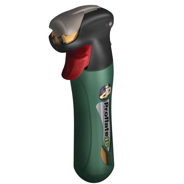

I keep one of these under the seat in my tool kit, works great.
http://www.motorcycle-superstore.com/item.aspx?style=19436&department=674&Division=6
Now if there was one with nitrogen.....
