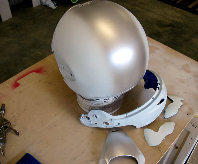

Now that I have a shiny new Dragon Red GTS, I noticed that my old electric blue Nolan helmet just doesn't look right anymore, so I decided to give it a new paint job. Since the lining is removable, I removed it to save masking it out and also to give it a much needed wash. I then saw that some of the black plastic parts were bolted on to the shell, so I started unscrewing them until, before I knew it, my helmet lay in pieces in front of me! Almost every part of the helmet either unscrews or unsnaps and the design and workmanship in the hinging mechanism is most impressive. I only hope that I can remember how to put it all back together once it's painted! What color? Red, of course, with some sort of trim, which I haven't decided on yet, but probably a checkered stripe again, because I'll no doubt want to do something like that on the scooter eventually. Now to get busy sanding!

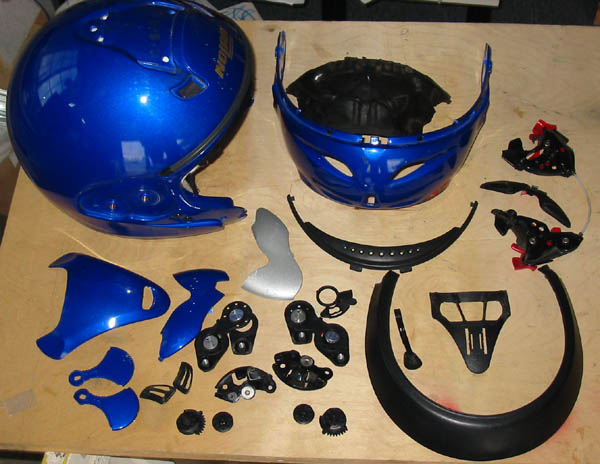

This is what a stripped down Nolan N100 looks like!

Holy shmoly! That's a lot of parts. Good luck putting it back together.
Be very careful sanding, I'd only scuff the finish. These things are designed with their protection/weight trade off mighty fine and any material loss on the shell during surface prep will compromise the impact resistance!!!

Thanks, guys, for the replies and the concern. I appreciate your advice, all of it good. Fortunately, I have painted a few helmets in the distant past and so I have taken care not to sand too much and I'm using water-based Creative Auto-Air paint which is quite safe on the Lexan shell. So far, I have sprayed on a white base coat, followed by a silver swatch down the center where the checkered panel will eventually go. Tomorrow I will mask this out and spray the rest red and then take it from there. This is how it looks now:

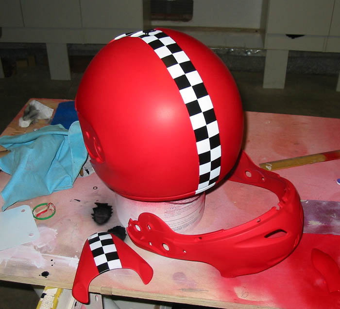

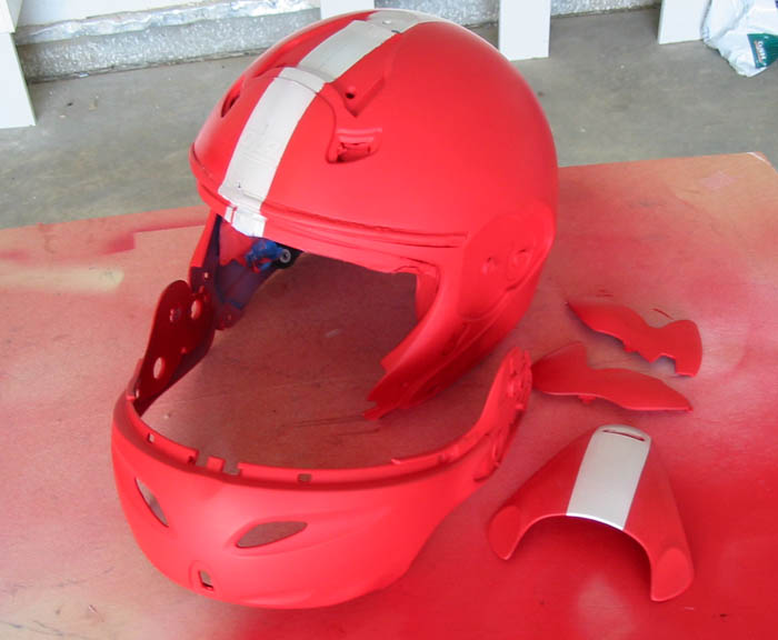

Here's an update on my helmet facelift. Once I had the red done, I decided to have white, rather than silver for part of the checkers, so I repainted the stripe down the middle. When that dried I masked out the area and proceeded in much the same way as I did for the checkers on my GT. (See earlier thread). After a light sanding, the helmet was ready for the final clearcoat. A local auto paint dealer had just what I was looking for - clear polyurethane in a spray can. At $18, it wasn't cheap, but a lot cheaper than buying the stuff in a pint can, which would also require the necessary thinners. I don't usually like using spray cans, but this really worked well and I was pleased with the result.
Now everthing is drying and I'm patiently waiting before carrying out the last step - putting it all back together!

The red is done. It looks dull now, but a clearcoat will fix that!
Checkers painted
Checkers painted

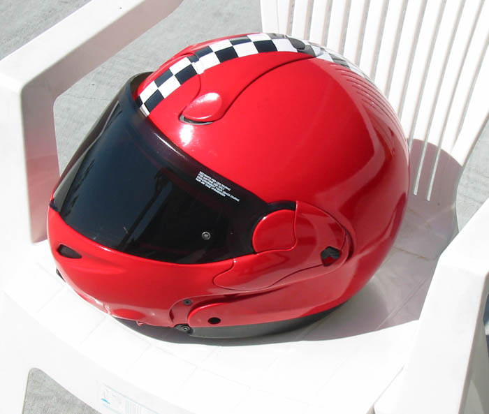

Thanks guys, I actually got it back together without too much difficulty, which surprised me!
Here it is:
All done!
All done!
