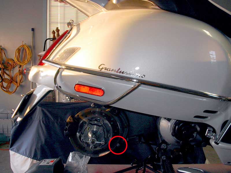

Just recently I got new tires, and I had the scoot up on the workbench for a couple of days while waiting to get my tires mounted. My friend Matt Gordon recommended that I change the hub oil while it was so accessible. Even though this pic is dark, you can see how easy the access is with the tire off. The plug for the hub oil is just forward of the rear axle. It's less than a 5 minute job while the rear wheel is off.

Yep it is VERY easy to change when the rear wheel is off.
I lightened the pic and circled what I remember to be the hub oil drain bolt.

Yep, that's it, thanks for making that photo more useful. Thanks Matt for the tip, too!
